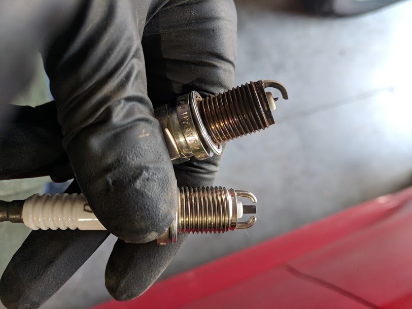

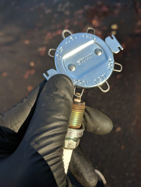

    Thanks! Got them all out in this afternoon. Fingers crossed they won’t leak on me and I have to take the whole thing out again :fingerscrossed:

    They're the OEM Denso K16TR11, dual ground strap, that Toyota calls for. I think they're plain-jane copper electrode. I assume the dual ground strap is meant to prolong life since the 5VZ-FE is a wasted spark engine. Don't know if you actually need dual ground strap for your 4 banger.
