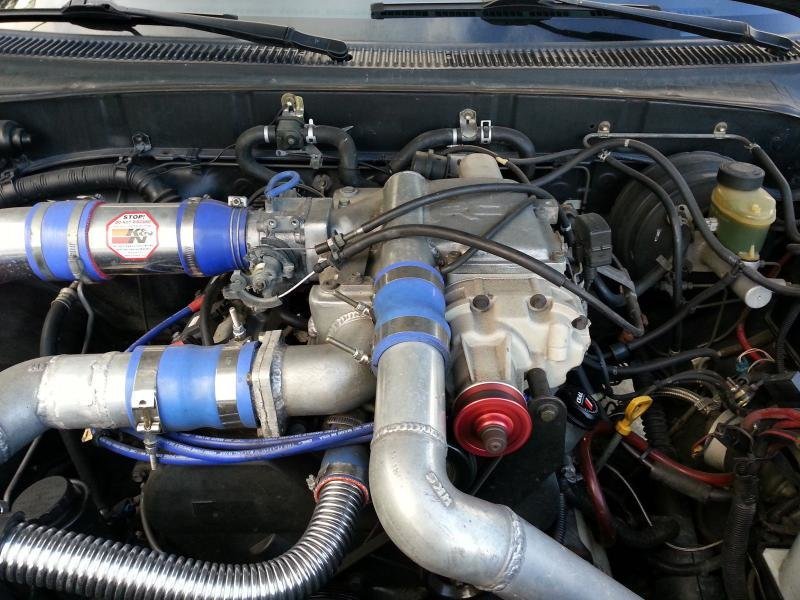

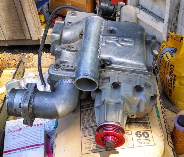

    A dude made an aftercooler for a gen1 S/C, gotta search for it right now- google is kicking my ass but being a two piece he sliced stuff up, used tranny coolers and made it like a gen2 TRD setup. Easy? No. EAF, yes.

    Damn 15k? Dude had money to blow. And the whippe has been done. I think 1320 Performace make one but it wasn’t pretty and ended up being parted out. The motor was built as well. Bored to 3.8 I think.

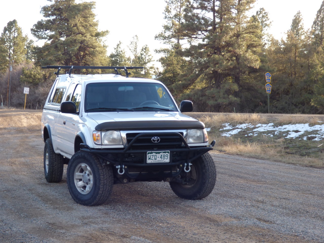

    Finally got my All Pro Baja bumper mounted up. Now just gotta paint and mount the IFS skid and order some lights. Thanks again @Findus11!
