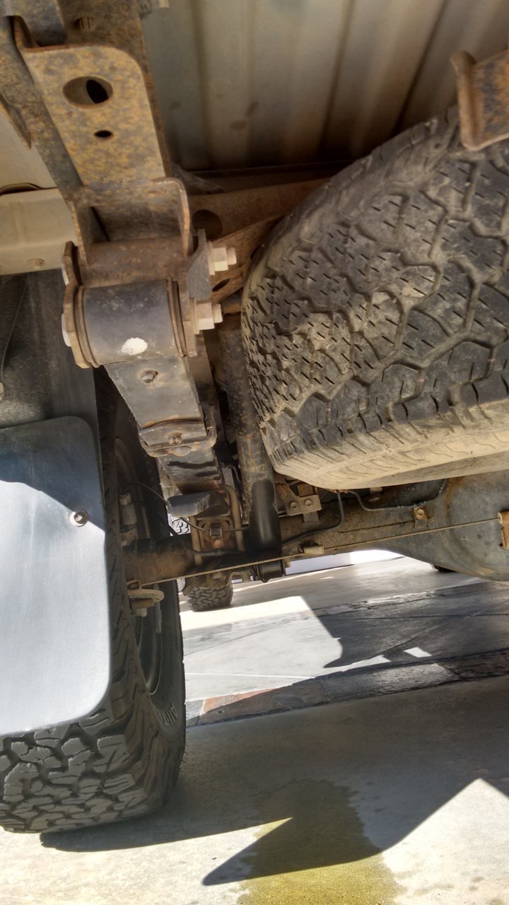

    Stock shock finally kicked the bucket after 180,000 miles. Icons on the way :D

    Luckily it was what @Blackdawg said and just the small 10mm bolt at the bottom that was lose

    Common to LT builds.
    Awesome.
    Mine comes loose more often than Id like..
    Sperrunner[QUOTED] likes this.

    I honestly never noticed that bolt till yesterday. But yeah that good to know it’s something simple.
