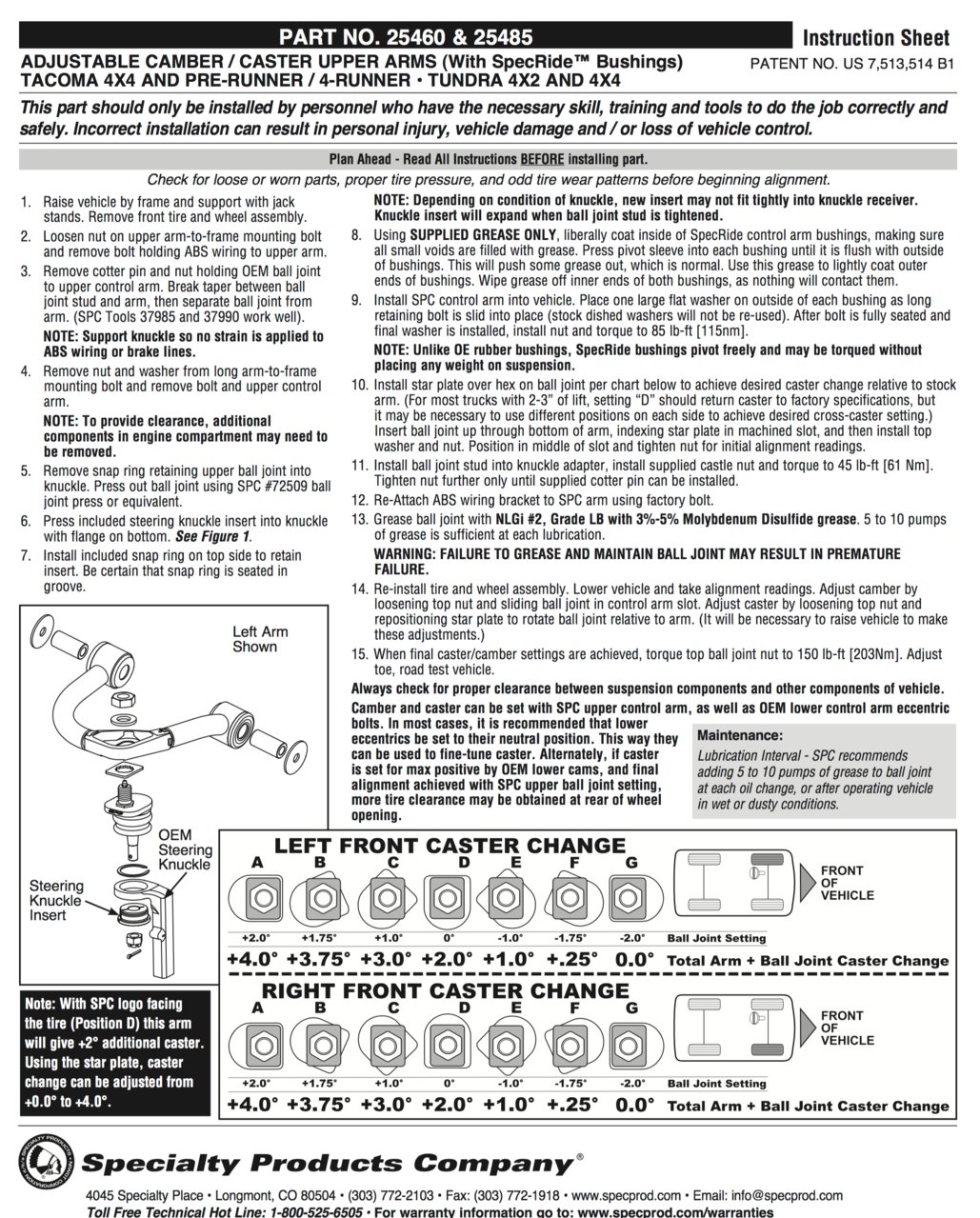

    super easy...double check this is the right part number, I just did a quick google search

    No clue what I set it to, to be perfectly honest with you. I just know it had some bad negative camber.

    So check and set it for the caster total you want and very little to no camber and the regular alignment will take care of the rest

    To be fair I’m not saying do your alignment yourself...I’m saying adjust your spc uppers yourself. Then pay someone $60-$80 to align it. From my understanding it’s easy to adjust the uppers
