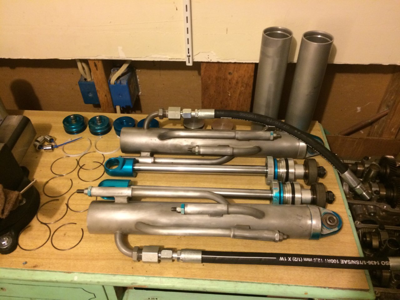

    Shock seal kits here are basically $20 per shock. You can get uniballs for $15 each if they are bad enough to need replacing as well. I don't know what brand shocks you were referring to, but they have rebuild kits for all of the major brands.
    http://shockseals.com/king.htm
    Shafts are $60 a piece from King - ask for close up pics or video of them fully extended. They require soft jaws to hold them in a vise and a cheap torch to heat up the rod ends enough to melt the loctite that hold them on.
    https://www.filthymotorsports.com/ProductDetails.asp?ProductCode=KING-SHAFT
    https://www.kartek.com/parts/kartek...x-or-sway-a-way-58-34-or-78-shock-shafts.html
    New hoses can be purchased at any hydraulics shop. I got 2 new ones for $50.
    This video shows mostly how to take them apart.
    The only special tool needed are the spanner wrench and the soft jaws that are only required if you have to get new shafts or rod ends.
    https://www.amazon.com/gp/aw/d/B001DNWVH8?psc=1&ref=yo_pop_mb_pd_title
    New oil is like $40 for enough for roughly 4 oem size shocks.
    https://www.amazon.com/King-Shock-T...+shock+oil&dpPl=1&dpID=31HHIc6NC-L&ref=plSrch
    Springs are usually reusable but could use a fresh powered coating or sand blast and painting if you live in a rust belt state.
    Here's a pair of bypasses I'm rebuilding
