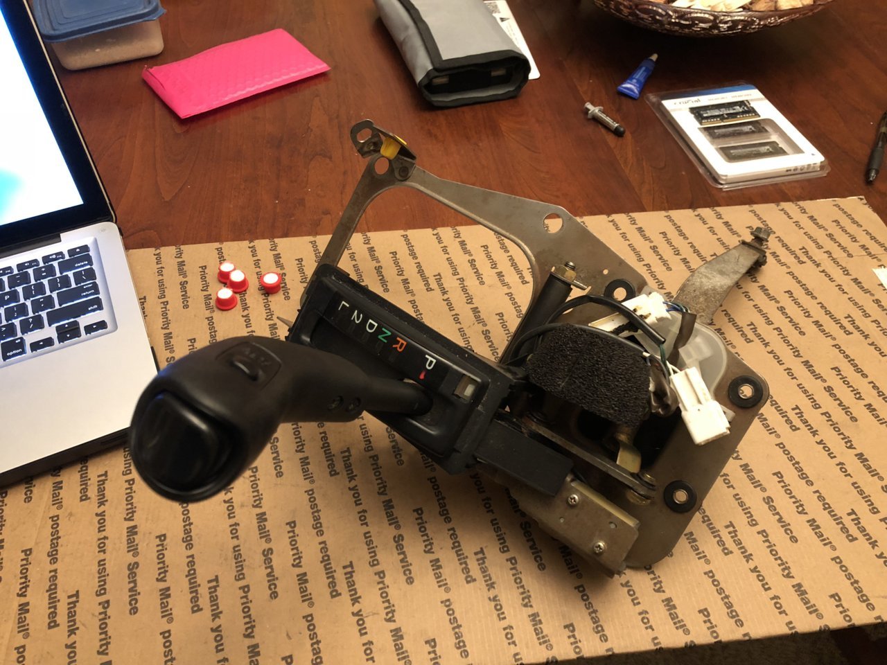

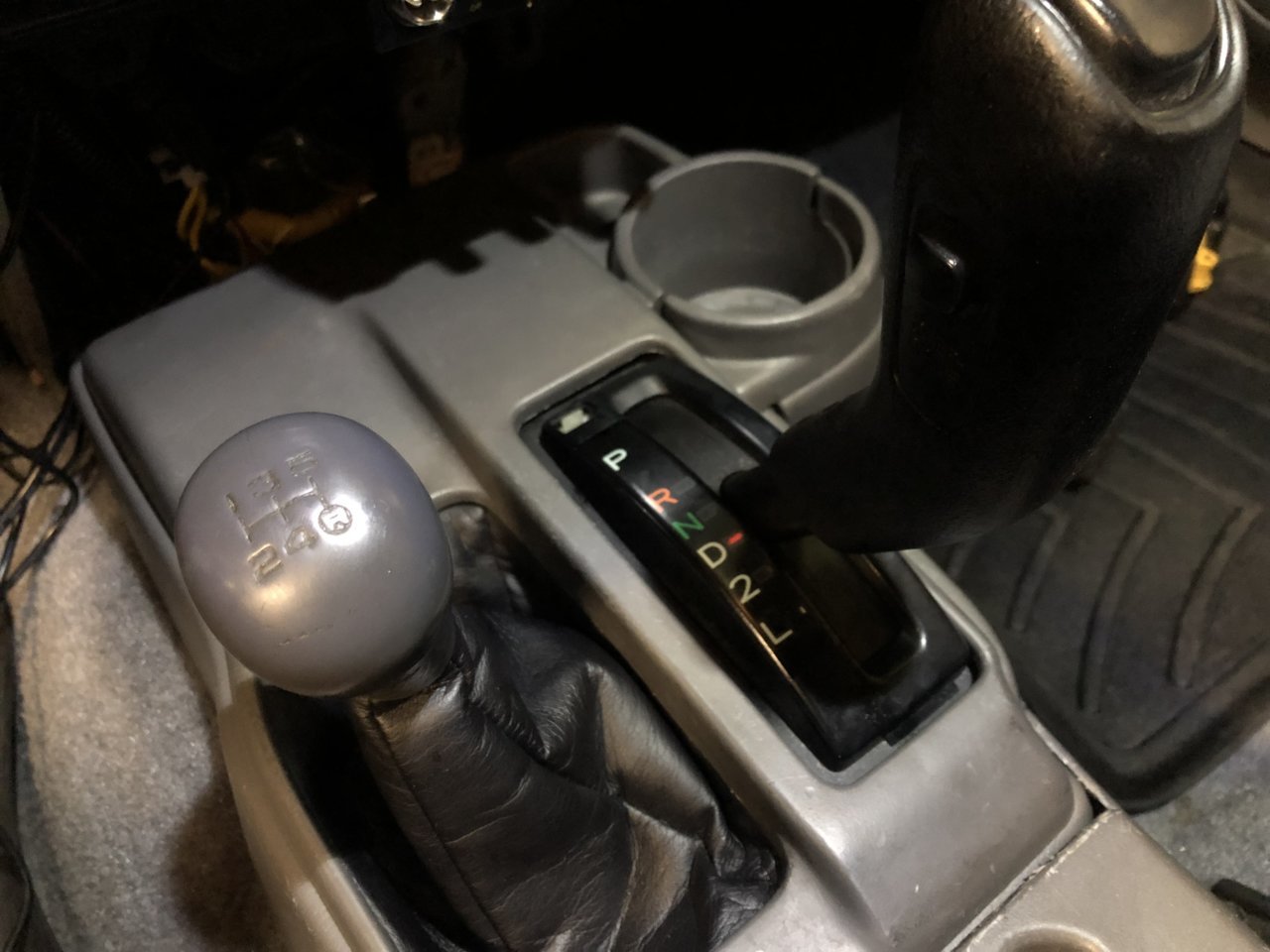

    I replaced the automatic shifter bushings in my truck today with these great 3D Printed PLA bushings from @Brice.
    When I did my 4x4 conversion, I used a shifter console out of a 1996 4Runner with about 300,000 miles. Unbeknownst to me, the bushings were absolutely shot. For almost a year, the truck would pop out of gear, and indicate you’re in Neutral when you’re really in Drive. Usually I’d have to rev the engine to test if I was really in Drive versus Neutral. In general, there was just so much slop in shifter.

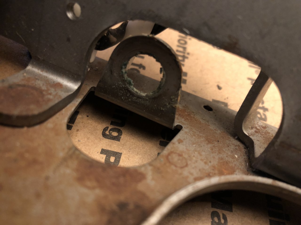

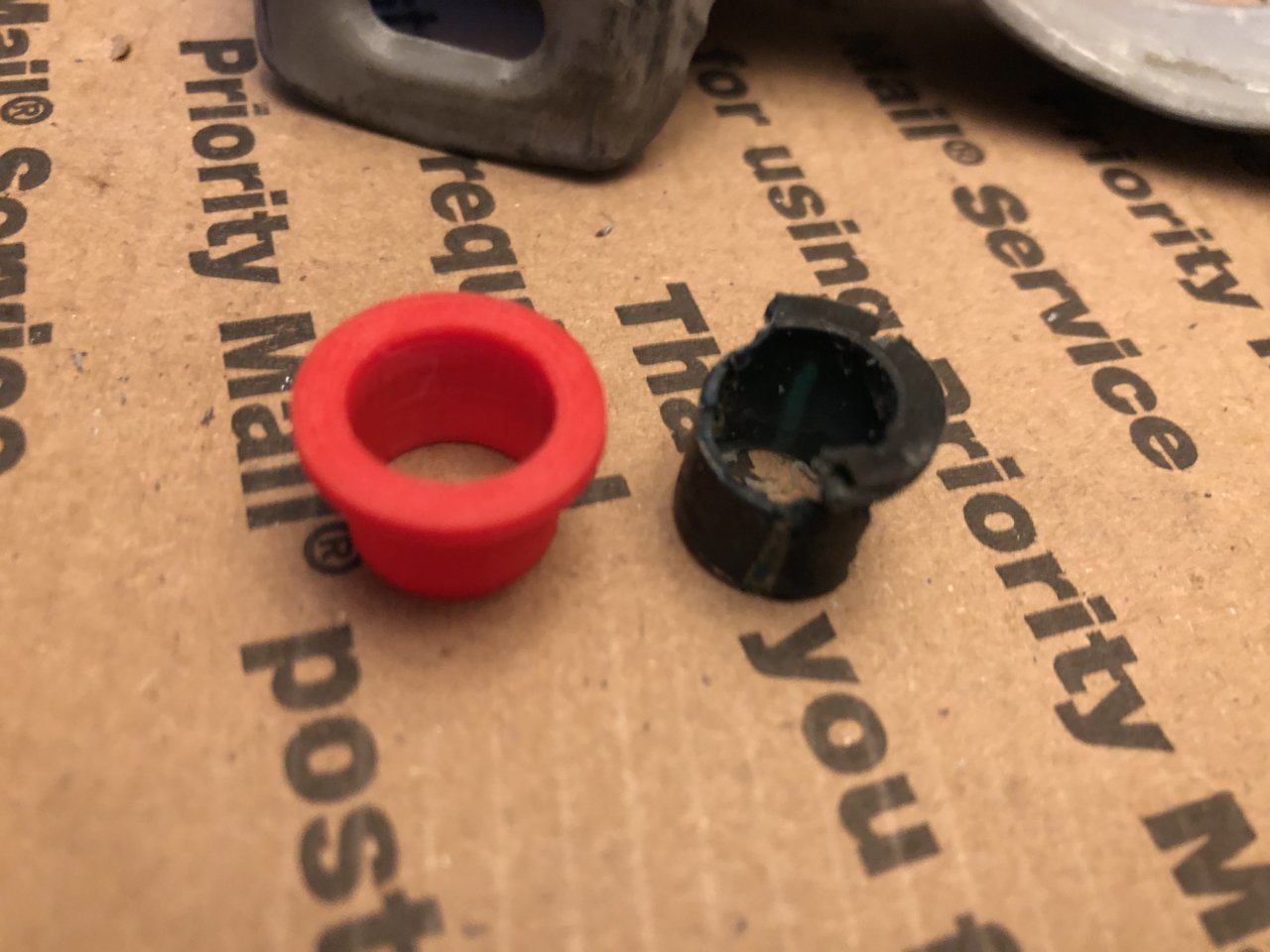

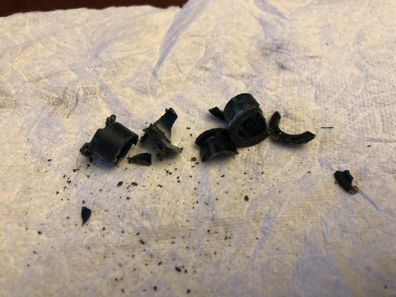

    Found out it was the long disintegrated bushings at fault. Upon removing the shifter from the truck and cleaning out the lateral shafts from the mechanism, this is all that was left of the factory bushings. They crumbled when I tried to take them out.
    The main lateral shaft under the shifter was completely missing a Bushing on one side. The remains were nowhere to be found, all that was evident that a Bushing once existed was this chalky blue residue.

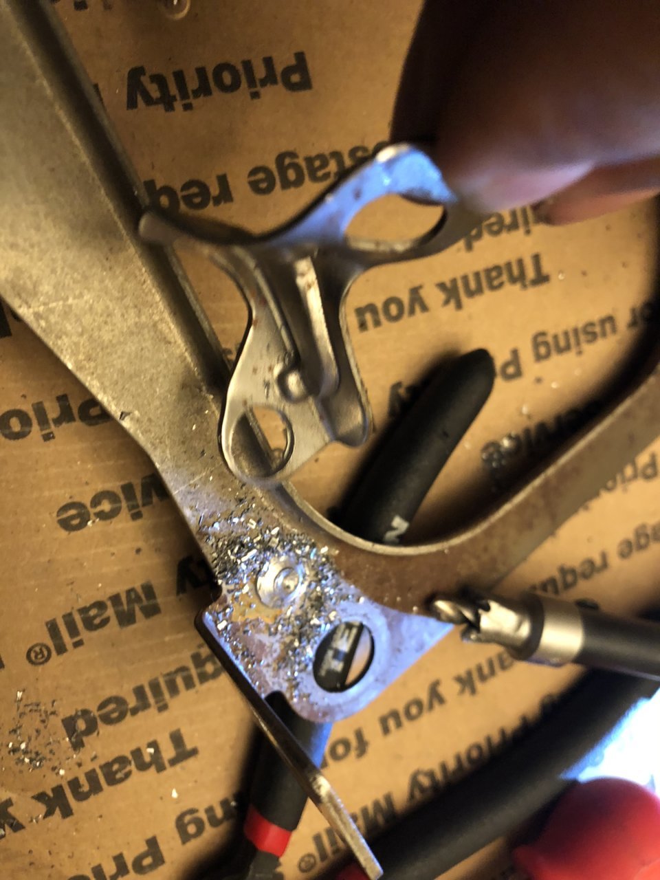

    Since I’m using a 4Runner shifter, there is a metal tab intended for the 4Runner trim I didn’t need and interfered with my center console. I just had it bent back when I first installed it, but now I actually took the time to drill it out.

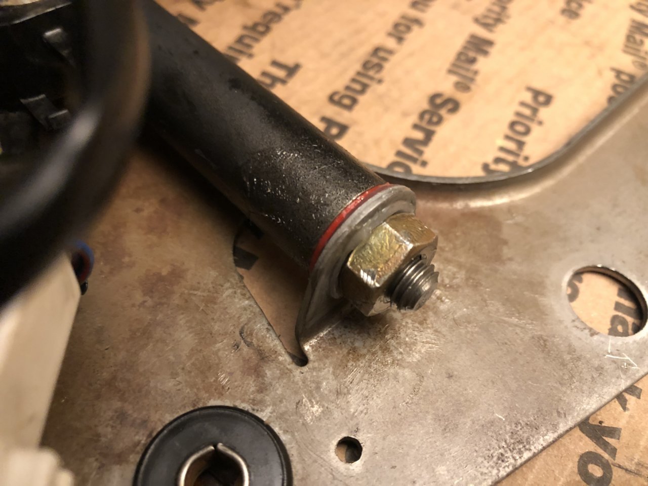

    Here are the bushings in place. Installation is very straightforward. I used synthetic Super Lube, as petroleum derived lubricants would’ve dissolved the PLA plastic. I had a hell of a time trying to find Silicone Grease, so the synthetic grease had to do.
    New Bushing versus the remains of the Factory Bushing
    While I was at it, I completed my dual transmission conversion and I now have selectable Manual or Automatic transmission — depending on your mood.
    Kidding, the shift knobs have the same thread pitch.
    First impressions, WOW! It shifts like it is brand new. No more slop, sharp and deliberate movements, properly indicates the current gear, and most importantly — doesn’t pop out of gear anymore.
    Just like the bushing on 5-Speed trucks, replacing the bushings on Automatic trucks make a profound difference on the shifting of the truck.

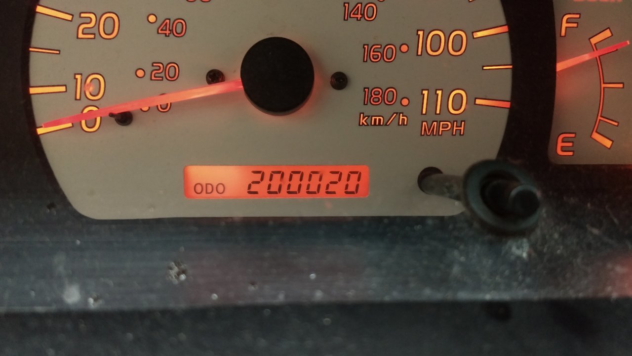

    Missed the rollover itself but finally hit 200K. First of any of my vehicles actually.
