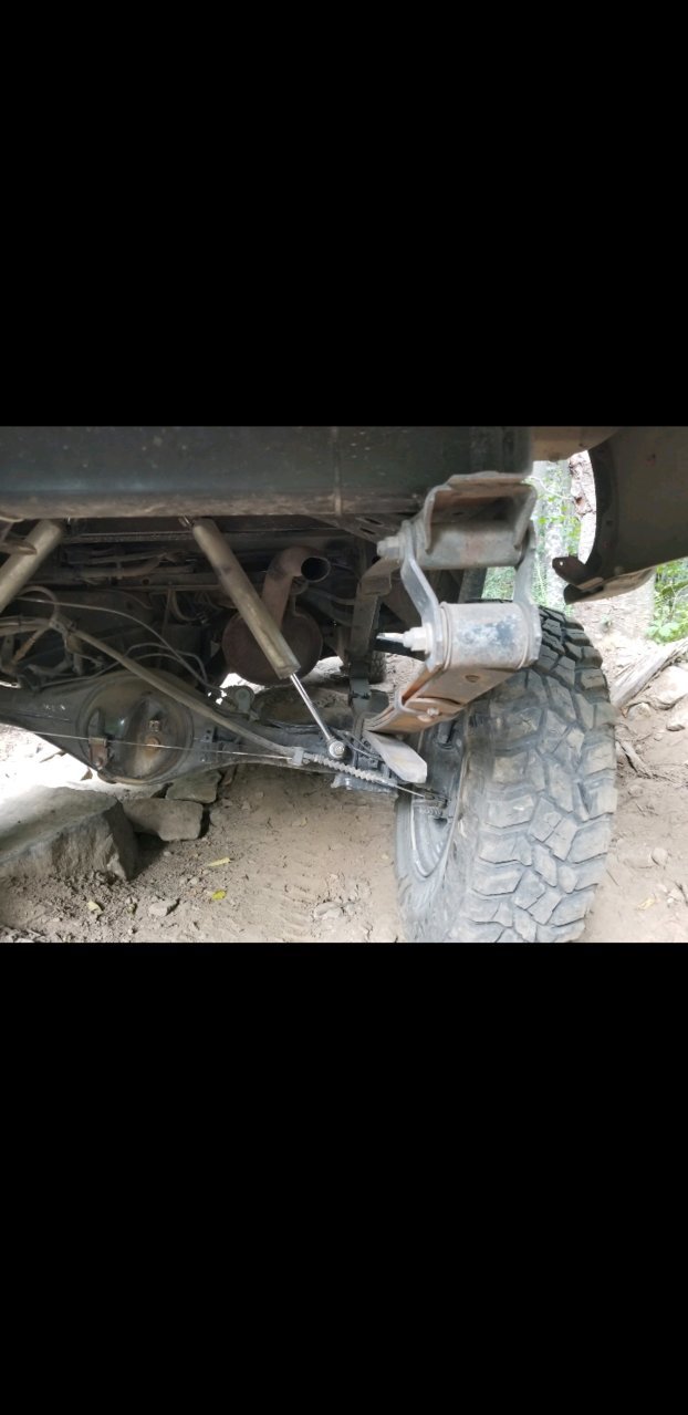

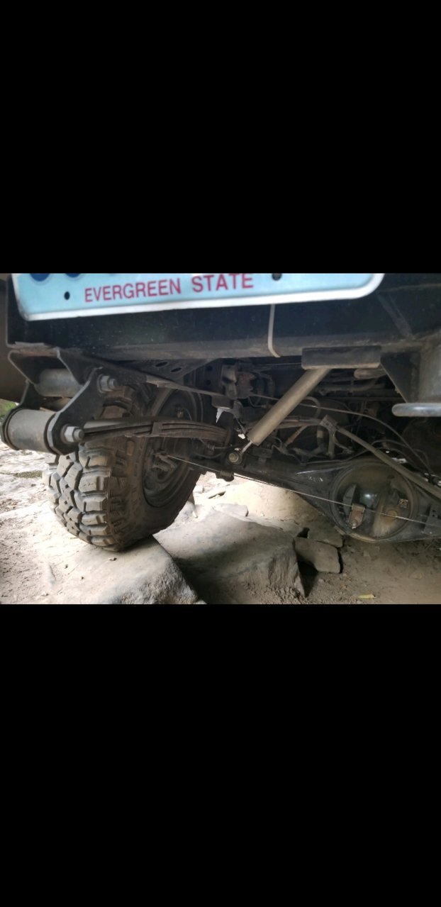

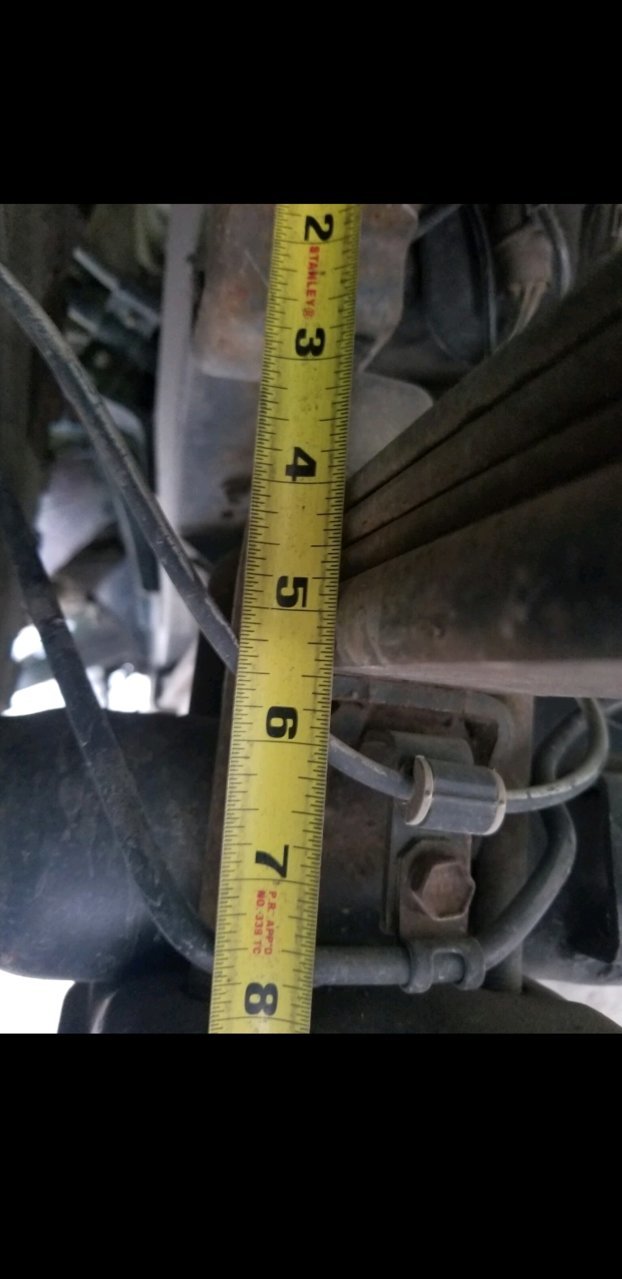

    My thought as well, although if that does end up being the case I need to find a more effective measuring method then as well. I drove his axle with one leaf as far up as I could go before, like it was to the point where it was lifting it back up off the jack stands and my bouncing wouldn't make it frown anymore. And that was the upper boundary. His leafs almost never invert, but now I need to know what is the variable we missed. We didn't account for the bumpstop on the shock, so there's is an inch more shaft to go. The whole thing cycled like 8.5"

    Wow that's not much.
    Did you measure the ride height before taking the bed off? I think I'd do that so you can place the axle and get the shocks as centered as possible.
    Also I'd do the whole axle up not just a side to decrease binding as that will generally go up higher than one wheel. Down is a different story.

    Put a bunch of weight on the back. Those leaves will invert.
    With the bed off and no weight, it's easy to lift the frame even with just one leaf.

    When you articulate the truck you not only have the bed weight but also the force of the front of the truck transfering the load being transfered to the springs thus applying more than a jack could do. . If you jack up the truck and not flatten the springs it sounds like the shackle is also limiting the leafs from flattening out combined with the resistance of the leaf pack thickness. If you put a straight edge from main eye bolt to horizontally flat shackle bolt that would be you inverted state. That measurment is your compress limit.
    Does any of this help, or make sense. I have been working wayyy to much so sorry abiuy the gibberish.

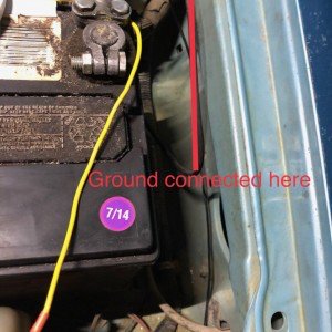

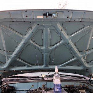

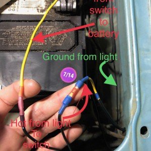

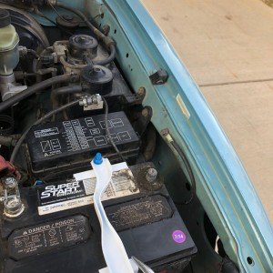

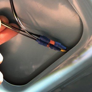

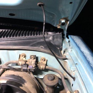

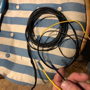

    Got them at Napa, I can't remember the brand name, but they came in a 2 pack for like $25 bucks, about 7 inches long and less than an inch wide.
    Got the switch for like 3 bucks and had wires and weather proof connectors. They came with sticky 3m backing tape then I just decided where I wanted them and ran the wires.
    Started by taking 2 lengths of wire, one yellow one black, about 10 feet long and taping them together. Yellow for hot, black for ground.
    Cleaned up the underside of the hood and stuck the lights where I wanted them.

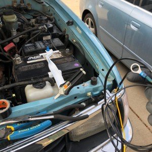

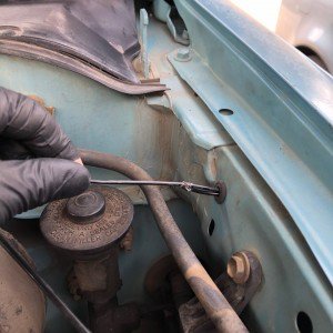

    Then I took a temporary wire and got it through this channel here on the side of the engine compartment where my I wanted my final wires to go. For pulling through black and yellow.
    You can see in this picture, my finger in the bottom right corner where it came through near the battery

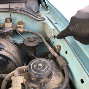

    Connected my pre-wrapped wires to the temporary wire. Strip, bend, twist and taped the ends together.
    Pulled through easily, here you can see the yellow and black wires coming through.

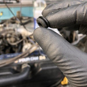

    I put these little grommets in all of the holes that i ran wires through, for protection.

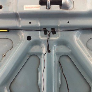

    Then I just fed the yellow and black wire up through the hoods frame to where I put the lights wires through. The pre-wrapped wires make it look nice and clean where the wires span from the hood compartment to the hood.

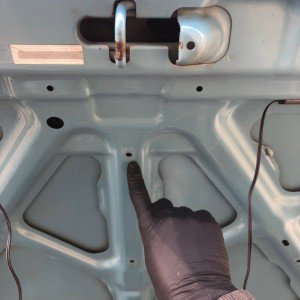

    I put the lights wires in through this hole
    Taped up the wires so they stay put. Connected lights to yellow and black wires, from earlier.
    Close up of connection from the two lights wires, to the yellow and black wires.
    Wiring at the switch

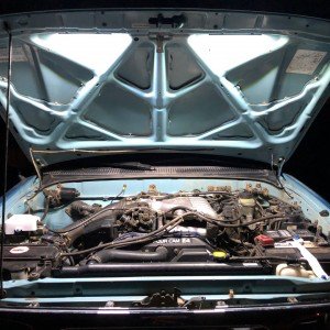

    Pretty straight forward. Used weatherproof heat shrink connectors or heat shrink tubing over connectors that weren't weather proof.

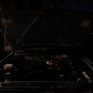

    Drilled a hole for the switch. Its like daylight under the hood at night now.
