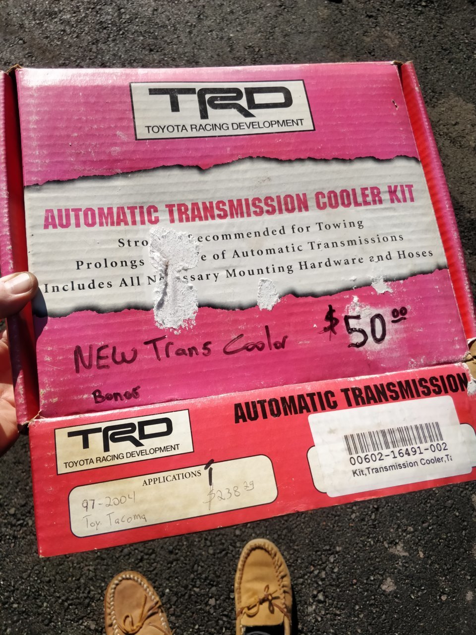

    Retrofitted a TRD transcooler, it's meant for a Tacoma, just wasn't going to sit where I needed it.

    Bahaha, $238. Wow.
    Didn’t realize they made OEM trans coolers.
