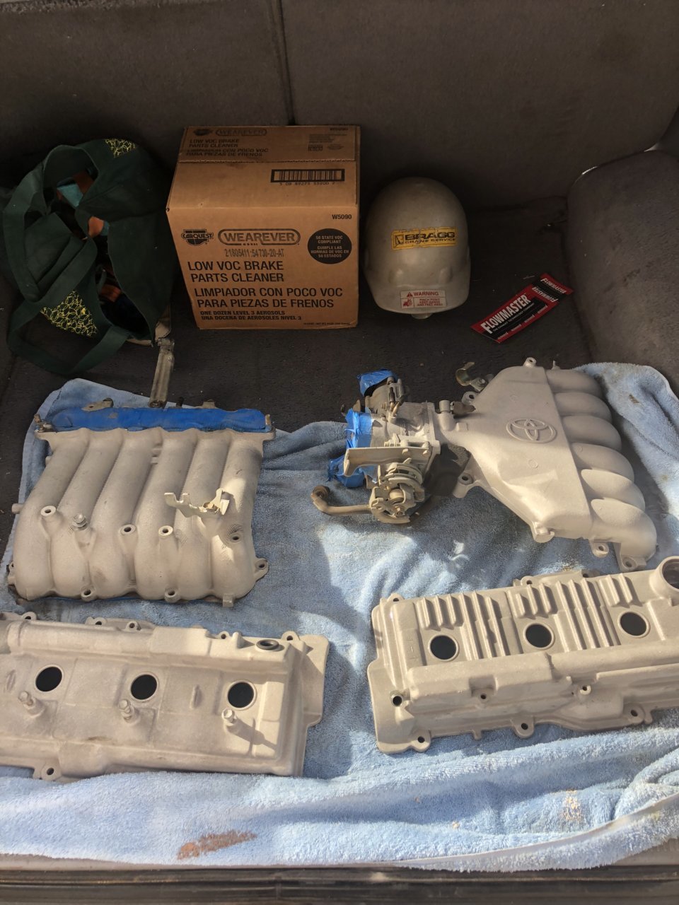

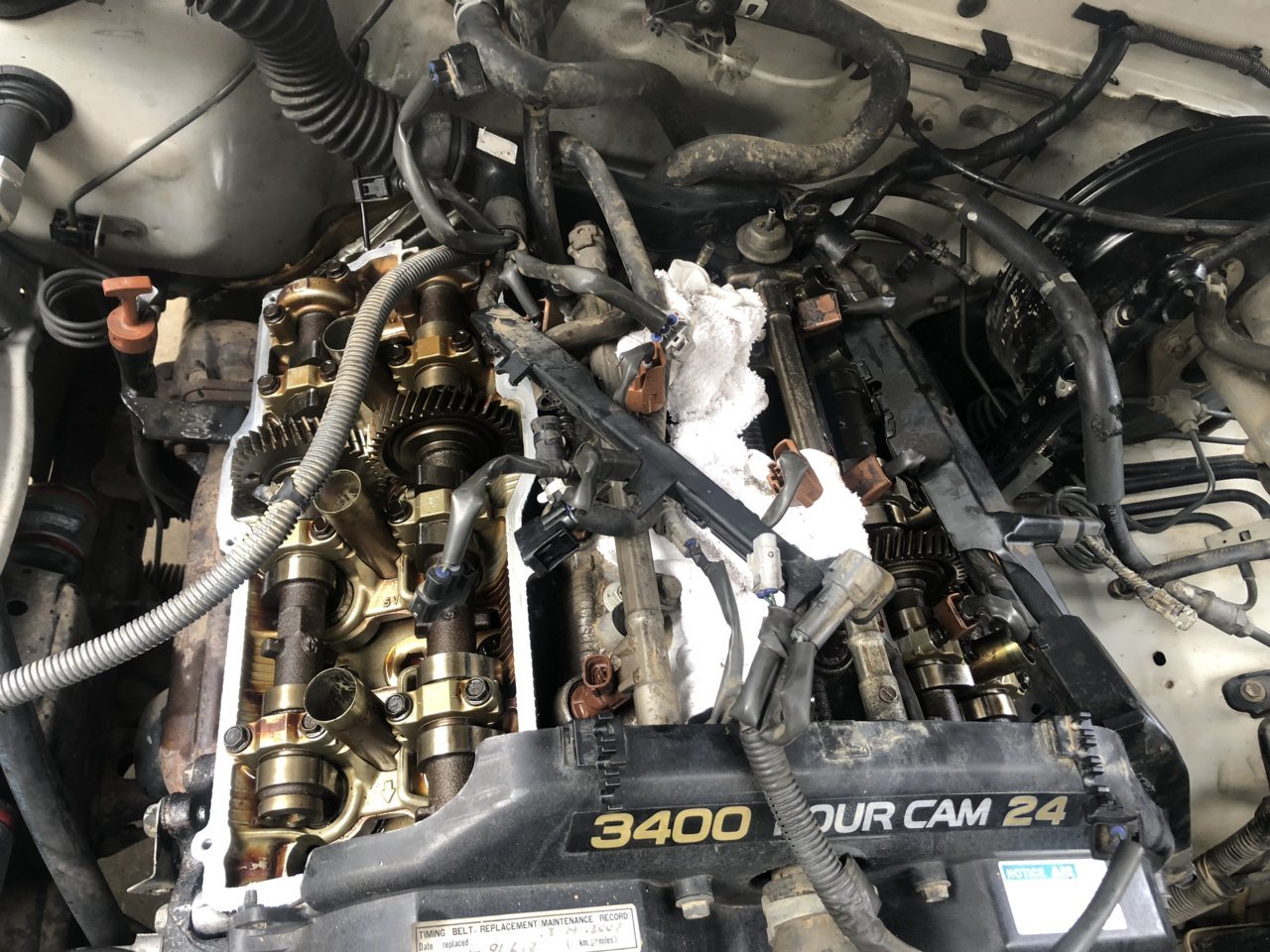

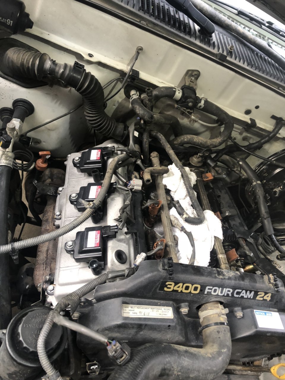

    Decided to start the process of chasing down some leaks. Figured I’d replace the whole lot while I was there.
    Valve cover gaskets
    Spark plug seals
    Plug wires
    Cam plugs
    Plenum gasket
    Pcv valve seal.
    Etc.
    Also did some sand blasting while everything was off :cool:
    Ran out of day light so it turned into a 2 part deal. Partially back together-ish.

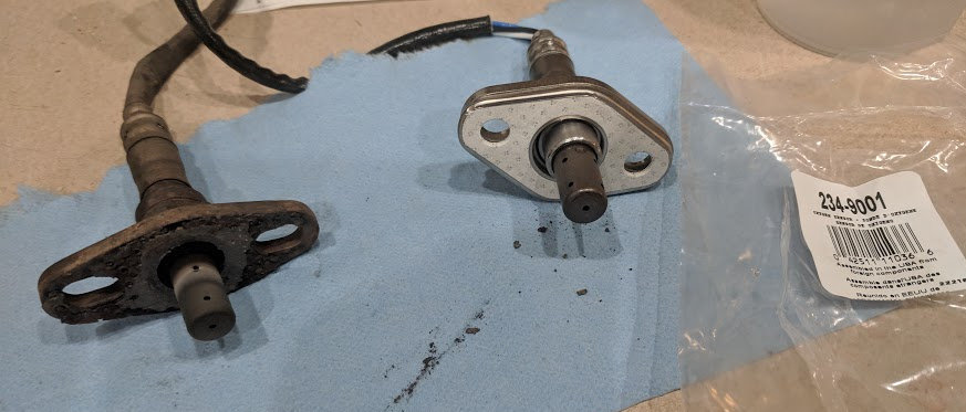

    Replaced upstream O2 sensor as part of my Xtreme Preventative Maintenance Program and quest for MAXIMUM emm pee geeze.
    Hardest part was getting the harness mount bugger off its perch on the transmission. Used needle-nose vise grips on the tab that allows you to disconnect the O2 plug so I could wiggle it out: EZ out-of PEEZEE, would recommend. Bolts came off easy but the gasket was disintegrating into a jillion pieces all over my face... I have a hard time believing a factory-original O2 sensor can last 15+ years and 170k+ miles without throwing a CEL, but just LOOK at that gasket devastation.
    Did a halfhearted "cleaning" of the gasket mounting surface on the exhaust, bolted her up, and took her for a spin. My butt dyno was immediately tingling and the taco seemed much more responsive, but we know how that goes.
    Bonus nachos: the left-most instrument cluster light that I had assumed burned out several weeks ago started working again... dunno if that's due to battery disconnect or new O2 sensor XD

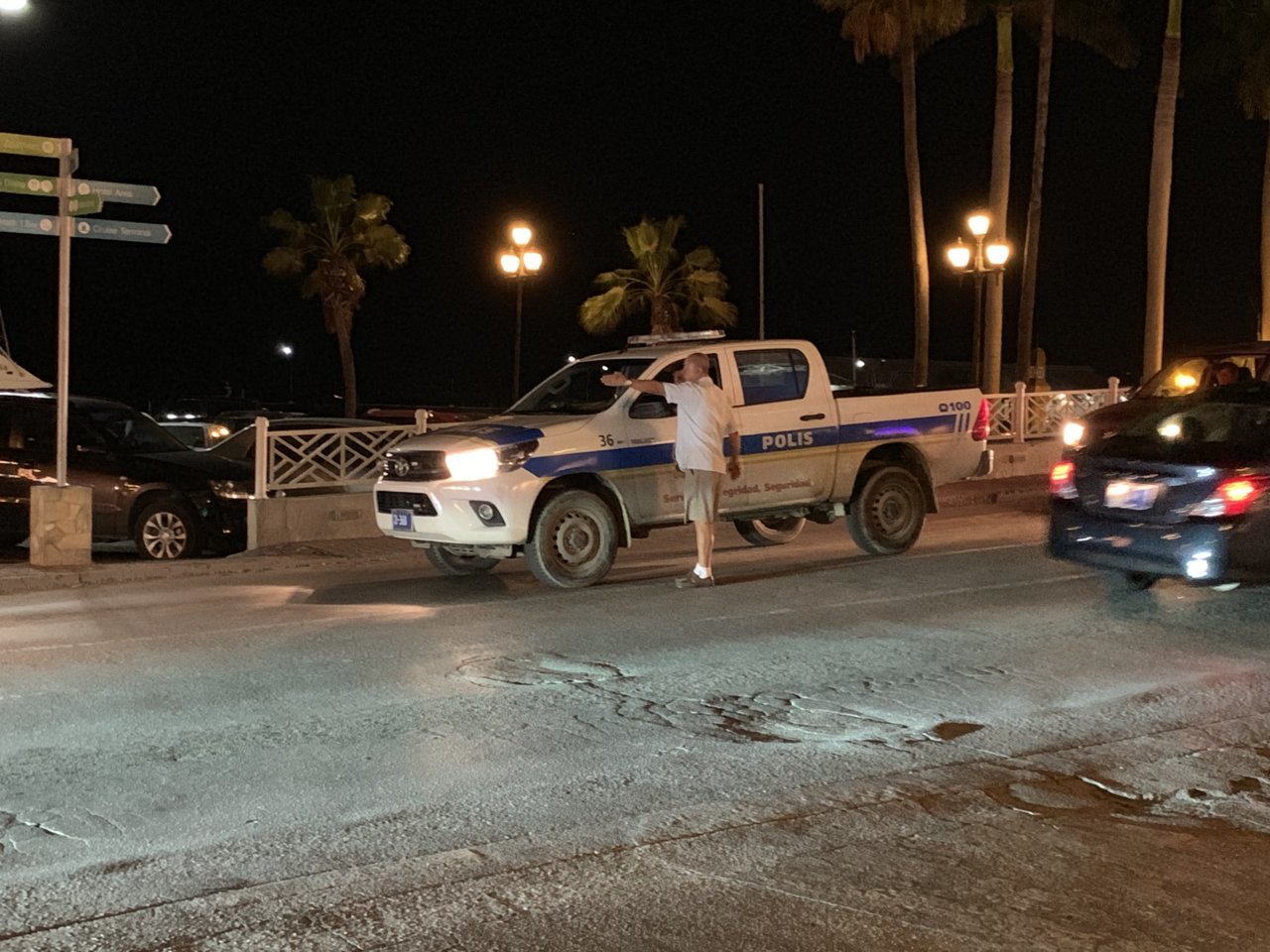

    Saw one of these while on holiday in Aruba. The HiLux is very popular around here.
