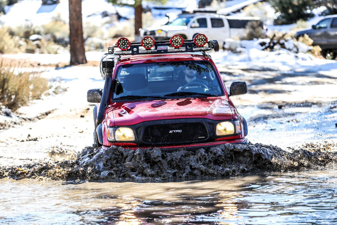

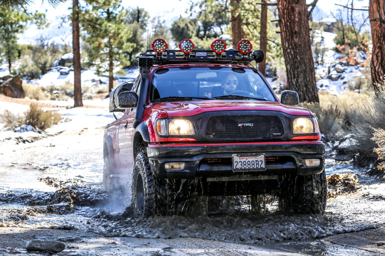

    question for you guys...I was wheeling this weekend up in the mountains, after we got to a good lookout spot to stop and take some pics, I hopped in my truck - put her in 4lo and reversed about 10 feet - didn't realize until I shifted into 1st gear that I had my e-brake on still (doh)
    I went to pull the e-brake to see how badly I screwed it up, and it was incredibly tight...I only got maybe 3 clicks out of it before it was completely taught. Normally I need about 15 clicks to get it to be tight.
    Jumped out and looked at the cable behind the rear axle, and it was completely askew...looked like I had bent the bracket that holds the e-brake on the passenger side of the axle up so that it was no longer parallel to the axle...it was at a crazy slant. Which I guess explains why it was so much tighter.
    Got out my small 3lb sledge hammer and bent the bracket back into place so the brake cable is parallel again...e-brake feels like it's back to normal but I can't help but feel like it might be dragging a bit. I feel like when I'm on a hill it doesnt want to roll quite as easily as it used to. Might just be my paranoia but is there a way I can check to see if the e-brake is still partially engaged to the drum/dragging? And how would I fix that?
    Couple pics from this weekend for attention, many thanks to SocalTacoTruck for the photos
