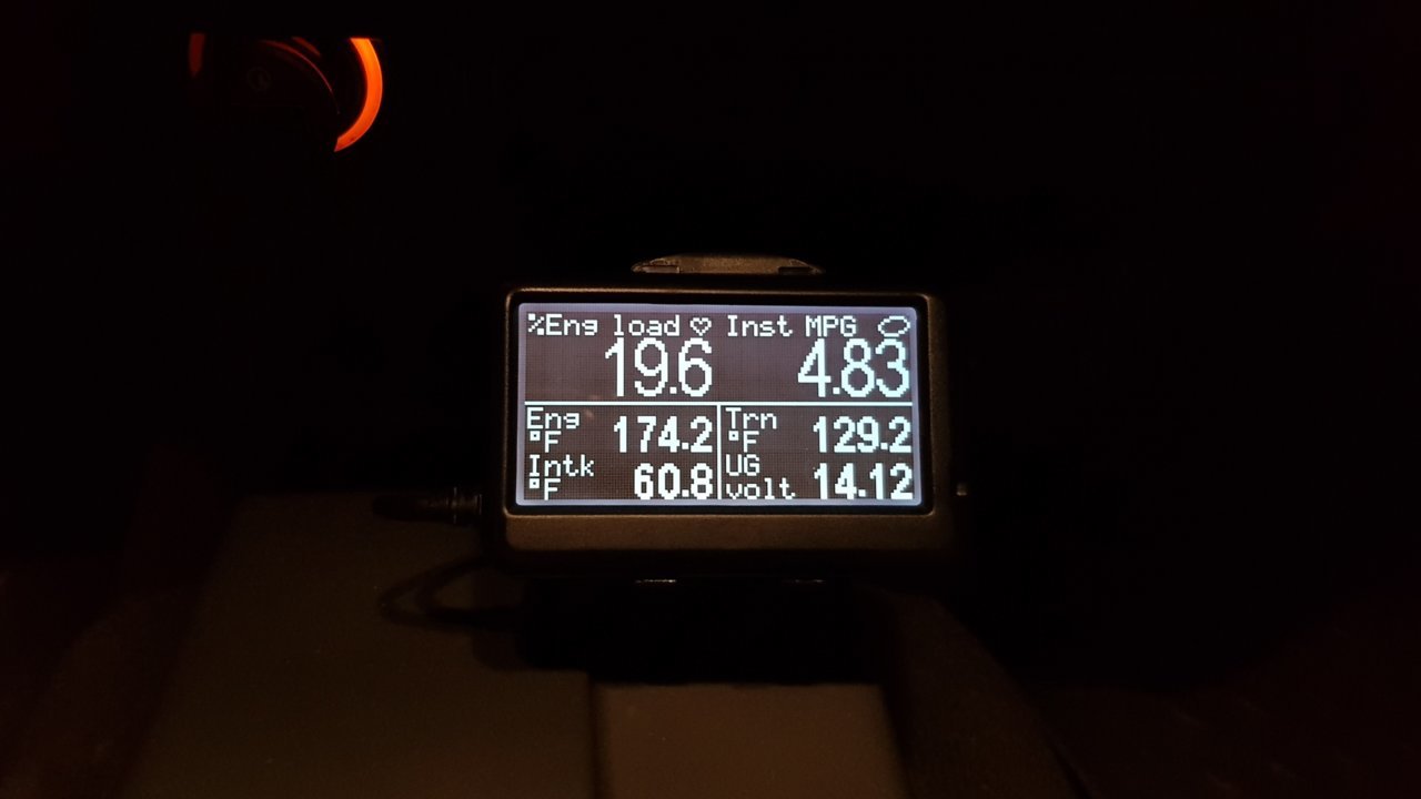

    Has anyone with a 1995-1998 truck been successful in reporting transmission temperature to a ScanGauge?
    My ScanGauge won’t read mine properly and I’m wondering it it’s a year by year issue.

    V6 5sp,RegCab,TVS1320 Supercharger, 56mm pulley, methanol injected Haltech ECU, AC Tvs1320 supercharger,(MUST DO) every 125,000- 150,000 needs rebuild Projector headlights HID 5 speed manual Amsoil for all drive train Smaller 56mm custom pulley, (MUST DO) 2004 DESNO fuel injectors, zero ping ping, 2004 side door mirrors Dick Cepek Rims, Michelin tires LTX, ATM Pathfinders Dynopro ATM ( that last 100,000 miles) Now running Dynopro ATM mud and snow tires KN cold air intake Cat back dual exhaust with ss exhaust tip, Raised exhaust tail pipe to 2" below body line Optima*dry cell battery,red top Alpine sirius radio, 200 watt amp, focal is165 split door pod speakers Focal door speakers Subwoffer behind seat Viper alarm, Electric Locks Dark tinted windows, bucket seats corbeau lg1 Tacoma Rubber floor mats TRD fender extenders, Bilstien shocks, King shocks JBA UCA trailer iv hitch, electric brake control, Drilled slotted brakes, High carbon steel (MUST DO) EBS green stuff 7000 series pads(MUST DO) TRD engine oil cap TRD stick shift, Marlin crawl shift kit. Rear sliding window 2002 4Runner functional hood scoop cut into Tacoma hood, 4Runner dual overhead map light Gentex Auto dim + Compass + Temp, garage,rearview mirror Snow Methonal kit stage 2 Custom 3 core aluminum radiator Linex bed liner Haltech stand alone ECU, Intake supercharger gauge. Stainless steel brake lines, Custom leather wrapped steering wheel, Haltech stand-alone ECU,
    I think I remember reading that this info is not available for those years.

    Flux Capacitor
    Yeah me too. I do know there’s a member on here with a 1999 that managed to do it.
    I put a 1999 transmission on my truck when I did my 4x4 conversion so maybe there’s a chance. It’s all handled in the ECU, which is still 1998, so who knows.

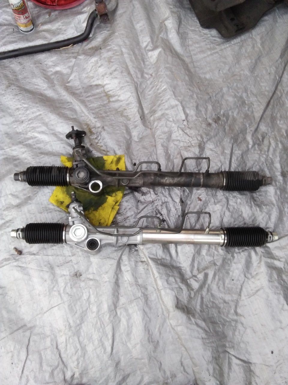

    Pulled the rack and pinion steering gear.
    What I didn't do was get the lower half of the rag joint off the old gear. Backed the "keeper bolt" out of the pinch clamp completely but it still won't slide off. Soaked it with some PB Blaster as I believe it's supposed to just slide off. Hopefully tomorrow I can report that I installed the new gear.

    Flux Capacitor
    Damn. I do remember someone with a 1999 being able to report transmission temp. I could be remembering that wrong.

    It's less Tacoma and more mod
    1999 4Runner can but I don't believe Taco can being the lower buck model

    OME lift, 4x sliders, Demello rear bumper, custom front bumper, Engo 9000lb winch
    Tap a blade screw driver in the rag joint. Should open it up more.

    97 Tacoma Single Cab 4x4
    I had the same problem. A hammer and pry bar eventually got it off. Then tap it on and off the old rack repeatedly till it slides nice, will let it slide right on the new rack if you'll be installing after the rack is mounted (shown in @Timmah!'s video)

    Check Out My Builds
    Air chisel and heat is what we used, was a PITA but got it off

    Donahoe CO, Donahoe Rear Resi, Deaver J59, 16" Pro Comp, 33" BFG AT, Hayden Trans Oil Cooler, Oil Filter Relocator, FM 40, ES Bushings, Beefed CB Drop, Deckplate, K&N Drop-In, DO Bed Bar, Cobra 75 WXST, Firestik Firefly, Philips D1R, Clarion Remote Start, Husky Liners
    Lol. Which one of your trucks are you using the SG on?

    The Trifecta of Taco's
    The only one with an auto. Igor the double cab. Frank may get a UG at some point for knowing fuel trims and also how much gas is really left for trips. But that's it really.

    2004 TRD V6 XtraCab
    @Digiratus @Reh5108 @lukester78 @BYJOSHCOOK
    Thanks guys. That is good confirmation that it works the way I thought it should work. Now I can get serious about getting it off without worrying that I missed something. Really appreciate it.

    Drop bracket lift and booger welds
    +1 on air chisel. It's the ONLY thing that worked for me. I even bought 2 pickle forks that didn't do shit.
