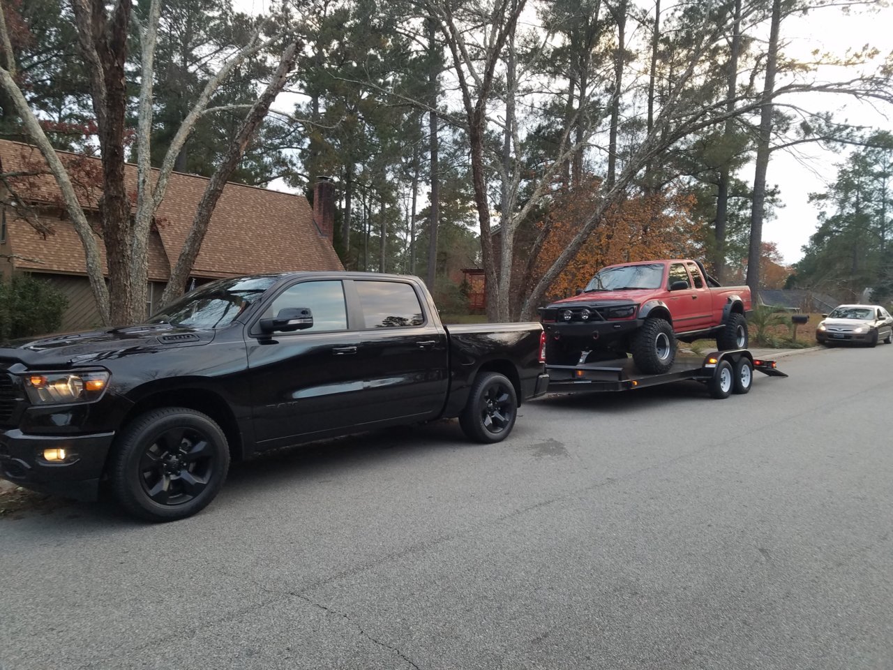

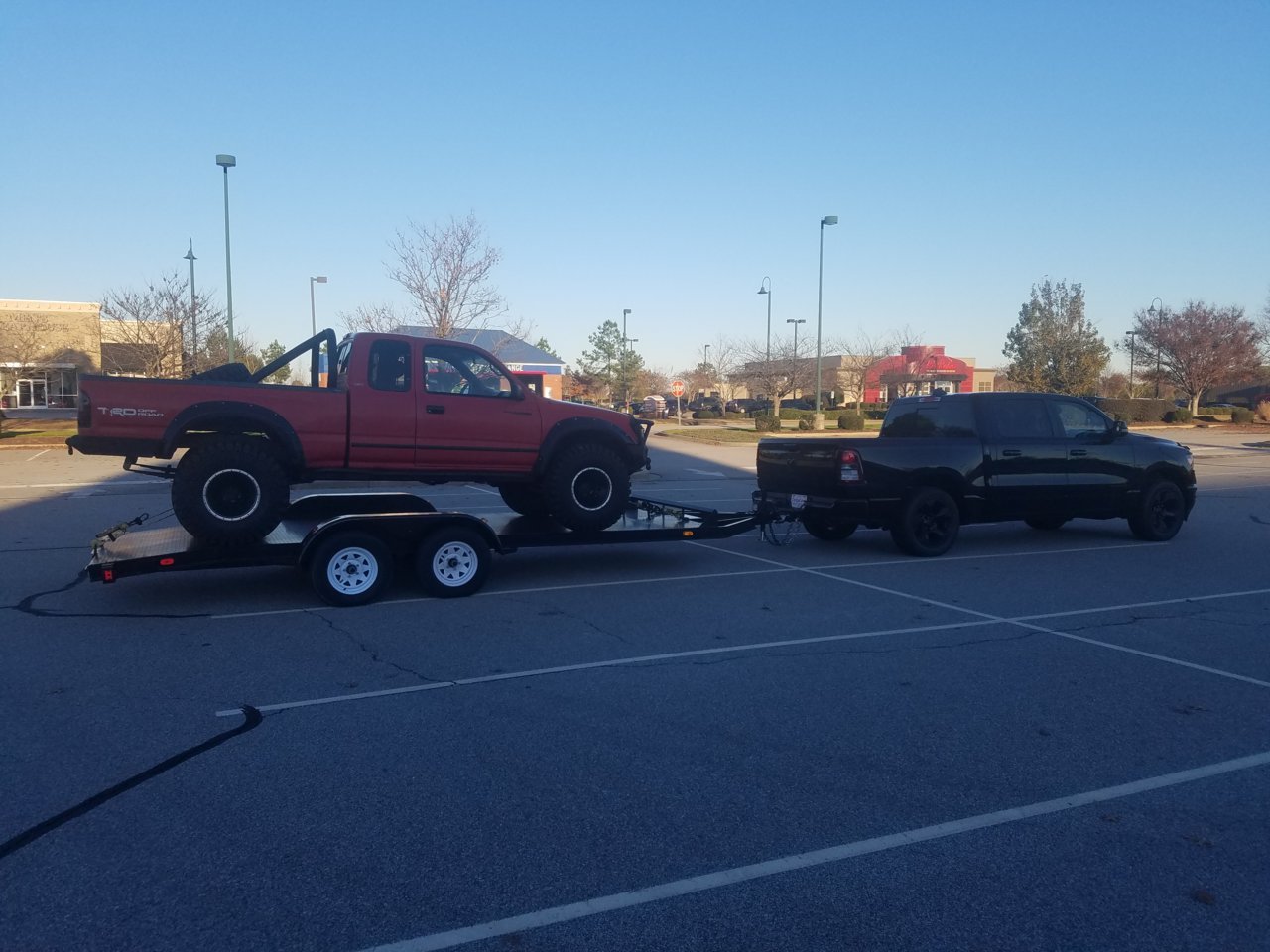

    They called it a 15+3. 18 total with a 3 foot dovetail but the angle of the dovetail is shallow.

    What did you install in the rear that looks so high comparing with the front, rear up face down look ...no ...no seriously what kind of leaf pack and shocks you have .... the tire is so big 33's or 35 's , what's the plan to lift the front if any or will the rear get settle down with extra heavy weight for couple weeks on bed as someone said is done when new leaf packs ? Anyway.... just curious for the pic angled truck,,,,:hattip:

    I tubbed my firewall a couple of years back to fit 35's. At that time I had my adjustable coil overs at about 2 inches of lift and a wheelers leaf pack with 1 inch shackles out back. Recently I installed a crawlbox with new heavy wheels and sticky tires and was worries about snapping CV's so I lowered my coil overs for an almost flat CV angle. The front is probably sitting at 0 or maybe .5" of lift right now and I'm thinking about either pulling my overload leaf in the pack or going back to factory length shackles to lower the rear.
    I keep looking at the truck sideways to level it out o_O because it's driving me nuts, but my steering rack took a dump in the middle of the crawlbox install so I haven't had any time to adjust the rear. :sadviolin:
