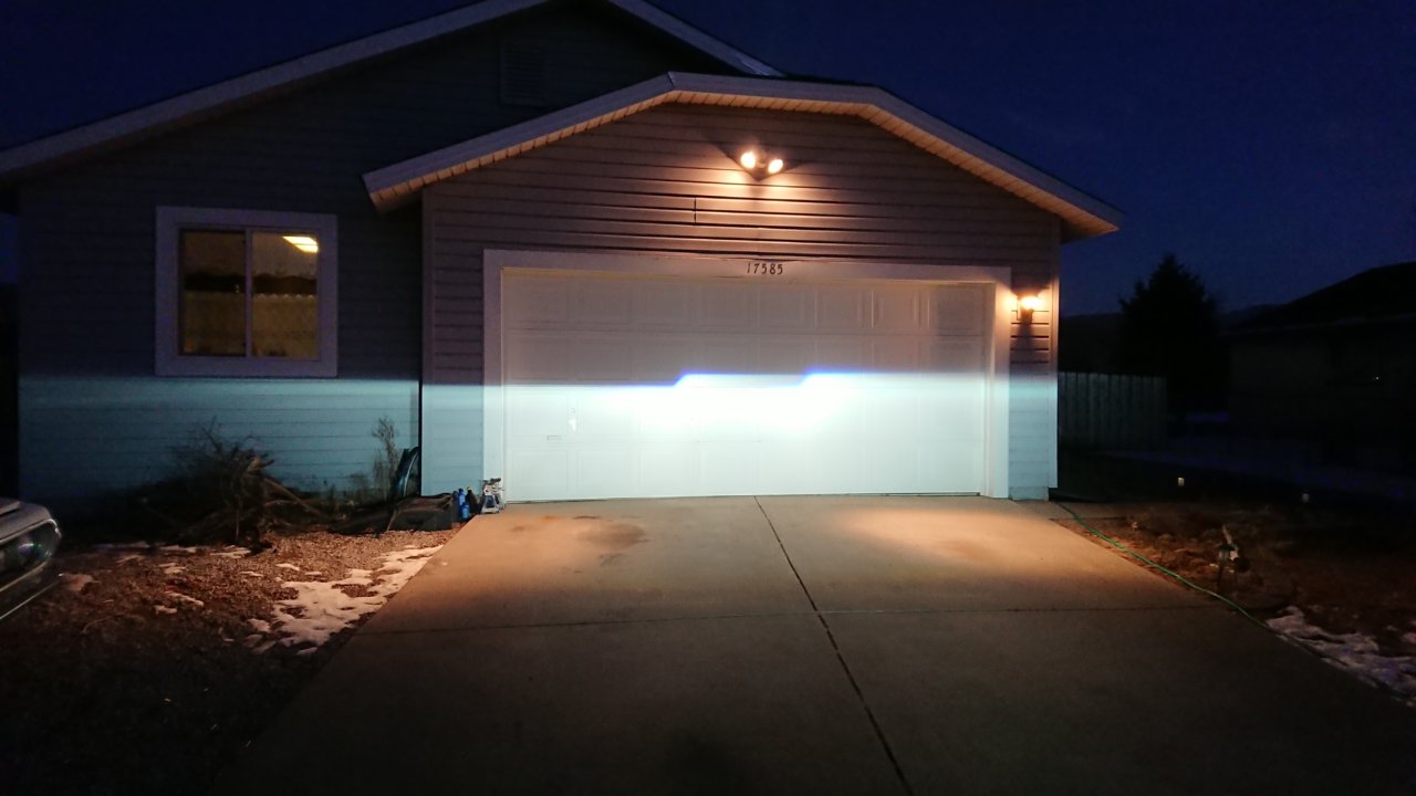

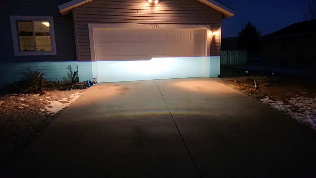

    They've advance but you have to do it right if you want HID results.
    Basic Morimoto mini H1 5500K vs. 2 different single LED projectors
    LED Projector 1
    Projector 2. Has wider coverage than both the HID and other LED.

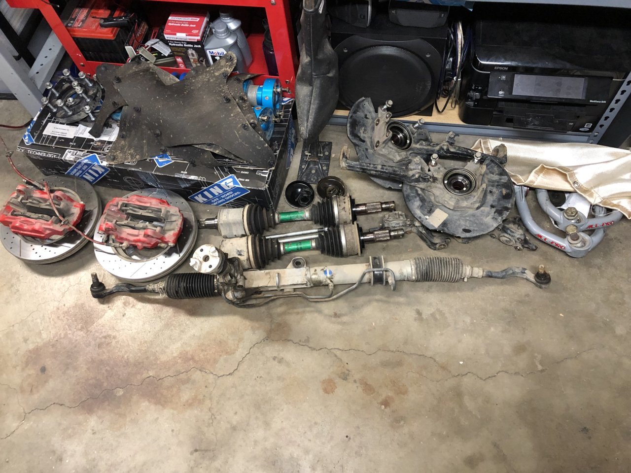

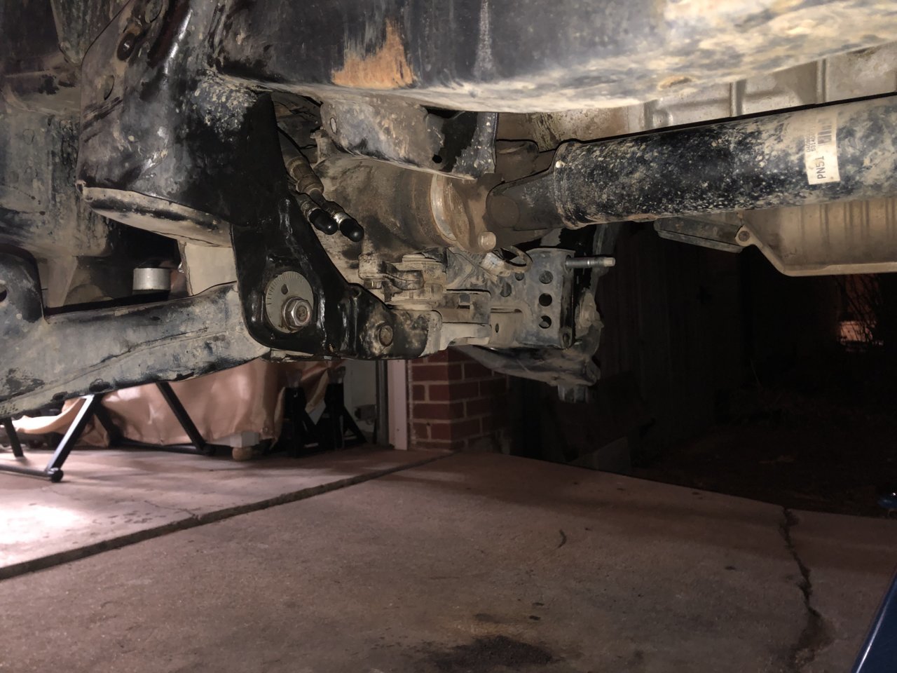

    Stuff. Also things.
    In the process of gusseting all the things.
    Got a bunch of stuff removed yesterday and got the rack pulled this afternoon. Just have to pull the LCAs and then I can get going on the cam tab gussets.

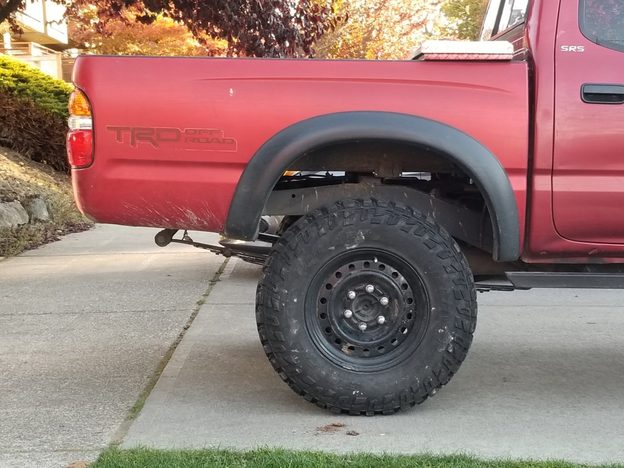

    Hopefully will have a new high clearance rear bumper and swing out in the next few weeks

    Definitely like the cut off on the Morimotomini H1 5500K,
    Are these for the 5x7 lens? 1995-1998,
    Parts list anywhere with photos?

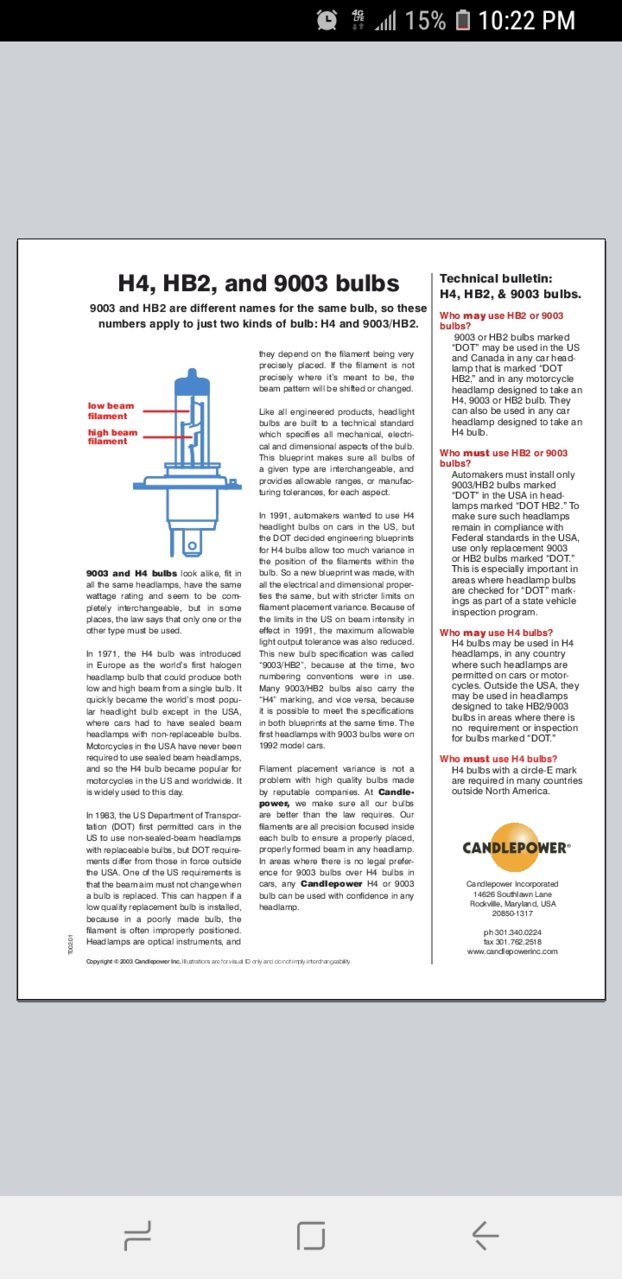

    I have always run a 9003/h4
