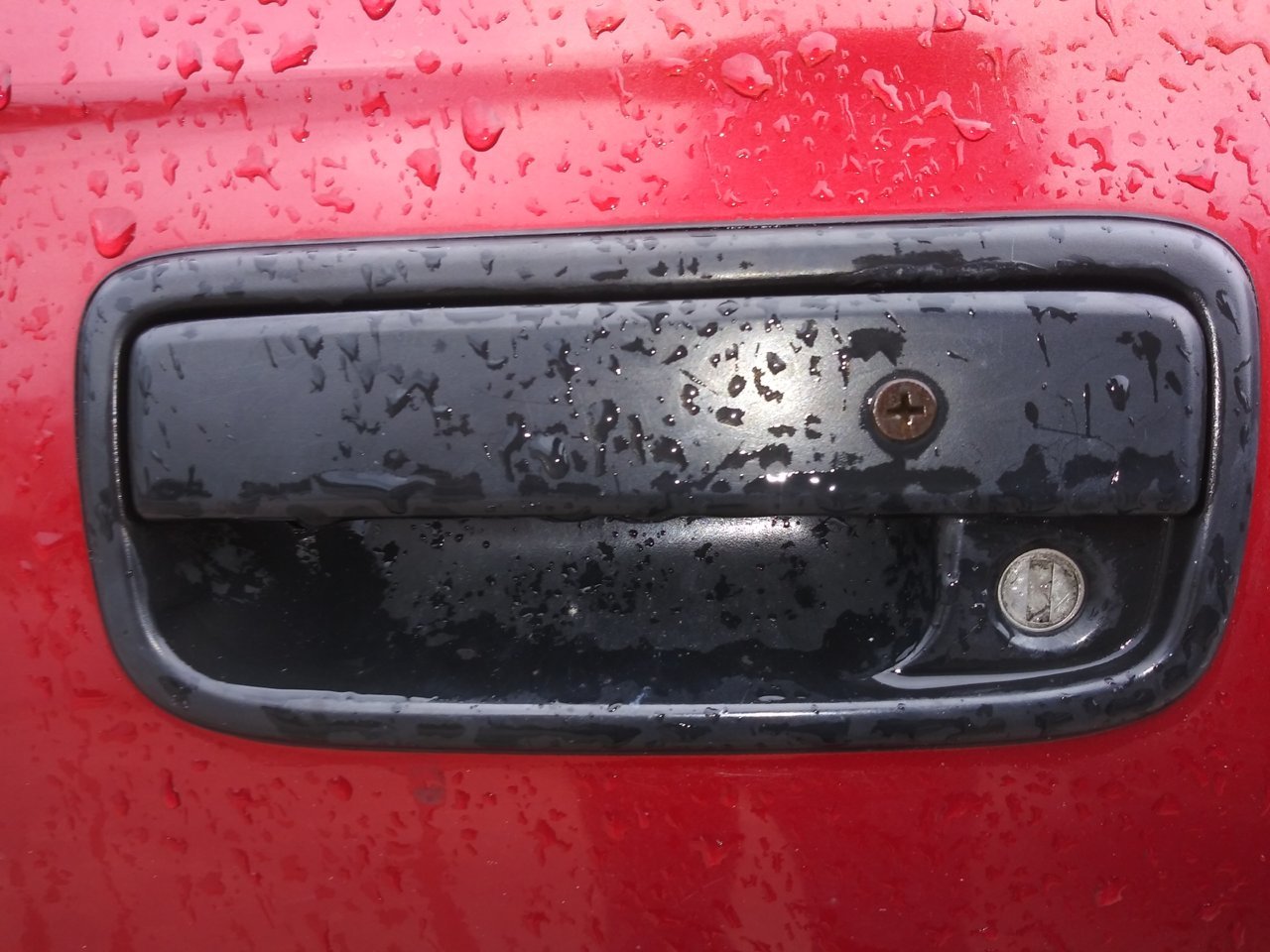

    Tundra hyper-silver double 5-spokes with 265-70-17 BFG All-Terrains. Compact Cobra CB in the ashtray slot. Cut a small hole in the plastic and mounted the antenna to the drivers side windshield wiper mount using an old Harley Davidson blinker bracket. 1 1/4" drywall screw is holding door handle together nicely.
    Temporary fix for a cracked/broken door handle... I used a 1 1/4" sheet metal screw. Pre-drilled a 1/8" hole so that the screw wouldn't crack the plastic. 20181214_135637.jpg 20181214_135623.jpg

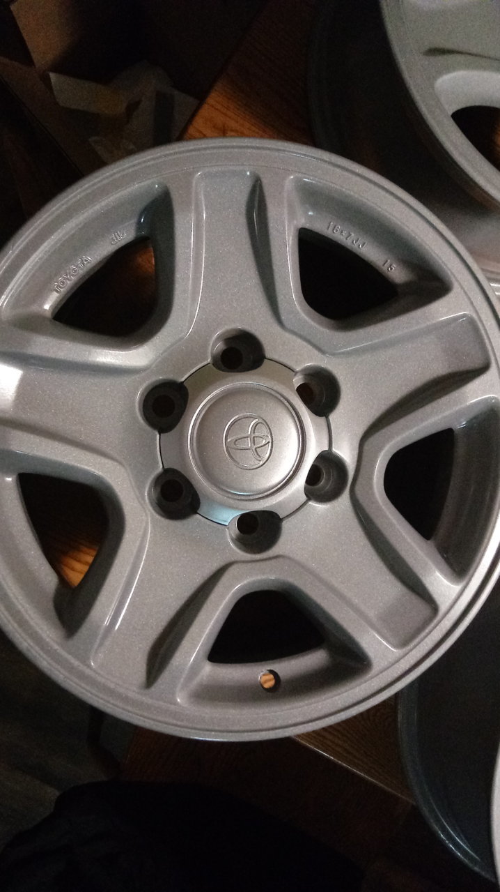

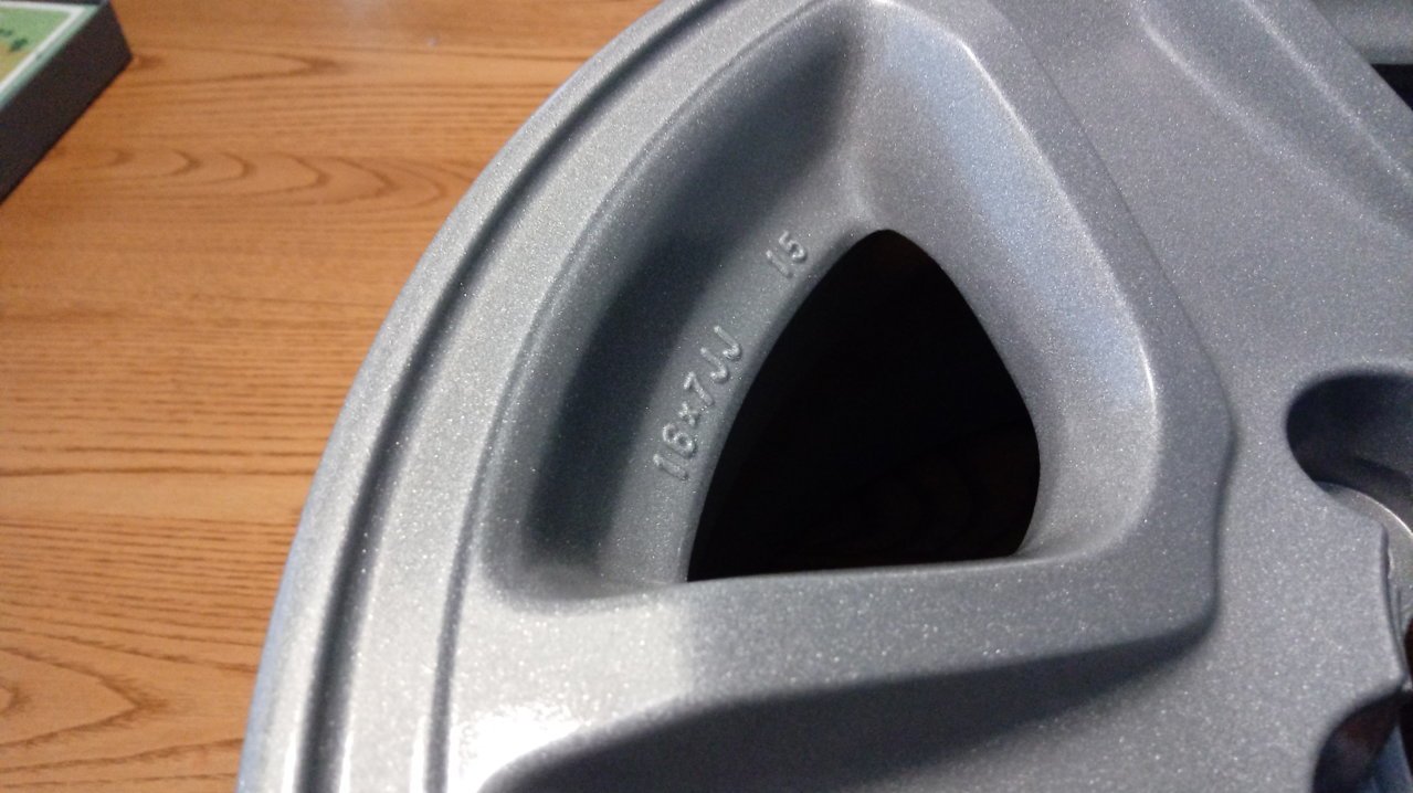

    Those are the size of the wheels I use...what size are they? Wondering what will be the smallest KO2 that can fit in these ?

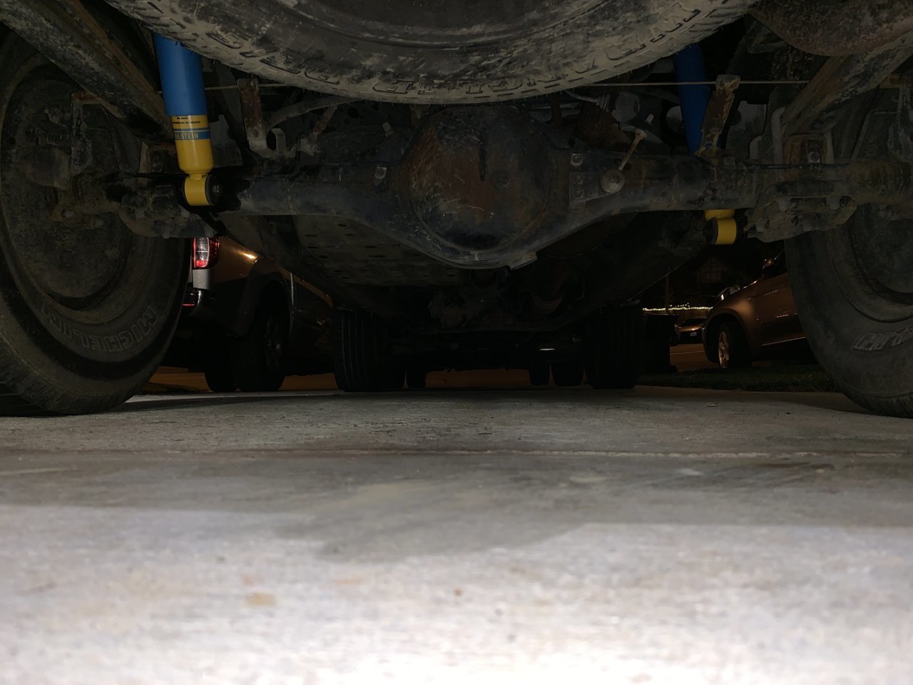

    put my bilsteins on. only the rear ones for now until bilstein ships me the missing part

    Not that it matters, but theyre upside down...

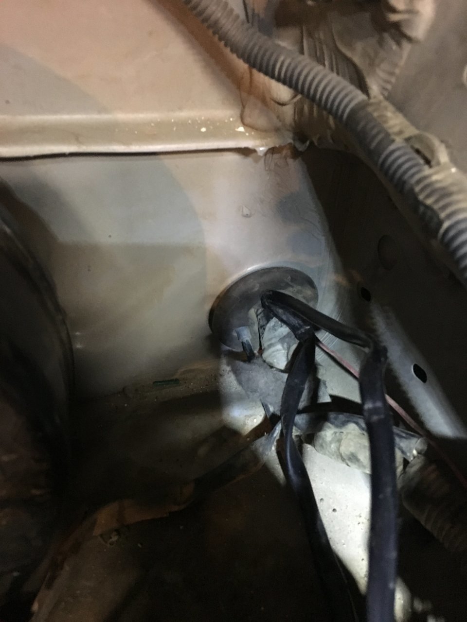

    Fixing shitty wiring jobs, that were causing leaking into the cab through the firewall. Suppose to rain tomorrow. That will be the real test.FA52A474-38E8-4CAE-955B-92DC33D338B2.jpg

    How are you fixing it? Replacing the boot and bundling the wires better or just gooping the shit out of it with RTV sealant or something?

    Those Bilsteins are nitrogen charged shocks. Which means they can be mounted shaft up or shaft down. They will work equally well either way. In fact, I would not run them shaft down because the blue shaft cover will act like a cup and will retain water/debris/mud etc.

    I cut the boots off mine. Shaft down.

    ahh never thought of that. cool so i did get it right. thx sir:thumbsup:

    I cut them, put them through the boot, sodered them back together, heat shrinked them and siliconed the boot. I originally put the wires on the outside of the boot and it was leaking water

    It doesn't matter which way you mount them. My 5100's are mounted "upside down".
