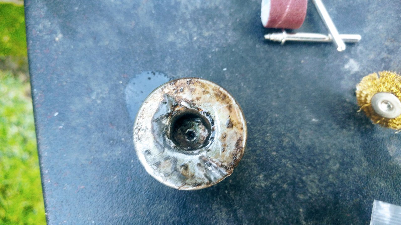

    YES! Finally got this stripped fucker off the front diff...used a Dremel with a small cutting wheel to notch the plug then hit it with a chisel and hammer.
    Always clean your front diff plugs out before attempting to loosen them...never making that mistake again

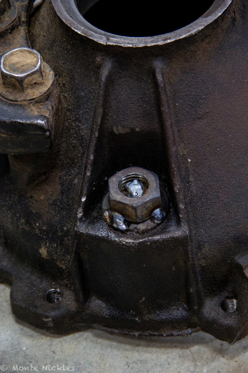

    I said fuck that and welded a huge nut to it haha

    I was gonna go that route but don't have a welder, was going to buy a cheap flux core one just to get the job done but read about this method and figure Id try it first...plug was ready to come off I think but I had stripped it real good. If it was on there much harder I probably would have had to weld a nut to it

    Yeah took me at least two tires I think. Works now though

    Always smack the plug with a ballpine hammer first, almost become finger loose. Learned this from @thefatkid
