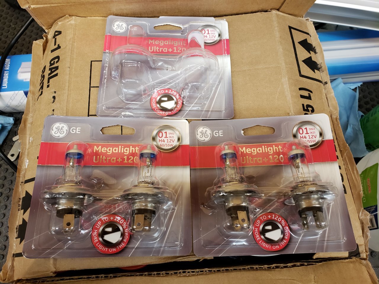

    I love mine. I had to get the rest of the fleet upgraded...

    Lol, might do my sequoia too if these work good. Did you do the harness upgrade? And if so which one?

    No, I did not do a harness upgrade.

    Really ? Just plug and play. No issues with wires melting?

    All factory wires. The GE +120 Wattages are the same as factory. As a matter of fact my favorite bulbs, the now discontinued Osram 64205 were 70/65W and never had an issue. I could have possibly gained some lumens with a harness upgrade to decrease the voltage drop but never bothered. Long story short, you will be just fine.

    Your stock wiring are limiting your new headlight bulbs. The replacement wiring kit has larger gauge wires that are capable of carrying more amperage which will unlock the full potential of those high wattage bulbs.

    They aren't higher wattage.

    Stock bulbs are 55watt, what are those?
