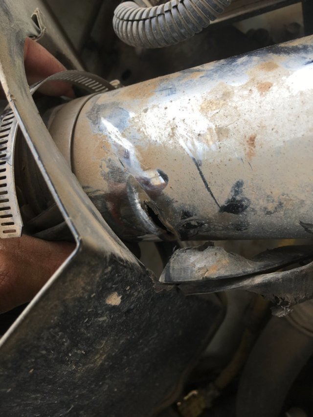

    Could just be that you have a four cyl. Also did you check that intake pipe ever for where I pointed out that it was rubbing?

    Never did, completely forgot.

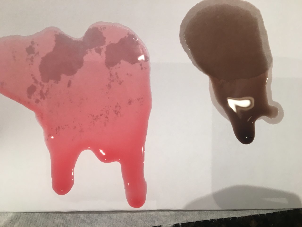

    I don’t remember my truck vibrating this much when it was 2WD. It could also be the sketchy transmission I used too. The ATF I pulled from it was this color:
    90% sure the donor truck was in a front end crash. That’s why my torque converter was warped and caused my flexplate to implode like it did.

    Transmissions don't just vibe cause they're dirty, there would be major mechanical failure if it was vibing as much as you're describing. Like tc out of round, or 1/2 band brake broken

    I was naive and didn’t know any better. This was almost three years ago. I went into that swap not knowing the difference between 2HI, 4HI, and 4LO.
    The torque converter there was no way of knowing if it was broken unless you used a runout gauge. Even the transmission shop I brought it to made the same mistake, since the flexplate broke again AS I was driving out of the shop.
    The fluid was my own fault. I never thought to check the color.

    I thought he was talking air intake
    :rolleyes:

    Oof.
    Actually I should check that when I get home.
