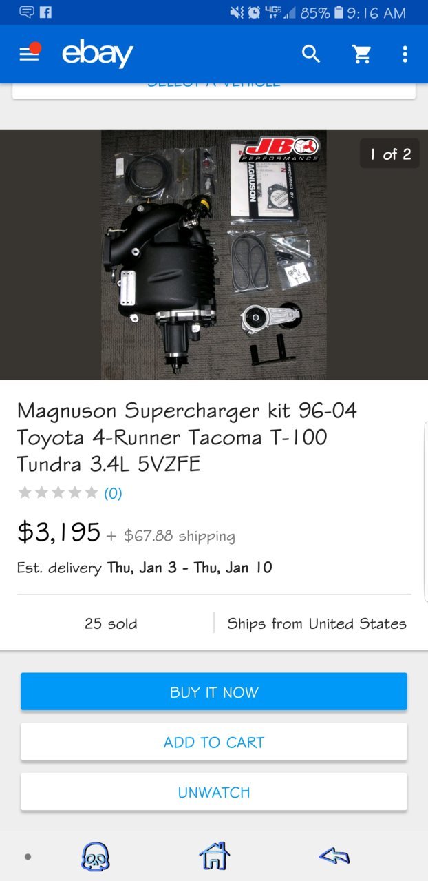

    :pccoffee: Good morning @Shiki Shabazz
    Are you going with the 7th injector kit or AEM Fic6 with larger injectors?
    All this supercharger talk is new for me, so I'm making a plan to get the most power/torque for the money. It's an expensive mod, but seems to be hands down the highest reviewed...do you think it's worth the cost to port & polish?
    I've gathered some info here https://www.tacomaworld.com/threads/turbo-bs-thread.481844/page-474#post-19392514
