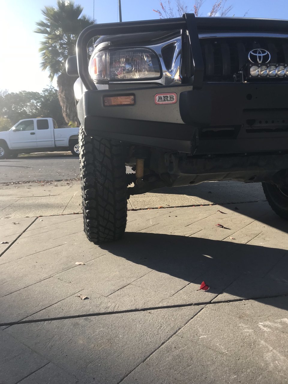

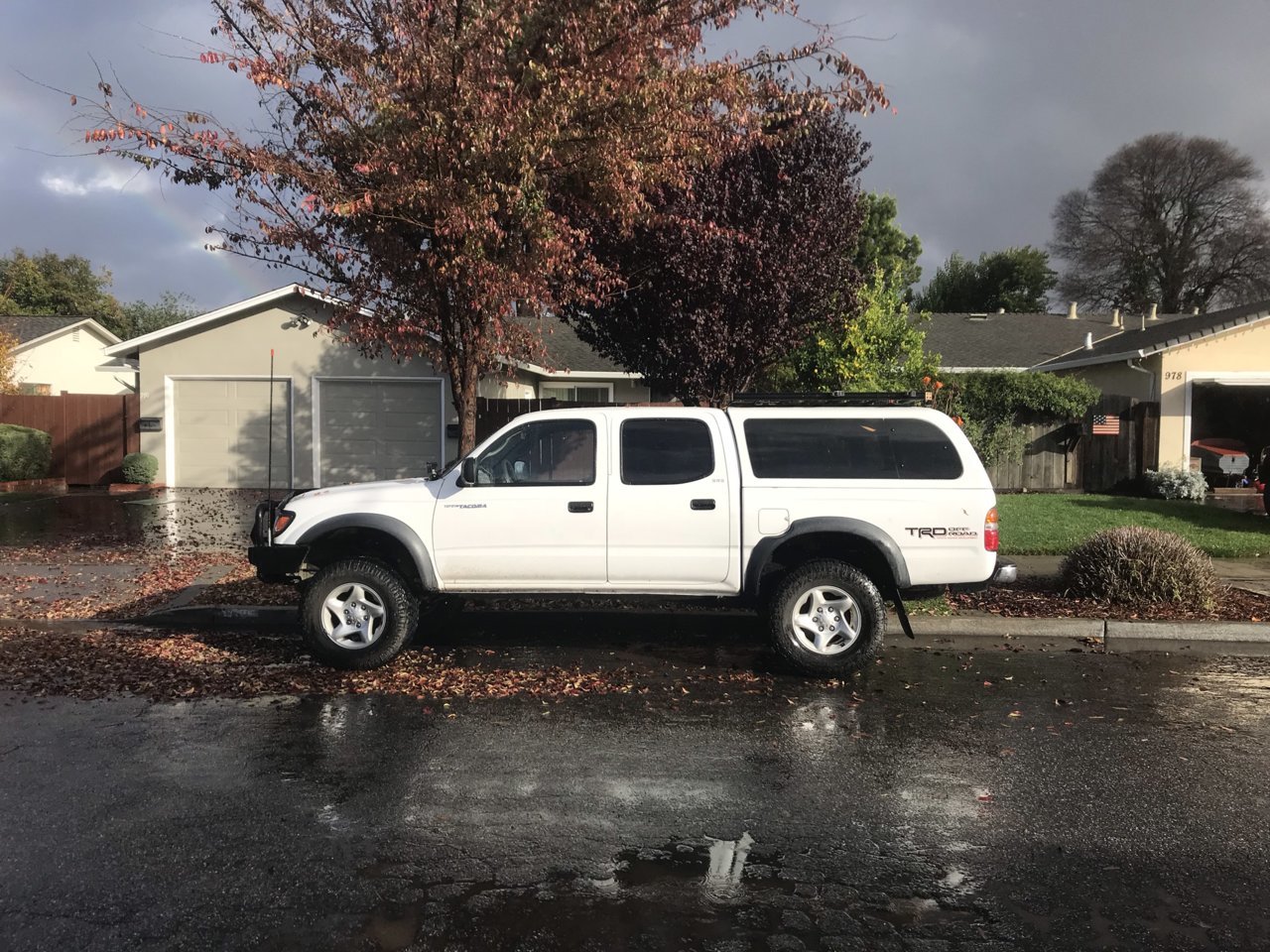

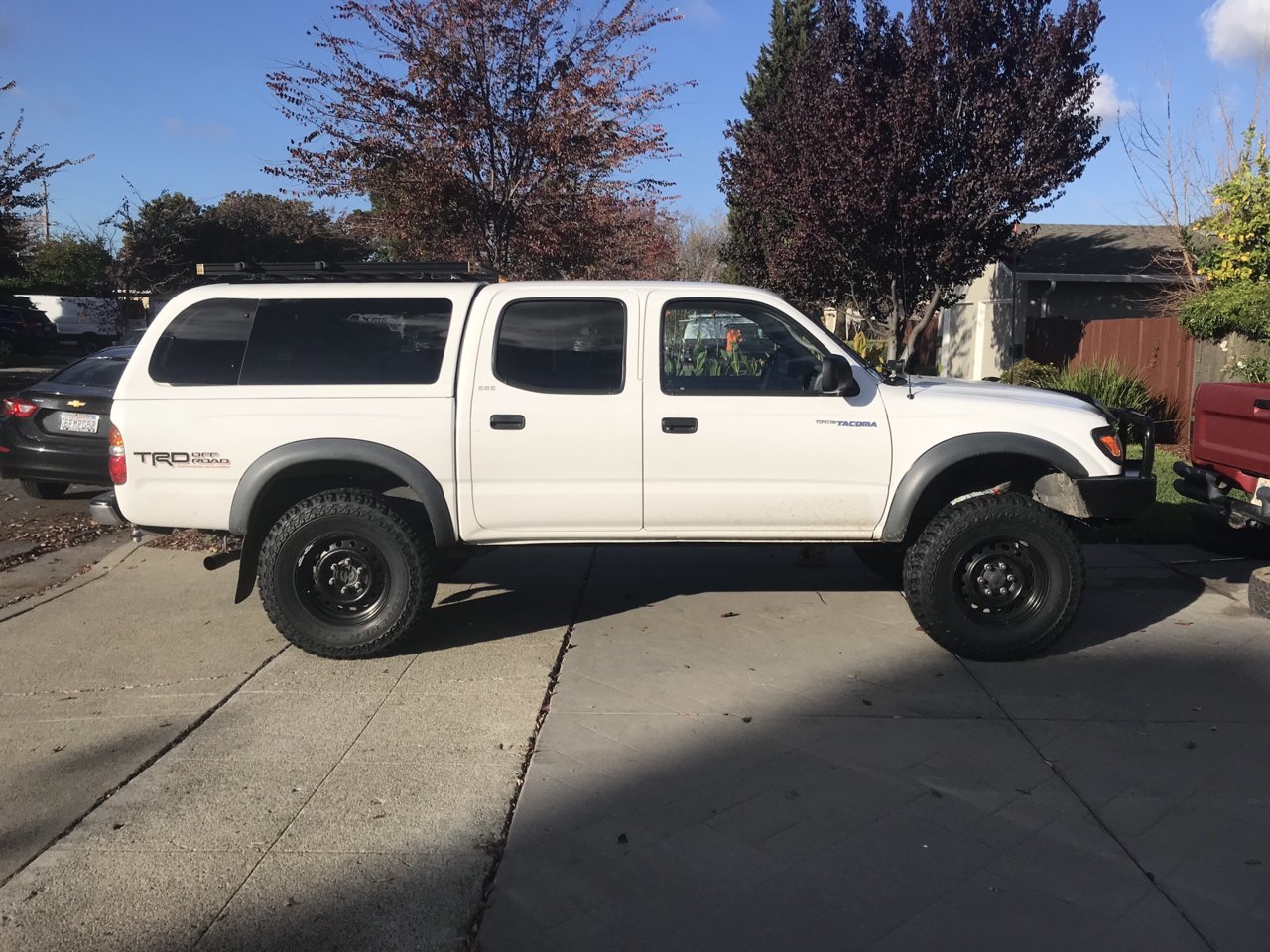

    New shoes!
    I only had to trim a little plastic... more probably to follow when I get them dirty for the first time.
    Also, My 92 pickup got some hand-me downs.
    Cooper Discoverer S/T Maxx LT255/85/R16 on new to me steelies.
    Before:

    Steelies and that tire, size and model, you have right there are the bees' knees my friend. I love the look

    Thank you cruiserguy.
    I first saw it on Freeflight7's Tacoma. He helped me out a lot with a tire size and rim recommendation.

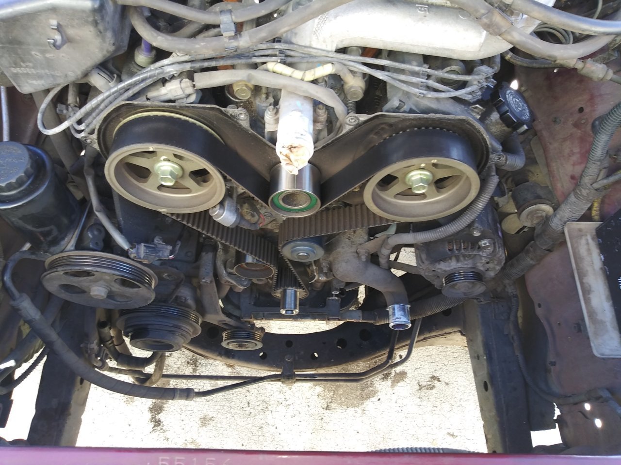

    3.4 TB/WP and stuff... 2nd one I've done... Took covers off and it was half'a tooth off from TDC. Lucky Me20181218_130624.jpg
    Then... I remembered the A/C compressor has to be unbolted so you can get it's bracket out in order to get the tensioner out. That was the least fun one.

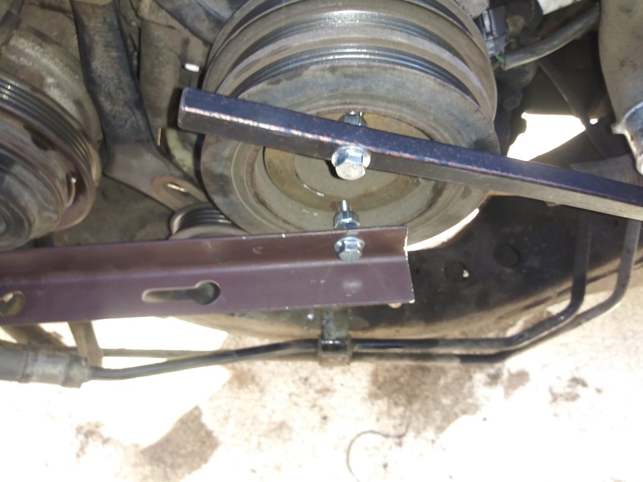

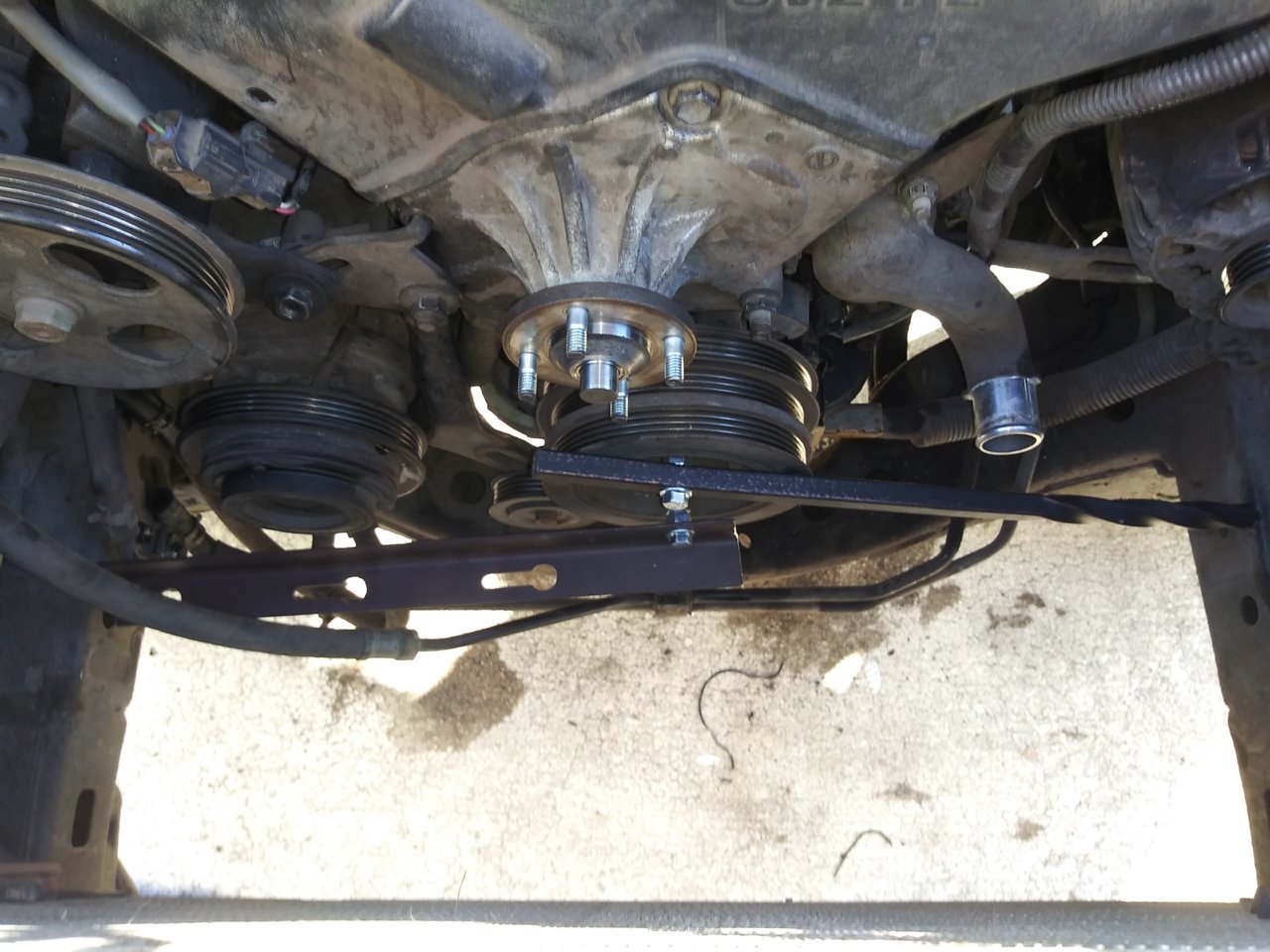

    Here's my homemade crank pulley hold'er tool... They turned out so clean I might do a build thread on how to make your tool out of your bed & stairs & stuff.... Ha j/k, I'm just resourceful, and.. cheap metal does still have a purpose right?
    This was reassembly, righty tighty... it was a lil tricky making sure they were both on the corners and wouldn't slide off of the frame. It worked to 215 ft pnds. They were reversed during removal.
    Oh and... Here's what it looks like when your timing belt is bout to break. 160k miles on it.

    huh mine didn't. I just rested it on the frame and torqued the nut down. No problem once its under load.

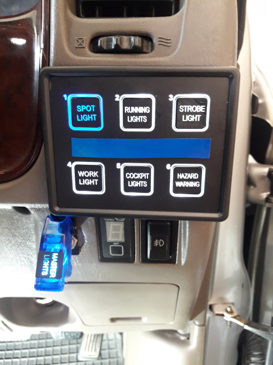

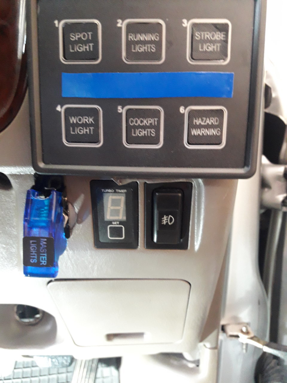

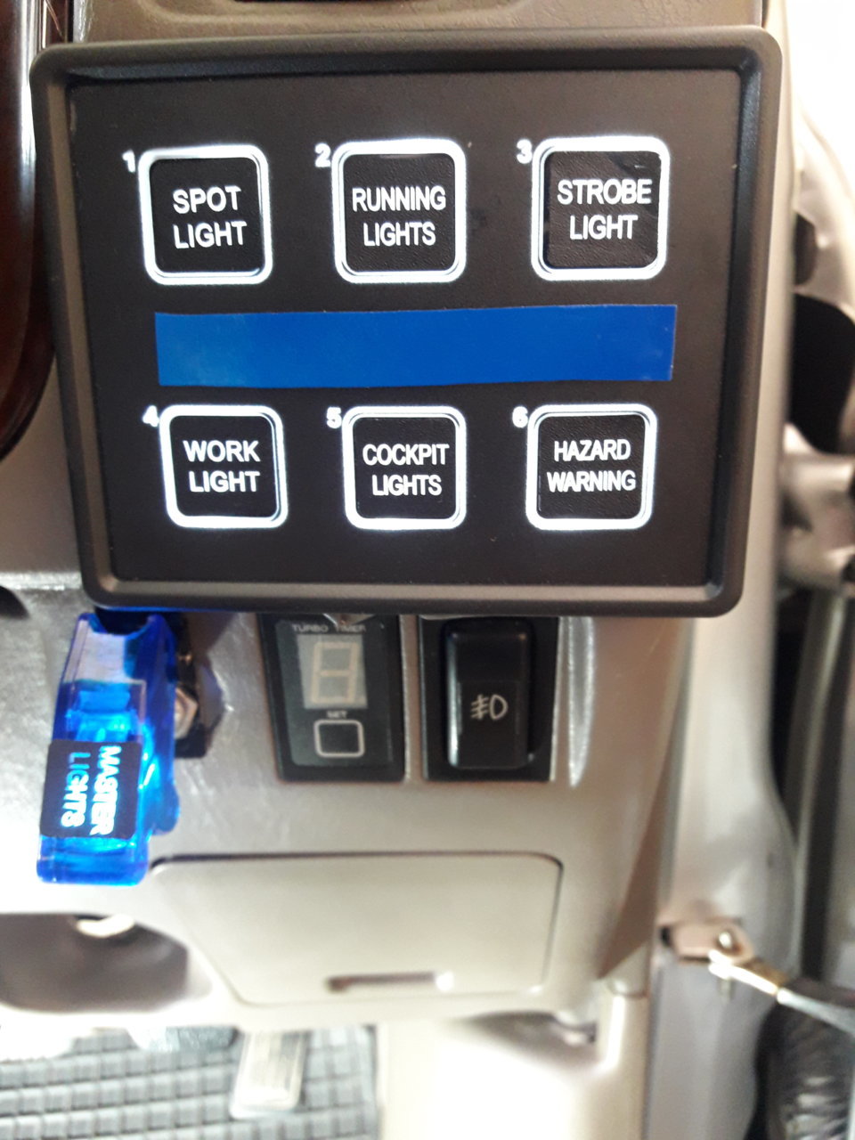

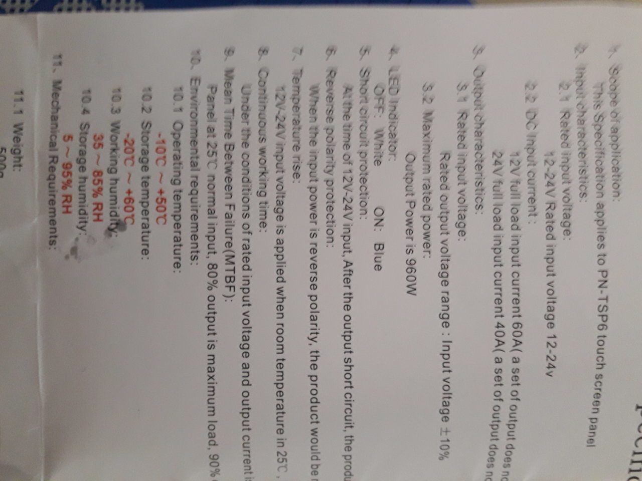

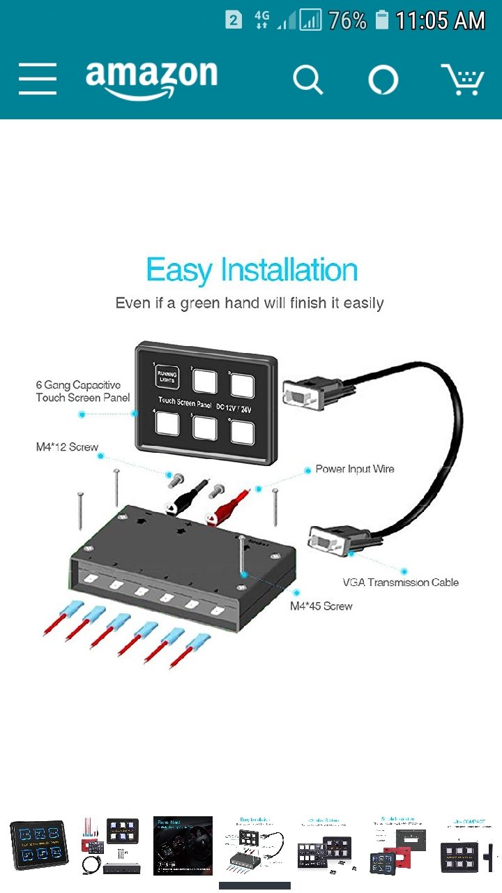

    Update, installed a master power switch.
    I connected my rock lights to it today it took 15 minutes. Most of my time installing lights is switches, where to put them then wiring. Now it is just ground wire at the light and run a oower wire. I ran an extra wire so the next set of lights will be alot faster. Blank no power to panel, white power to panel, blue accessorie on.
    The master is a heavy duty toggle switch.
    Spec sheet
