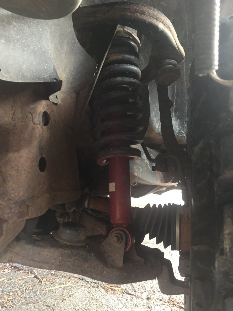

    Yup...it got worse...just went to lunch...super loud....anybosy have a link to these part numbers?

    The bearings? I ordered them for my Kings from Wheeler's, these guys - After I ordered, they called me and recommended I get some new snap rings too, which I did. I still need to get new misalignment spacers though. You might not need new ones but mine won't come off easily and I'll probably screw them up prying them out. They're cheap and good to have new ones anyway.

    yeah lube always made mine louder. Once the lube went away its fine. I just wash them now. Works way better.

    Thanks Gents. gonna order the parts. Pretty sure I should rebuild considering my driving habits offroad.
    I appreciate the quick feedback and responses
    I hit the pressure washer place on the way home after my last trip and a few days later again. that's when it got bad. We went thru some nasty mud on the last trip

    for me, my bearings get the loudest after I hit them with a pressure washer to clean all the dirt out. Once I spray some Tri Flo in them they get quiet again for a week or so. Been repeating that process for awhile now, I keep putting off replacing them but it's getting to where I think I should prioritize it.
