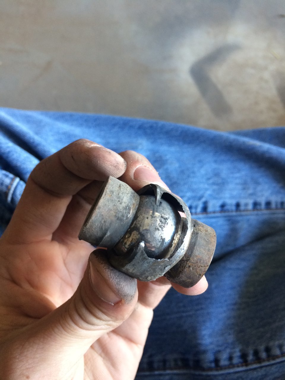

    lucky me, I get both :bananadance: specifically though, it's usually the bushings/bolts squeaking in the main eyes and shackles. I've replaced all but one so far with the Daystar greaseable bolts which has helped.

    Anyone try packing around that bearing with grease to avoid contamination?

    Finally changed out my needle bearing for the ECGS bushing. Not too bad of an ordeal. Finally no more growling driving down the road!!

    Didnt know that was an issue on the 1st gens. What were the symptoms?

    On the outside of the grease, yes, but should keep the inside clean.

    Given those bearings are less than ten bucks, I don't think it's worth the hassle. :notsure:
    Just plan on getting one year out of the lower bearing if you wheel.

    Doesn’t seem to be super common on the 1st gens. Around 30-50mph it would have a sorta pulsing vibe in the front end. Put it in 4WD and it immediately stops the vibes. I’m running cheap aftermarket CVs so it possibly caused it to be a little worse for me. Ive got 882s with an ARB bumper and the cv angles don’t seem too horrible
