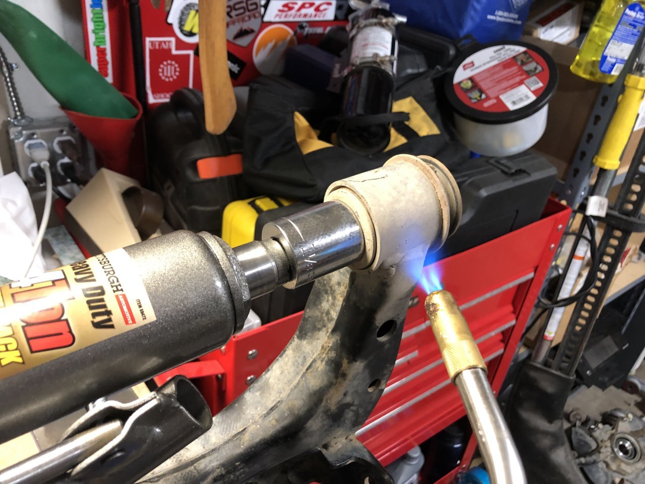

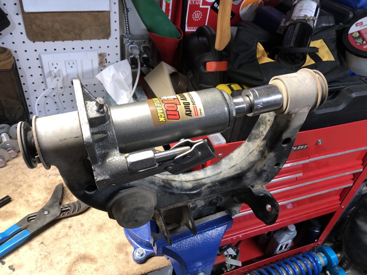

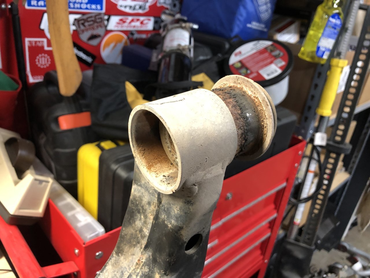

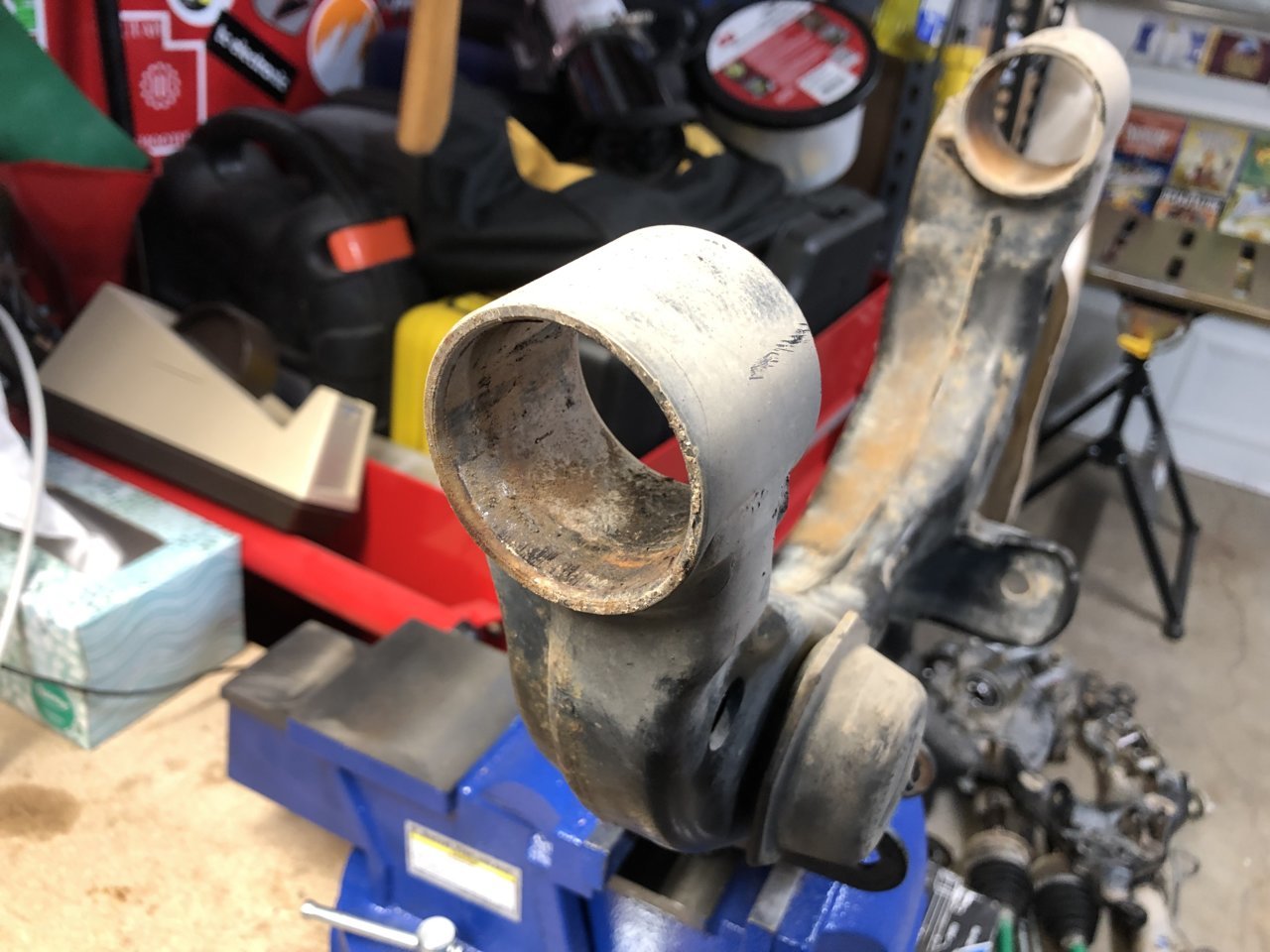

    Pressed out my old ass OEM LCA bushings in preparation for new Whiteline poly units. Used the bottle jack and torch trick that I saw in @Timmah! ‘s video and it worked like a champ!
    I also removed my spherical bearings from my coilovers so that I can swap in new bearings and clips from Wheelers. Super easy to do.

    I’ll have to remember that! I’ll replace mine at my 100k front end face lift.

    Nice, you'll love the whitelines. I noticed a definite improvement in how solid the front end felt, and less clunking noises to boot!

    Brilliant! I am going to have to file this away for future use.

    this is badass. why have i never heard of this. haha
