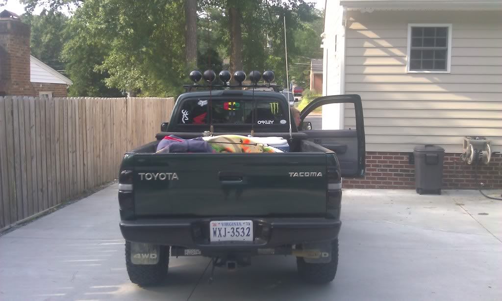

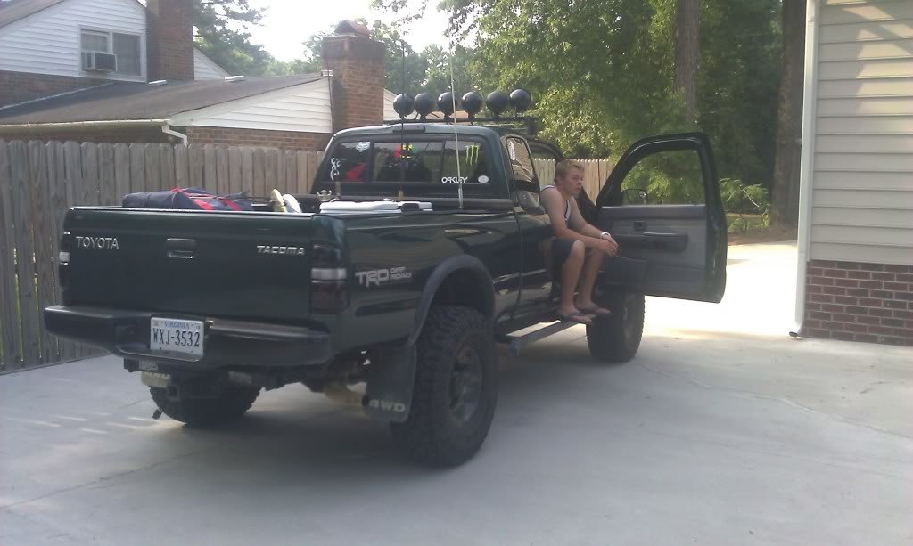

    couple of pictures before i left for virginia beach. added two pole holders on the tool box as well

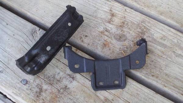

    Wire wheeled and the used the spray can bedliner on the mounting brackets for my new center console. Wasnt a fan of the rusty brackets. Also disassembled the entire console so i can paint/vinyl dye.

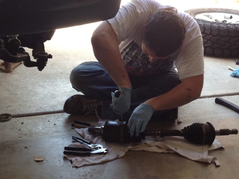

    Trying to replace my cv boots. Damn things look like they are pressed on, no snap ring to easily remove the star.

    By star do you mean the tulip that has the bearings on it?
    If so take a brass drift and hit the tulip down, it will expose a c-clip that you can take off then brass drift the tulip off and there will be one more on the underside that keeps the tulip from sliding all the way down. Remove that one as well (this is the one thats a pain for me since I think I need better c-clip plyers)
    The top c-clip is a thin one that should be pretty hassle free.
    Dont forget to put the c-clips back in when your done :D Looks like your in PHX too let me know if you need any help I've done a number of these :D

    Thanks. I had a cheap pair of c-clip pliers too. Couldn't get the bottom clip off to slide the tripod bearing down to expose the top c-clip. I called the guys at Phoenix Axle and they tried to walk me through it (damn c-clip pliers).
    So I threw them in a backpack and rode my buddy's bike down to them, $30 and 10 minutes later and they were good as new.
    Time to get a good pair of c-clip pliers.
