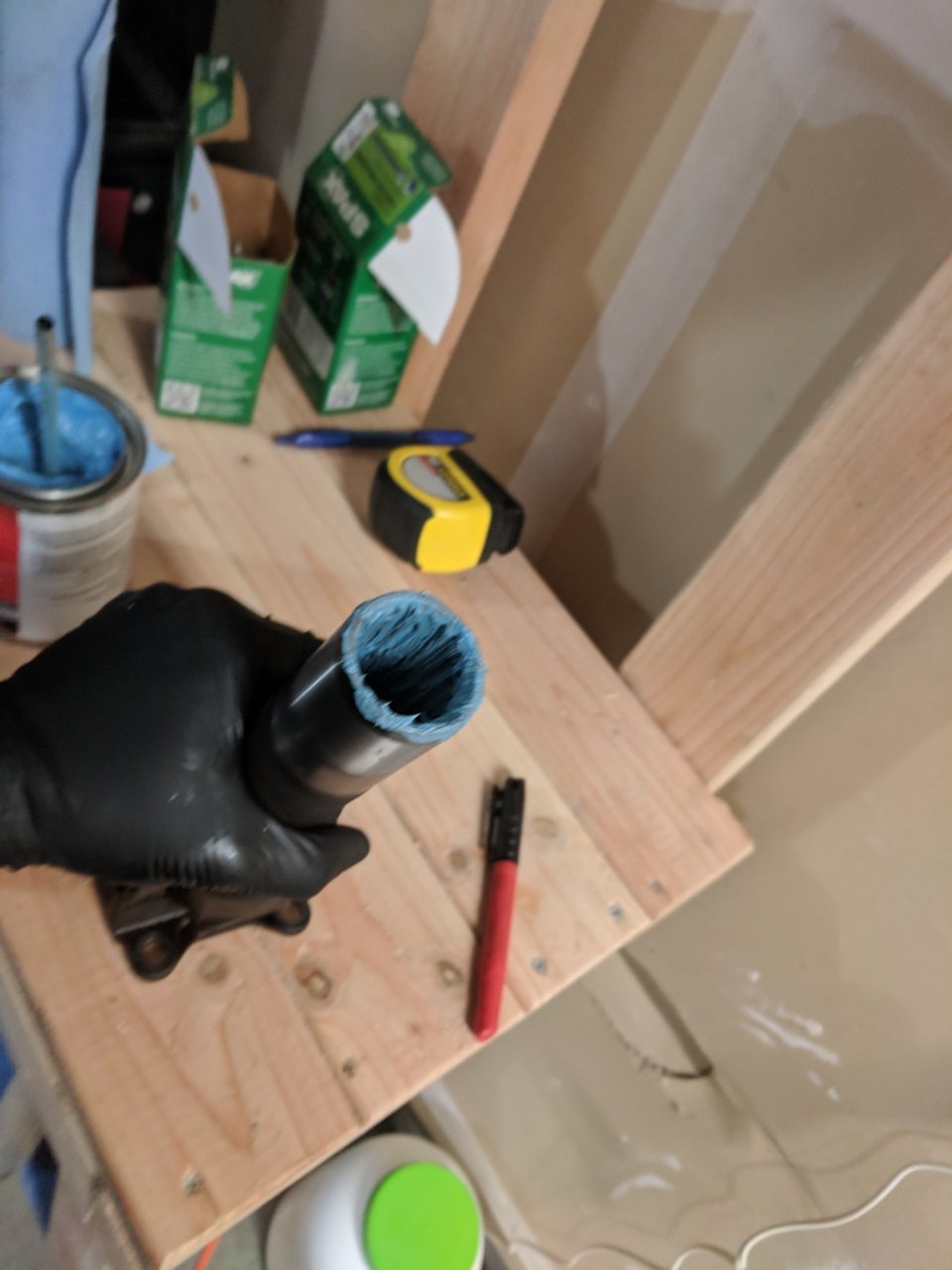

    Greased my shaft real good. Well, the rear slip yoke anyways. Liquid wrench night before and morning of lube job. 14mm bolts came off without much trouble using breaker bar. There was some green shit on the threads I assume Toyota put on there from the factory. Went with Ford XG-8 grease which is supposed to fix the start-stop clunk from the rear due to the slip yoke splines binding. Getting the slip yoke in my hand made me appreciate how stupid that grease zerk at the bottom of it really is; I put a bunch of red tacky grease in there previously and it was all at the bottom. None of it had made its way up to splines where all the older factory grease was. Speaking of, there was actually plenty of factory grease on the splines, but I cleaned it all out anyways to replace with XG-8.
    Match marks on the flange and shaft to keep everything lined up. Bungey cords to keep drive shaft from hitting the floor. Blue loctite on threads. Torqued to 56lbs. It actually wasn't that difficult to get a good torque CLICK as long as I rotated the drive shaft to a good position (used parking brake while applying torque). Quick test drive around the block and the drive was noticibly smoother while coming to a stop and starting again, but I'll need to drive it around a bit more to see if the blue teflon grease from Ford really does the trick.

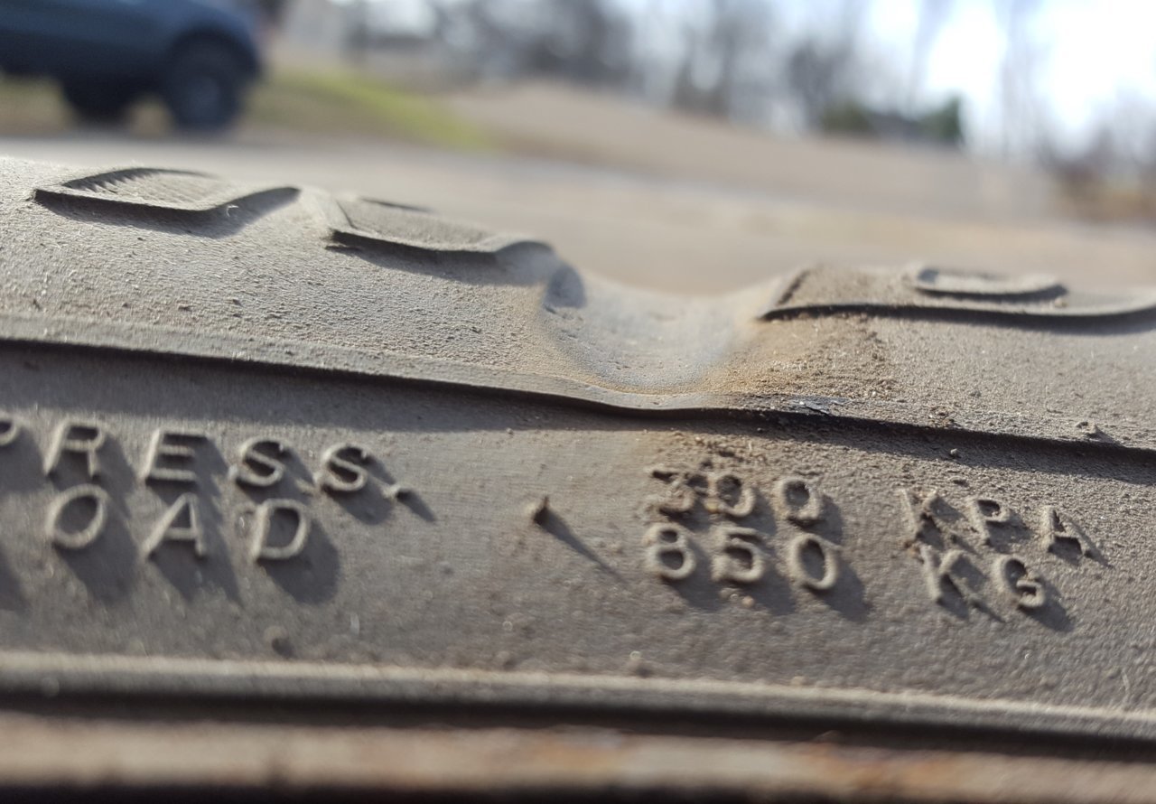

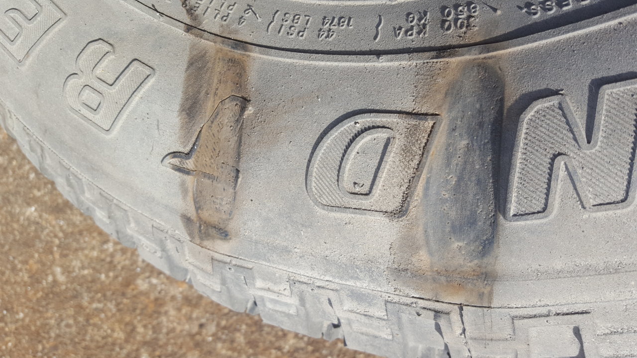

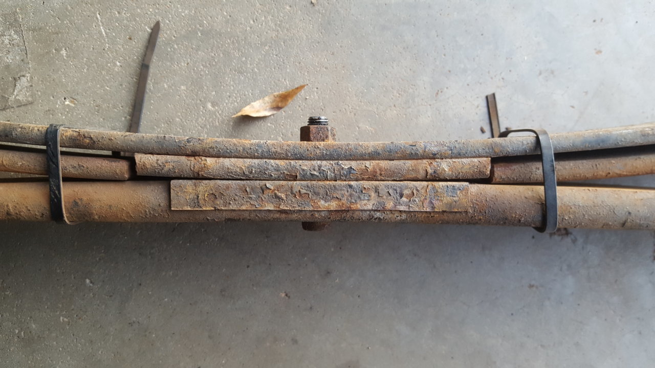

    A few months ago, I bought a wrecked 95. I have been mainly just getting it drive-able. Tonight, I began getting around to some neglected items the PO hadn't taken care of when he wrecked it. Just pulled the left rear spring due to one of the leafs being broken(like the plastic ties he added? :rolleyes:) .
    What I wanted to pass on was what I found when I dropped the spare to access the rear shackle nut. The spare had been sucked up so tight, it ruined the tire. Just an FYI, apparently that little gear in the lifting wench can really withstand some torque!
