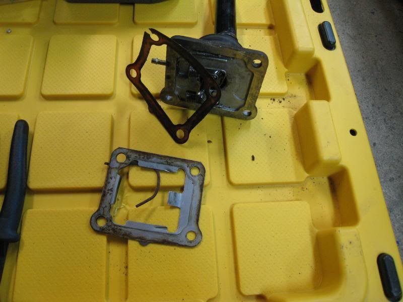

    Can someone tell me the part number for this gasket that goes under the transfer case shifter for a 98 I cant seem to find itIMG_5077_8624c77b4c711e5ae303723c860b55469b99dc46.jpg

    This is what's listed for my 99. Should be the same for your truck.
    GASKET, TRANSFER CONTROL SHIFT LEVER RETAINER
    Part Number: 3634535050
