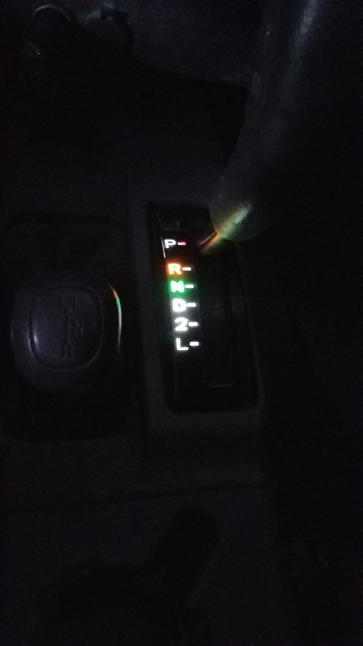

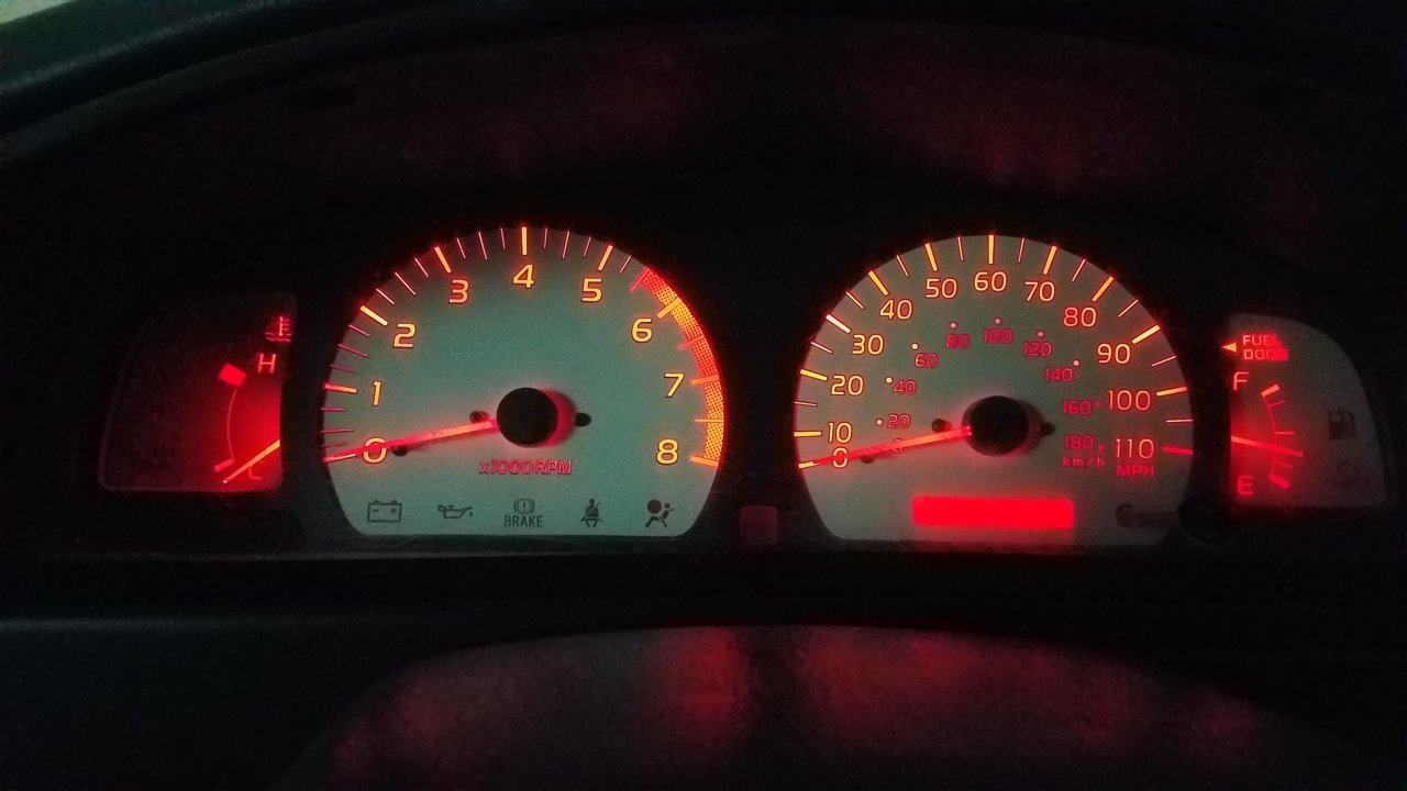

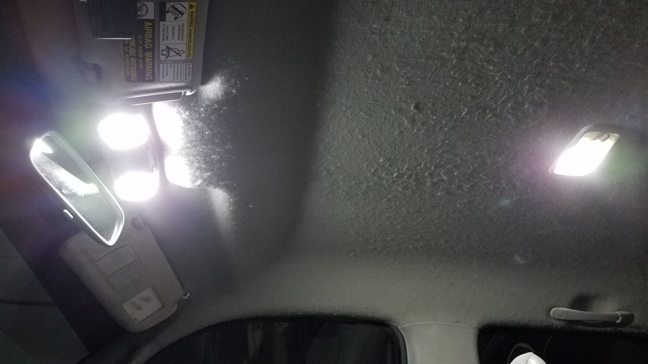

    i did the red led dash, white led shifter, and white led overhead lights today. didnt do the heater controls yet. the circuit board was broke when i pulled everything apart. so gonna need a new one to fix that.
