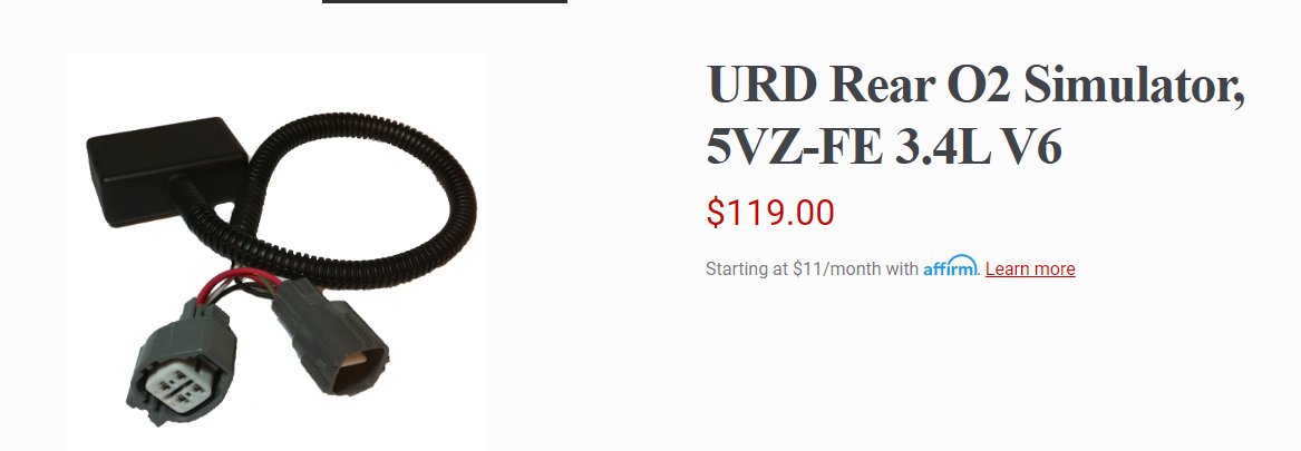

    Yup, had the same thing happen two different occasions. 1st time, truck was still under warranty and actual the first cat fell apart inside clogging the second cat. (~$1700 covered by the Dealer). Second time it happened, I decided to hollow both out, theyve both been hit so who knows if the cataylst inside had been broken again. Then picked up https://www.urdusa.com/urd-rear-o2-simulator-5vz-fe-3-4l-v6/ upload_2019-1-2_15-1-23.jpg
    You still need the both sensors, Front is MAF rear is just a normal O2 but is needed in good working order for this simulator to pick up the reading and adjust accordingly to not throw a CEL light.
    Had mine for quite a while now, 6-7years?, 10min install and passes every 2 years when MD has emissions tests. And 1996 and above vehicles do not need a "sniffer" style test to pass, just a simple plug up and test via OBD2.

    damn I didn't know URD sold those for our trucks, just thought they were for 2nd gens.
    ToyRyd04[QUOTED] likes this.

    Yep, nice plug n play setup underneath passenger side seat carpet out of the elements. Been super reliable without any issues.

    they made that for our trucks before any 2nd gen version by a long ways haha
