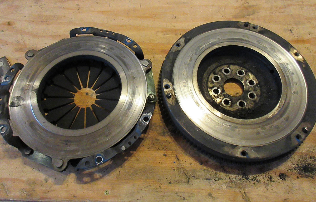

    ouch, lots of heat spots too.

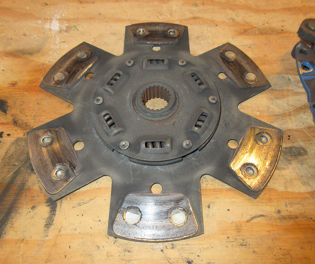

    Unfortunately not too uncommon on a ceramic clutch, they tend to wear out the flywheel and pressure plate before they wear out

    You would think the clutch disk would last a long time, but mine only lasted three years. I read somewhere that ceramic clutches wear out quick if you do lots of slow gentle starts. Well that's all I do, both on and off road. I really don't think it was the right clutch for me. Glad to be rid of it actually.
    I almost have everything back together, but had to come in for some lunch. Just have one shift lever to put back on, and button up the inside. Then the drivelines and done. I spent a half hour trying to find one of the inspection plate bolts I dropped. Had to take my skid plate off and finally found it buried in some mud on top of my front dif.

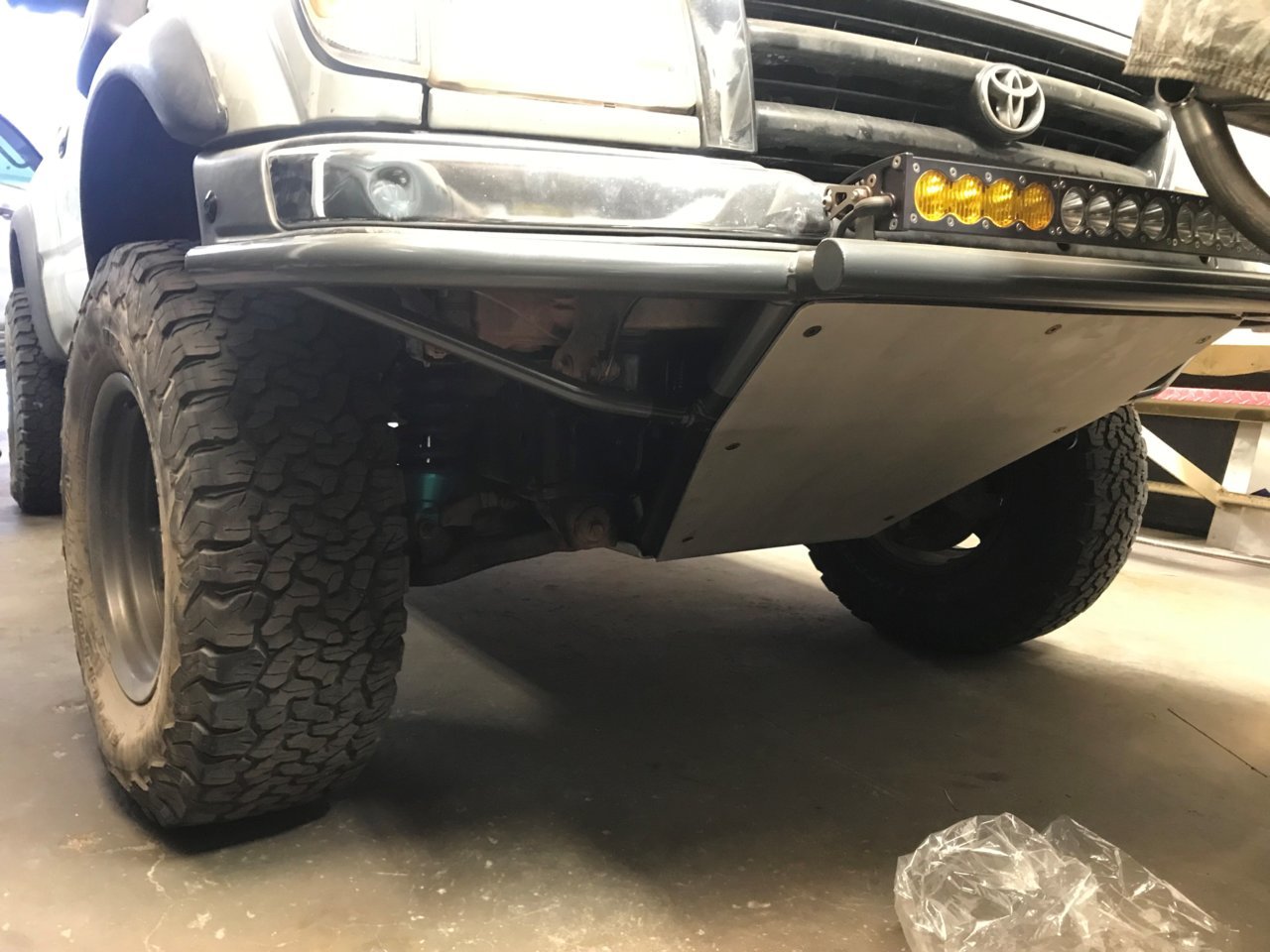

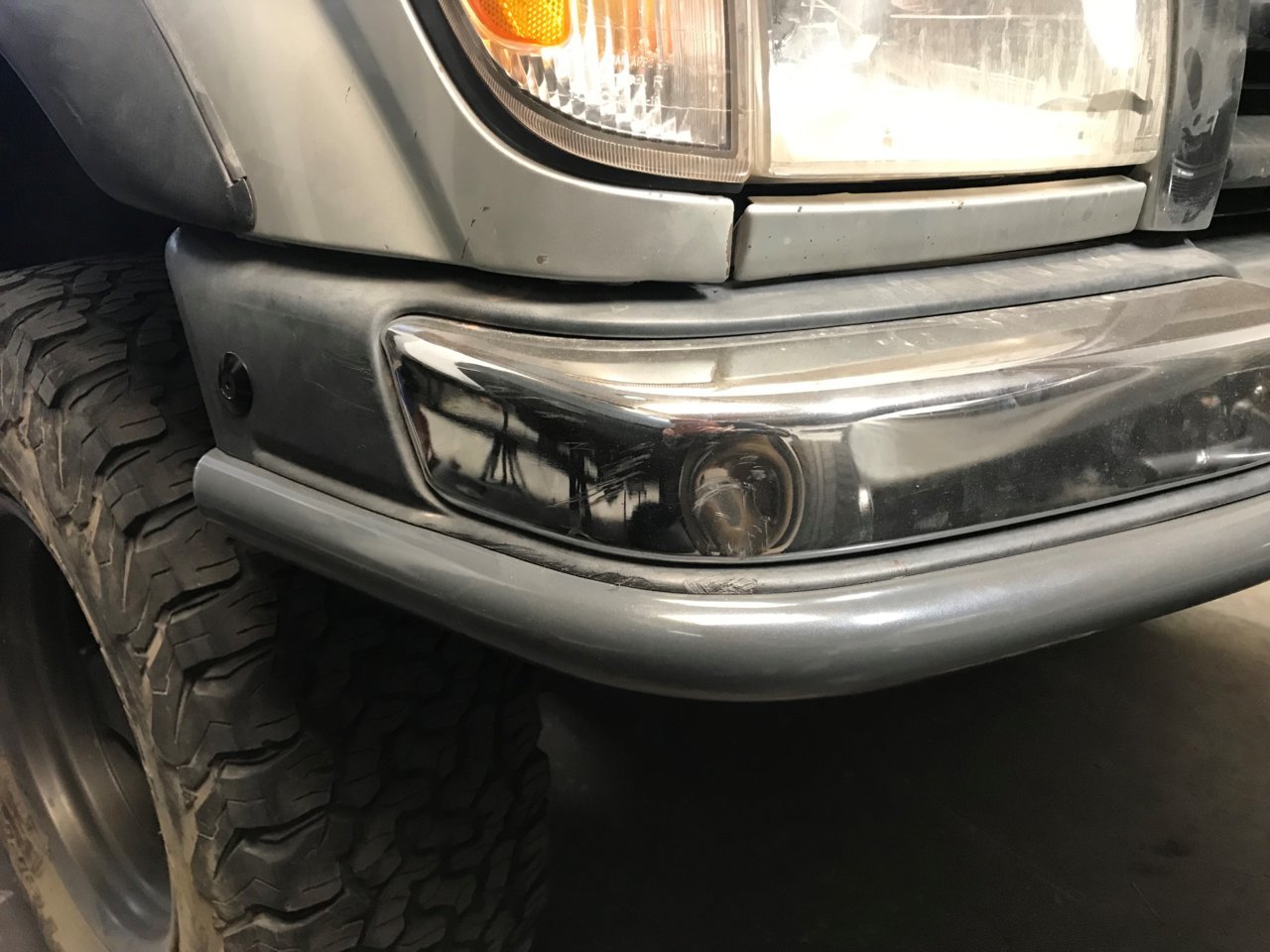

    I dropped my shocks off so my fabricator can get started on the @ARCHIVE rear shock relocation kit install. Grabbed some updated pictures of the front bumper build we just wrapped up. Not loving the light bar placement now that it's all together, but that was my input, not the fabricator's lol.

    They do, they're high clamping force and they act like a lathe if you slip them. You treat them almost like binary, build enough revs and full release. You can still start softish, but you can't ease them out slow or you'll turn the flywheel like a brake rotor.

    Hawt, almost looks like the bar would’ve fit perfect between the two chrome pieces
