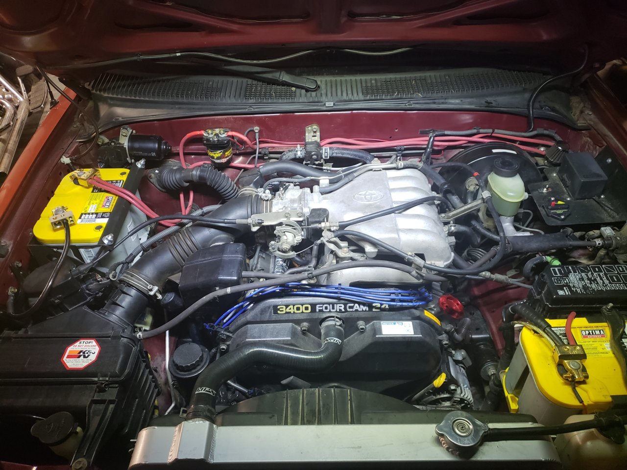

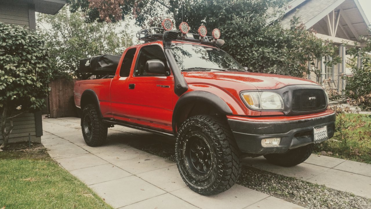

    Yea doesn’t seem too crazy, watched the Timmy the Toolman video.. I have all the tools/parts and am about to do it in a couple weekends.. also adding an additional inline trans cooler & replacing the aluminum coolant inlet/outlet on the engine due to corrosion.
    Went and took a picture of my rig today..

    god i wish my engine bay looked that clean... oh wait.. i dont have an engine bay right now.

    I had the engine steam cleaned / power washed about a week ago because I was going to do the valve covers this weekend.
    I also had him steam/power wash the under side of the engine/trans because I'm about to start the 4x conversion.
    I think it's probably the best 90 bucks I've spent on the truck lol.

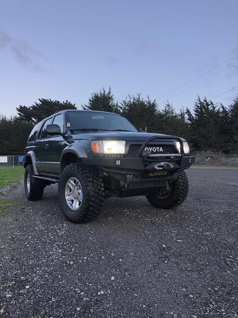

    New TYC headlights and all pro front bumper with full skids installed today. Coming together
