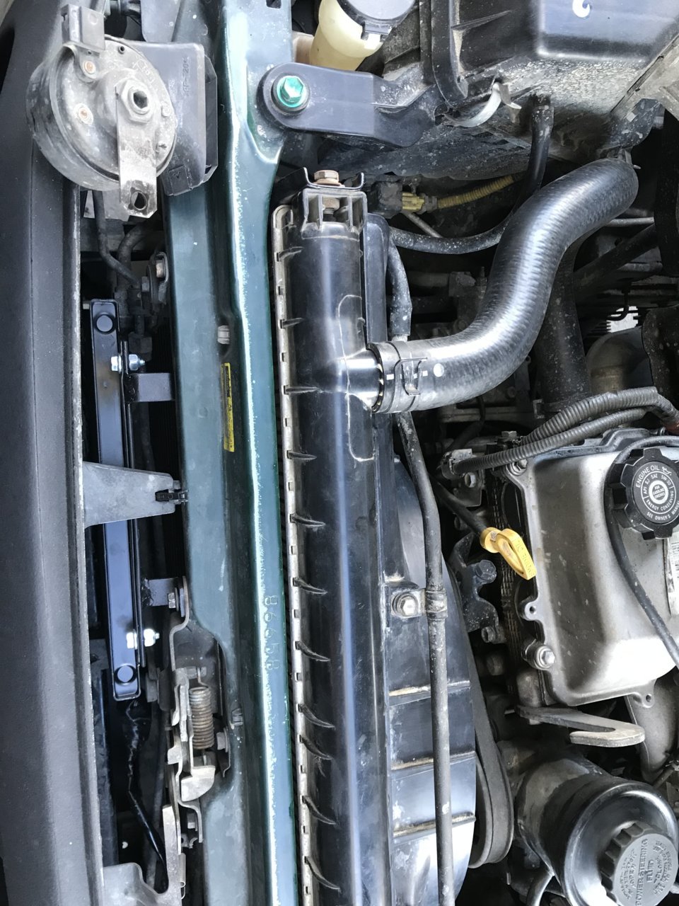

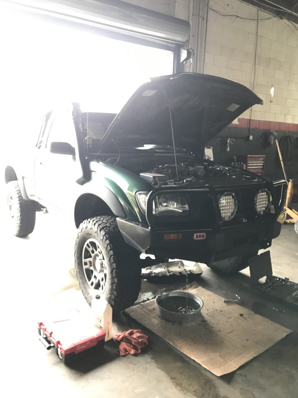

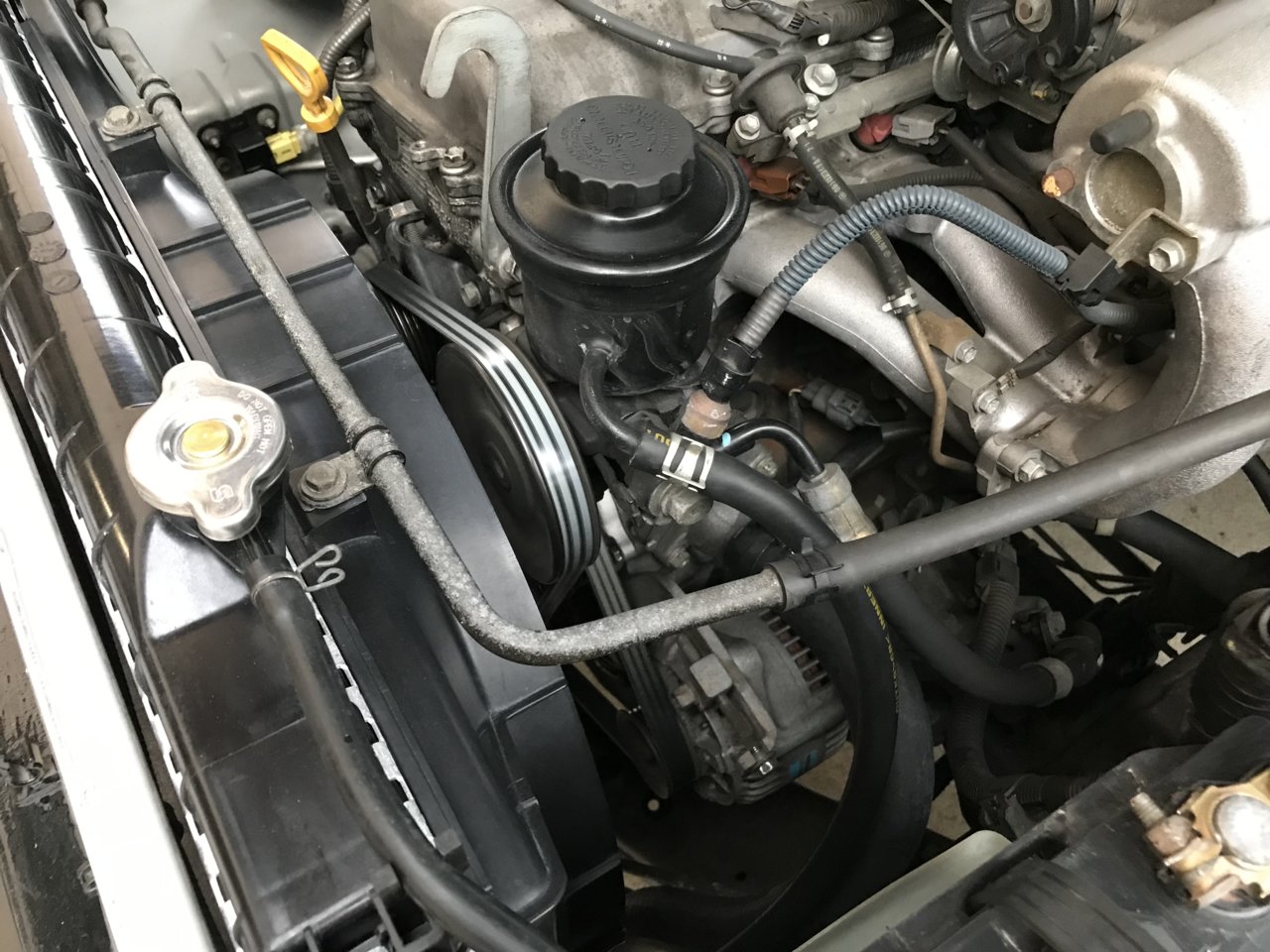

    Replaced cracked radiator with a new Spectra and while I had everything out I replaced the 3 belts, fan clutch, water pump, thermostat, and plugs.

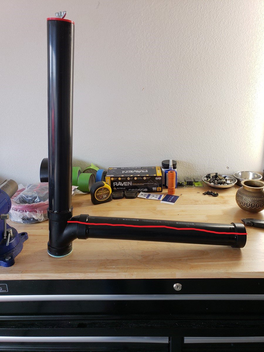

    Built a new reservoir to relocate my already relocated washer reservoir. Wish I knew about this style before but oh well. Plan is to free up the space on the fender well to put my air compressor there and not have to ditch my cruise control. Just letting everything setup for a couple hours before doing the install. Thanks to @cbechtold and @Blackdawg for the idea and info on this from their build threads.

    This looks interesting. Where can I find more info on making one?

    Before you install this thought id let you know you will have a good size air pocket because of the way the Y is installed. If you flip it around you eliminate the problem.
    But here is a picture of where the air pocket will be formed.
