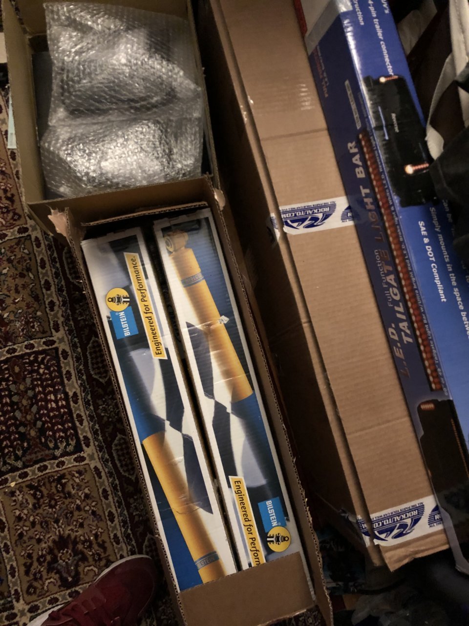

    Feeling like a little kid on christmas:D9AFFAA41-5933-40E1-B263-7AA6DFE93D5A.jpg
