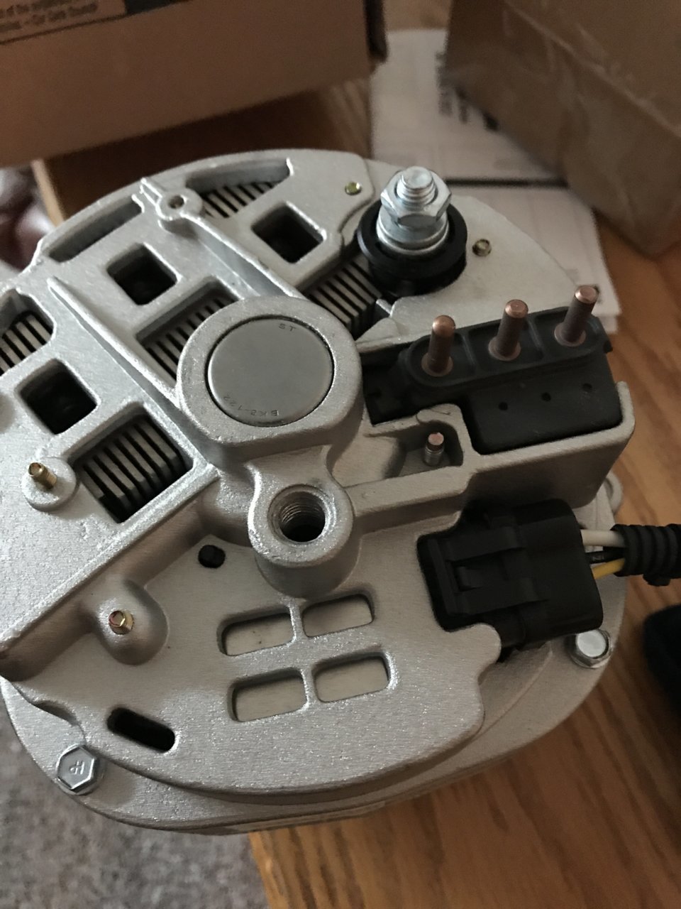

    For those that have done the CS144 upgrade. What are the 3 prongs for? I’ve already plugged in the adapter to the Toyota plug

    I've never seen those prongs on a GM alternator. Or any other manufacturer for that matter. Maybe its for a new style dual rectifier. :notsure:

    Thats for the wind sheild heater for the Cadillac it was designed to fit in. Thats why its a nice alternator as it has such a high output at idle for that reason.
    Just put some E tape on them and you're good. Probably won't hit anything anyways.

    Awesome thanks! I’ll do that just to be safe :thumbsup:

    Get you some vacuum caps to cover them
