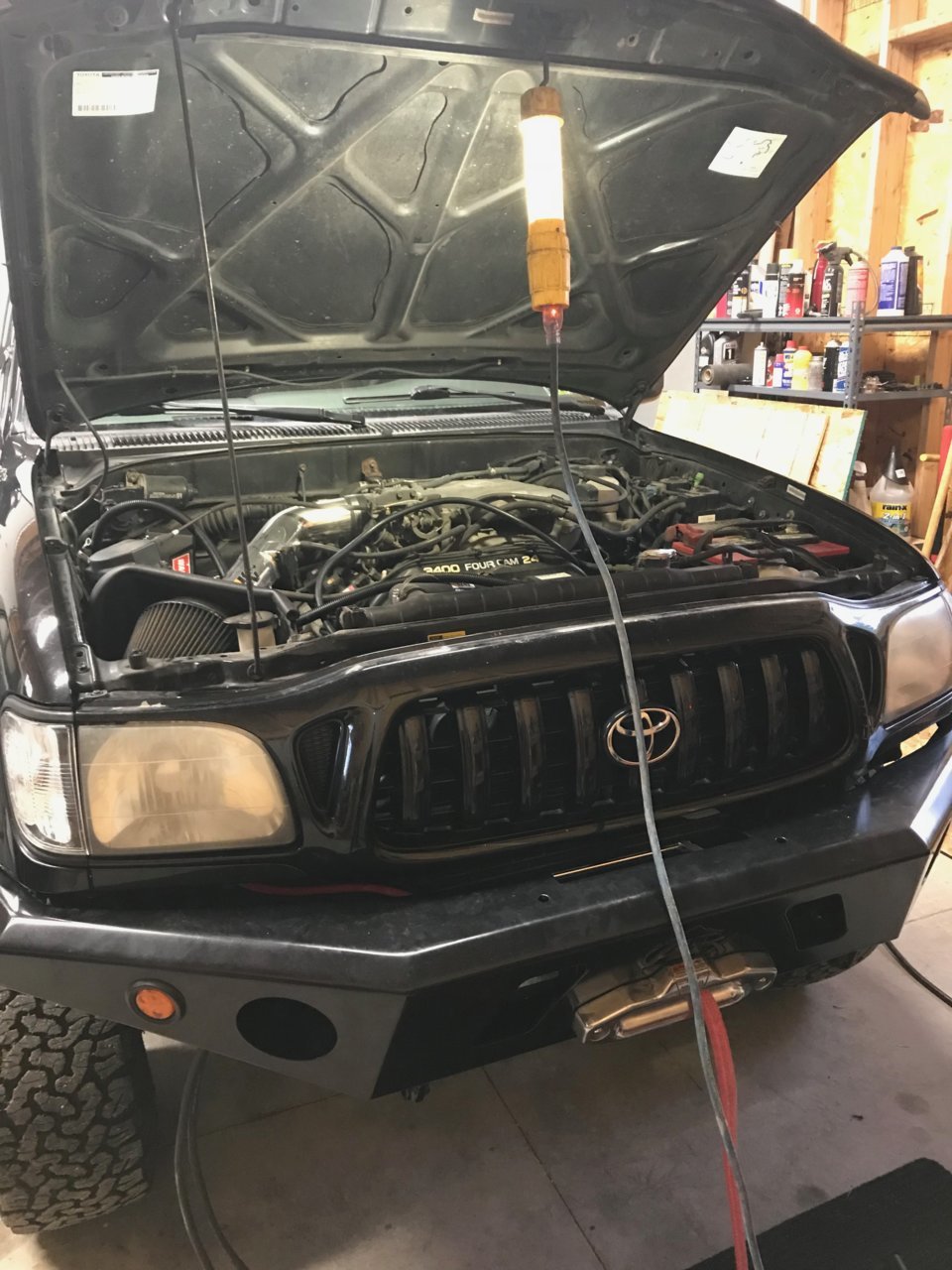

    2001 Black Toyota Tacoma 3.4L SR5 TRD
    K&N Intake, JBA Headers, URD O2 sensor simulator, custom exhaust, magnaflow muffler, Allpro Apex front bumper and skid plate, Toytec 3" lift, Total Chaos upper control arms, Micky Tompson classic wheels, BFG all terrain KO2 tires (32"), voltage meter in dash, painted dash to match exterior,
    Installed a Warn m8000s winch and some KC spot lights

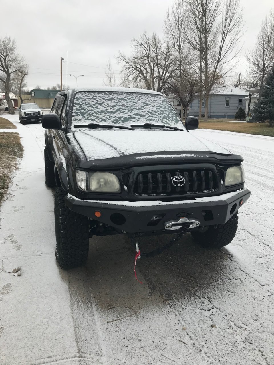

    My Rear King 2.5" with resi just came in so getting ready to have them installed.
    When I first put on my King Fronts and Dakar leafs, the measurements were as follows:(Center of hub to fender flare):
    23.75" driver's front
    24" on passenger front
    24.25"driver's rear
    24.75" passenger rear
    It has been about 12 weeks and the measurements have changed quite a bit:
    22" drivers front
    22.5" passenger front
    23" drivers rear
    23.5" passenger rear
    The on-road ride is actually no smoother than what it was stock which surprised me to be quite honest.
    With that being the case, I have 2 options.
    OPTION 1: should improve ride
    The first is to remove the 3rd leaf to soften it up.By doing this it should drop the rear by about 1/2 " on both sides
    From there, I would need to raise the drivers front by 1/2 inch
    From my less than stellar math that would leave me at the following measurements:
    22.5" drivers front
    22.5" drivers rear
    23" passenger rear
    (still has lean of 1/2 inch)
    OPTION 2: would make ride rougher yet.
    Leave rear leafs as is and raise the drivers front up 1" and passenger front up 1/2" which would leave me the following measurements:
    Drivers front 23"
    passenger front 23"
    Drivers rear 23"
    Passenger rear 23.5"
    would love some insight or opinions on which way to go

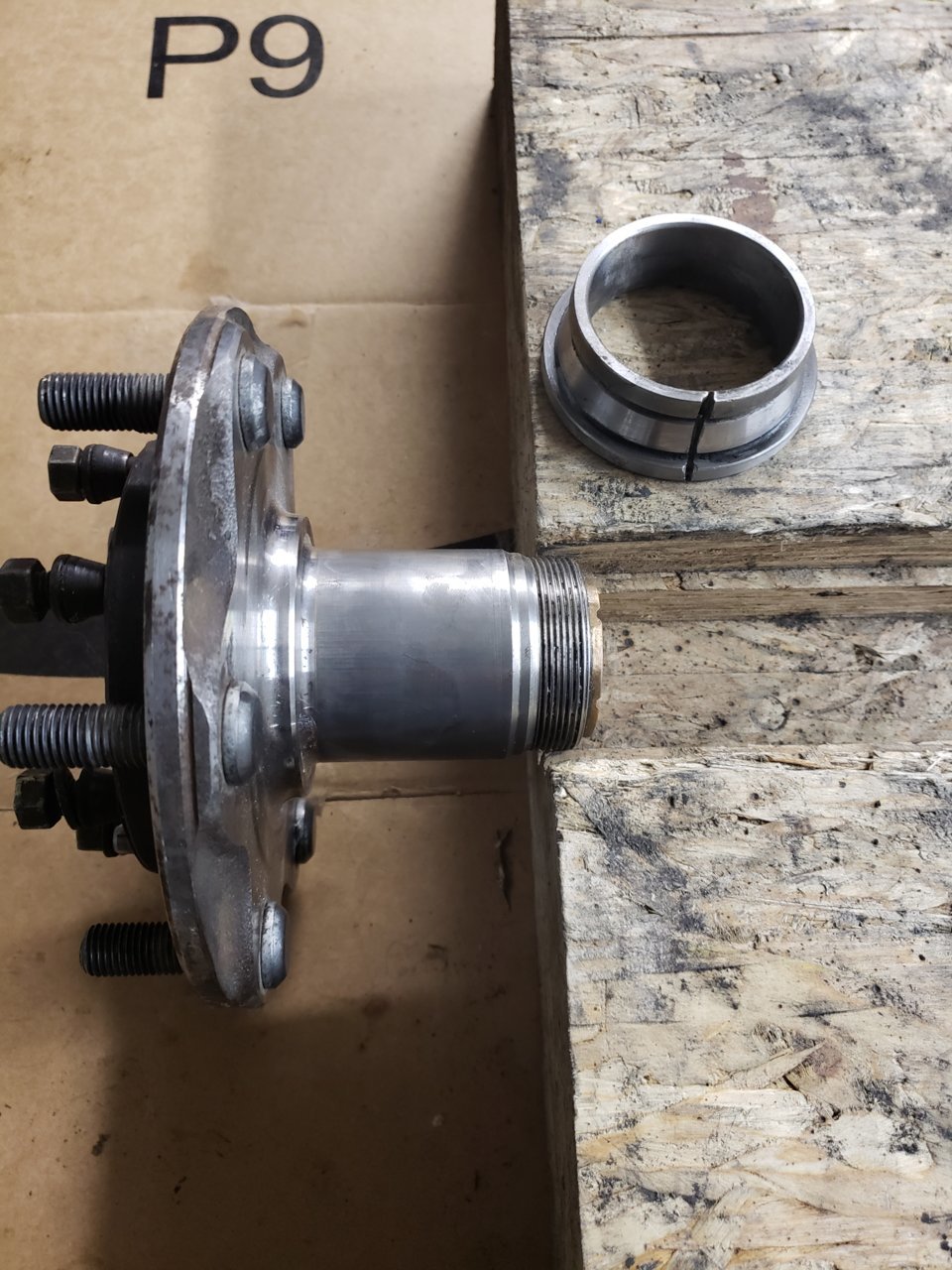

    Well, that went SO much better than I thought it would.
    About 5 minutes with a Dremel reinforced cut off wheel and 10 taps with a cold chisel.

    Yep. I fretted about it first time, longer than that

    You could get the kings re valved more custom to your liking. What weight spring are you running on the coilovers?

    600 lbs coils. You can see how much they have already settled

    Whatever you do I wouldn't raise the front if you don't have to...another inch worth of preload on your Kings will make the ride way stiffer in the front. How much front lift do you have with them now?
    Surprised to hear the Dakars are stiff...when I had them the only thing I liked about them was how smooth they were, even with an AAL added they were smoother than the Expos I have now. The All Pros are pretty stiff but they hold weight much better than the Dakars did.

    I was getting roughly 3" of lift initially but it has already dropped to just 1.5" up front. May need to increase coil weight to get a little more lift without pre-load
