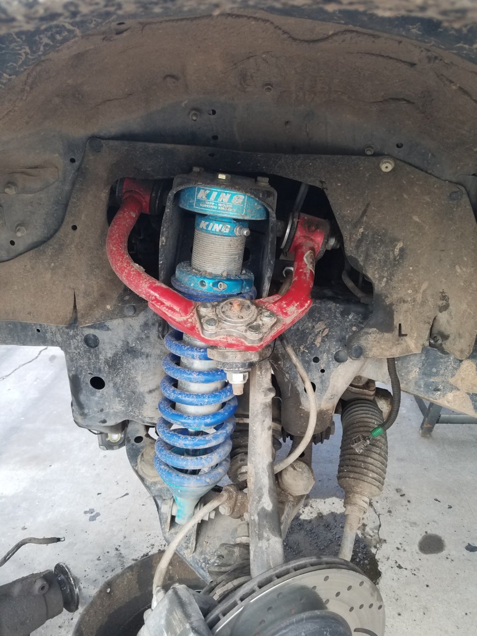

  1. Jan 21, 2019 at 8:51 PM
    Speedytech7
    Feb 20, 2014
    #123587
    58,015
    FCQM+VG Cheney, Washington
    It's less Tacoma and more mod
    My flutter stack makes me the happiest. Although it is admittedly stiffer on road than stock kings haha
  2. Jan 21, 2019 at 8:53 PM
    Blackdawg
    Blackdawg Dr. Frankenstein

    I cannot read the lettering on my springs, but I do know the pre-load is way to much. I am running an ARB with a Warn M8000 winch and full skid plates. What spring should I go with on my Kings?

    Yeah yours is a hoot to drive. Maybe get be. Idk haha be interesting just as it's solid axle all around too.
    Likely 600s that's what they come with standard.
    650s at least up to 700.

    Holy preload Batman...I'm guessing 650# is the way to go

    Who makes the best spring to replace them? Or just keep Kings?
  10. Jan 21, 2019 at 9:04 PM
    Speedytech7
    Feb 20, 2014
    #123587
    58,015
    King springs aren't particularly expensive but any 14" coil for a 2.5" shock should work fine.

    Kings are fine or eibachs

    This makes me wonder if I need different springs for my lt set up

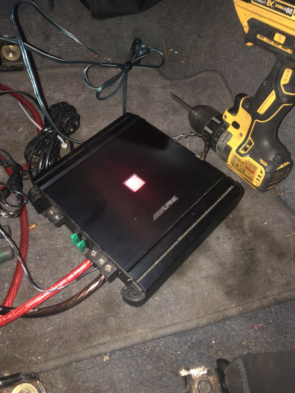

    Anybody here know much about alpine amps. My mrp-m500 isn’t working. All the wiring to it is good, I tested another amp I have with the same wiring and it’s working fine. I checked all the internal wires and didn’t find anything, Am I out of luck on this one?

    Did you verify both those fuses are good?
