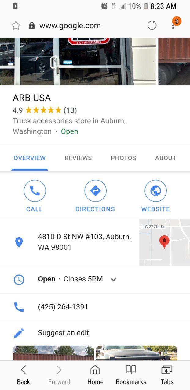

    Just got off the phone with them, and both springs should be the same length not like mine. Feel free to call them,
