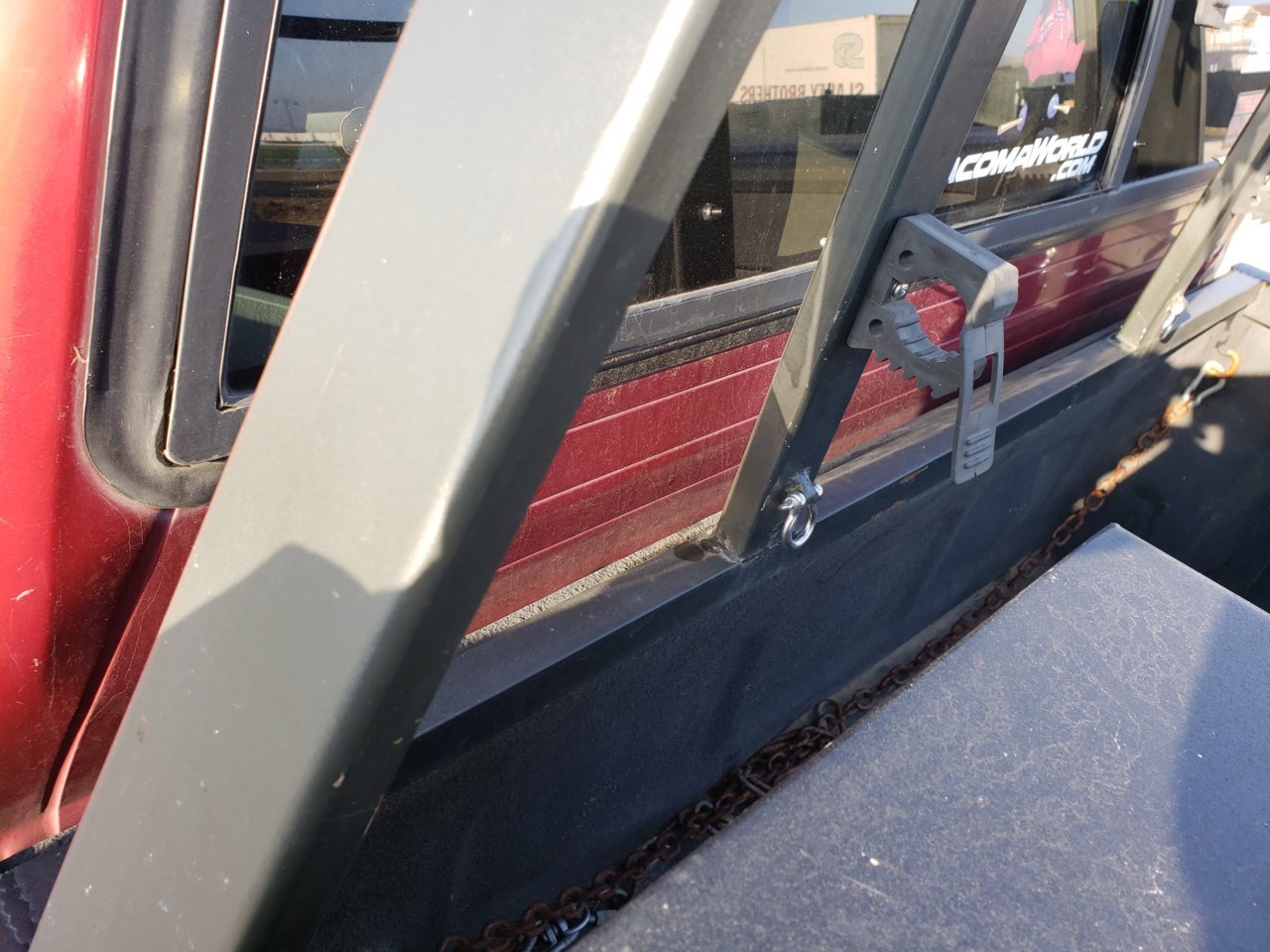

    This is exactly why I ran angle iron across the front with support bars.
    The vertical bars also ended up being a good mounting location for a shovel and axe.
    Now I need to figure out how to fabricate some bed side stiffeners at the tailgate. (The bed sides aren't splitting apart, but just for piece of mind).

    Vertical bars aren't really needed. But handy for what you used them for for sure.
    Since your bars run to the rear of the bed, could just be as simple as dropping it down from your rack to the floor of the bed. However the floor is very thin too so wouldn't expect much there. It bends pretty easy.

    The vertical supports were to take a bit of the load off the actual legs because I made them /\. But in reality the amount of contact they make to the upper platform of the rack, there's really no chance of the weight pushing the /\ legs outward... So the supports turned in to a bit of an overbuild that turned in to a good spot to mount shit lol.

    Love the rack. Nice job.
    What size did you use for the angle iron?

    I used 2x2 for the bed rails, full length.
    And 1x1 for the rail that crosses the bed at the cab.
    Necessity is the mother of invention. I wanted a RTT rack, but still wanted the side boxes to be able to secure items a bit more if needed. No one makes a rack like that... So I said f it and borrowed my buddies cheap welder and figured it out... That rack is the first thing I actually welded in my life.
    The boxes also make a good place to mount shit... Lol
