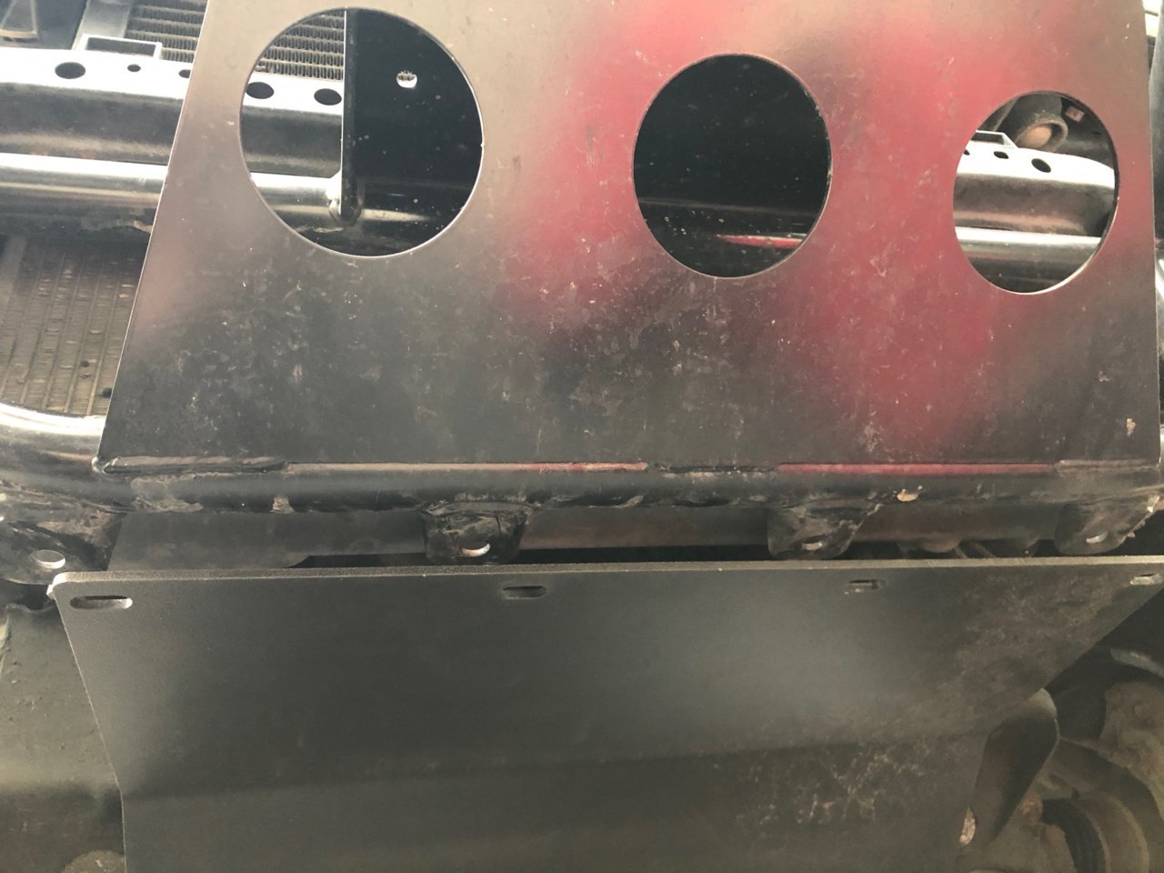

    I'm just trying to get skid plates that properly mount up to my truck without me having to spend money on modifying them.

    Mine are like really really off...

    Is that about an inch in height off?
    Or is it just the holes don't line up?
  10. Jan 25, 2019 at 11:20 AM
    Teke

    About an inch to the 5 oclock position if that makes sense
  11. Jan 25, 2019 at 11:21 AM

    So the height is okay, the skid plate touches the mounting points.
    The holes don't line up and its 1" too far towards the back of the truck?

    Correct. If I bolt those 4 spots up it hits the steering rack and the rear bolt locations don't align.

    Shiettt. It sucks but doesn't look hard to fix. I wouldn't pay more than 100 to have it fixed .
    I'd just see if you could get that money back from all pro or whatever it is now. Then spray it with black paint. Will match easy with ur PC.
    But if you wanna keep arguing for months go for it. Up to you

    Are you trying to mount it to stock locations? I think All Pro skids only line up with All Pro bumpers.
    I'm pretty sure the All Pro bumper hangs down farther.
    *Edit* I couldn't tell at first but looking again, I think that's an All Pro Baja bumper.

    That is the AP bumper in the picture, the guy I have been talking with claims that since AP didn't use "perfect" jigs before TG acquired them they have had a lot of these issues where the stuff they are now making and selling does't mount up properly to other products. o_O

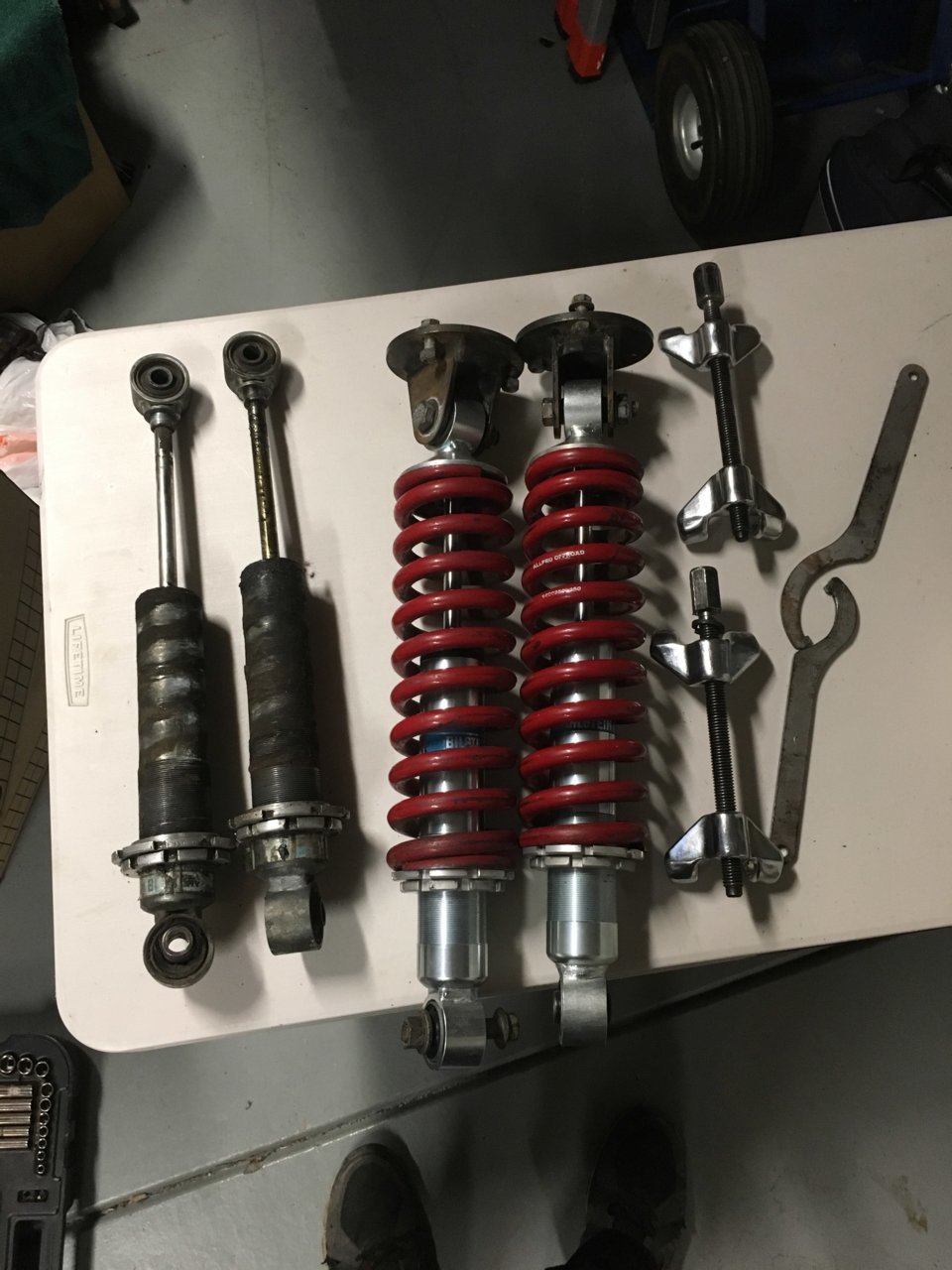

    "Rebuilt" some All Pro coilovers that I bought off CL. Excited to get these puppys on. :bananadance:IMG_3031.jpg

    Some questions.
    Has the truck had any front end accidents that could throw the alignment off?
    Do you have a diff drop installed? That will also throw off the alignment.
    I have a diff drop on mine so that cause my plate alignment to be off. However it was an easy fix. I used a carbide dermal bit, cost about $15-20 for just the bit, and made the holes in the plates a little bigger, back holes. I also used some washers and a SS spacer, from HD, for the back of the IFS skid. I have both my transmission and IFS skid installed on my Apex bumper. I would align and bolt the front first. Then you can make the holes in the back bigger, use spacer/washer if needed.
    How you tried contacting the TG in Fresno CA? I want to say that’s their main HQ. I been there a few times and every time they been helpful in finding a solution. I can see how not being local can be annoying dealing with big heavy parts.
    I can confirm the skid plate hardware were not exactly correct, they still work but the bolt style was wrong. They gave me new ones.
    They told me they are working on the ALLPRO products line and fixing them as it comes to their knowledge. They would pull batches/parts, recheck, and replace.
