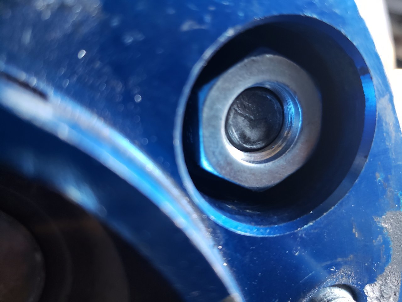

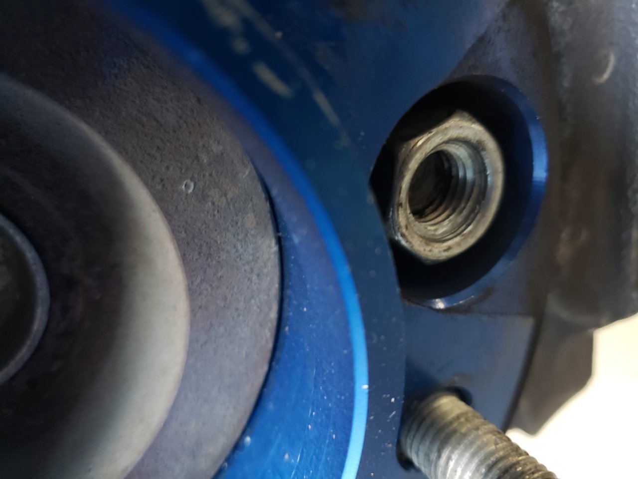

    Further progress on the 4x conversion...
    Spidertrax spacers will not fit manual hubs... I call bullshit, hold my beer and watch this.
    Made a jig so things didn't get completely fucked up.
    Test fit = good to go. (The part you have to make clearance for is the nuts holding the hub bodies on)
    I also drilled the mounting holes out from 1/2 diameter to 5/8... To allow for All Pro extended thread nuts.
    Honestly, I feel like they are 100% safer now, with the alterations, than they were before.
    Spidertrax lugs leave A LOT of thread unused on the front (seems like half the thread).
    The All Pro engage a lot more thread in the main part of the nut, plus you have the extended shank as well.
    mechanicjon and SwampYota like this.
