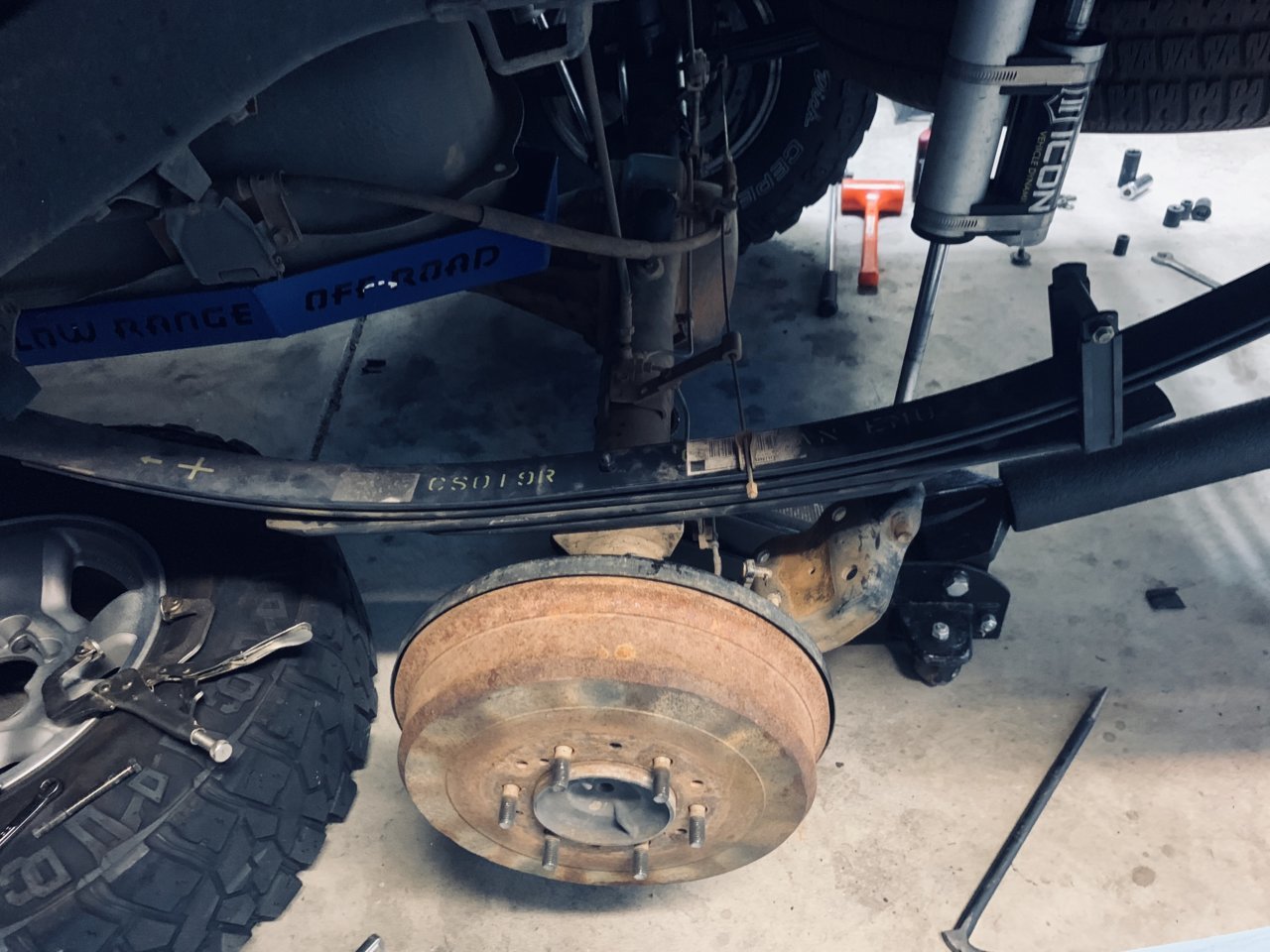

  1. Jan 27, 2019 at 8:54 PM
    eon_blue
    Mar 4, 2016
    #180213
    70,112
    Azusa, CA
    They look different than the regular Dakars to me but I can't be sure since I don't have them anymore...looks almost like maybe there's an extra overload leaf on them which is odd because the AAL doesn't go there. Anyway post up some pics when they're installed

  2. Jan 27, 2019 at 9:16 PM
    Squeaky Penguin
    Squeaky Penguin Nothing Ventured, Nothing Gained
    Apr 5, 2012
    #76340
    10,100
    Brett
    Steamboat Springs, Colorado
    '01 4WD, SR5, TRD & '13 TRDOR AC
    Lots of dust and custom dents, Check Build
    They look like the shorter 95-97 ones.

    Got the ext travel (mid travel) Fox’s off the 4R and I to the Taco.
    Also pulled the 3rd leaf and biggest overload leaf out of the Dakar pack. It’s the 97’ shorter style and I have a pretty light bed area-it ride like a Mack truck, now it’s like butta’ . If it settles out a bunch I can always and one or both back in.

    These are my Dakars, no AAL. I can see why @eon_blue was wondering since they do look different from mine. Missing a main leaf and an overload when compared to mine. Like he said, maybe they are the shorter ones?
