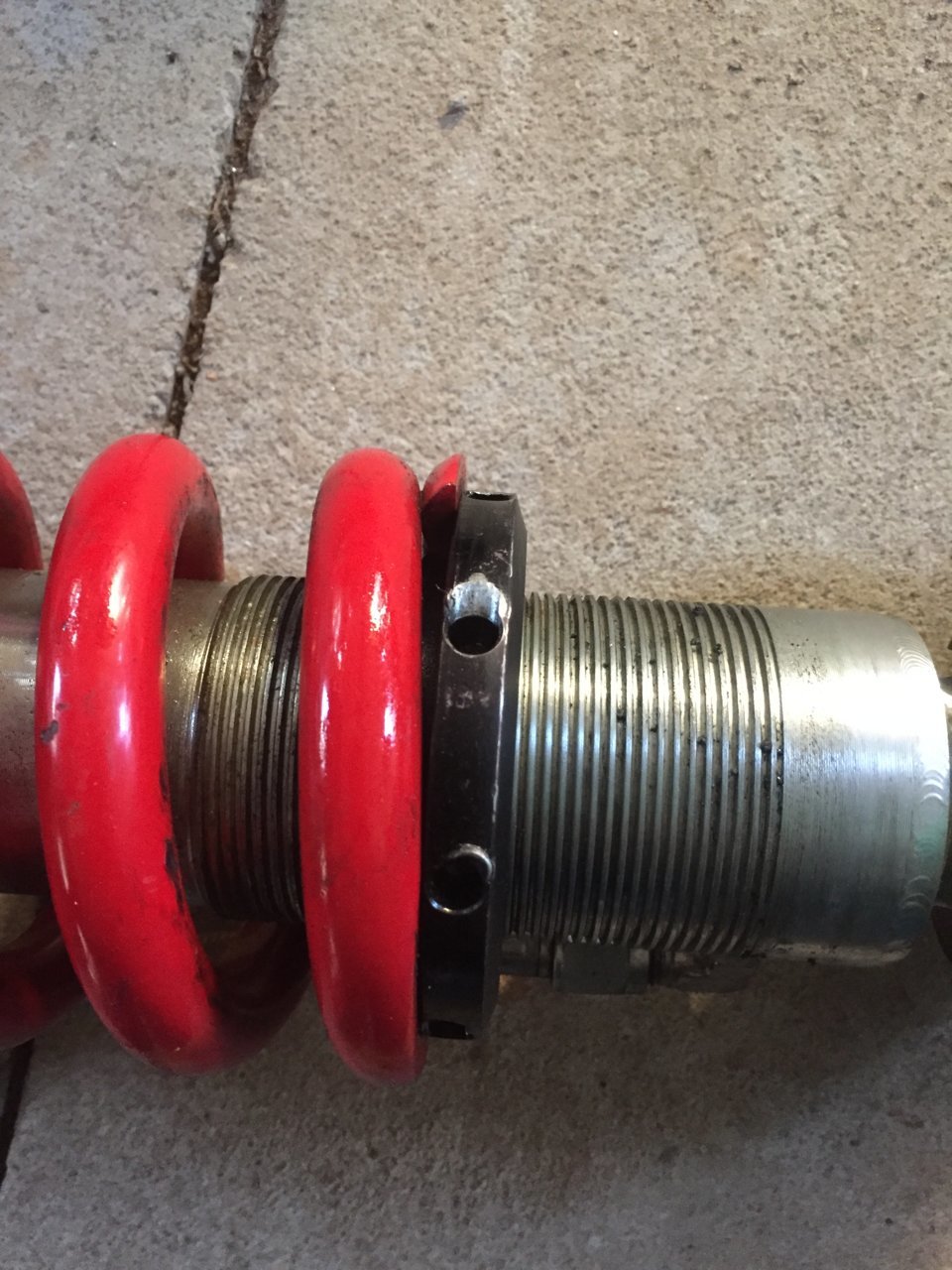

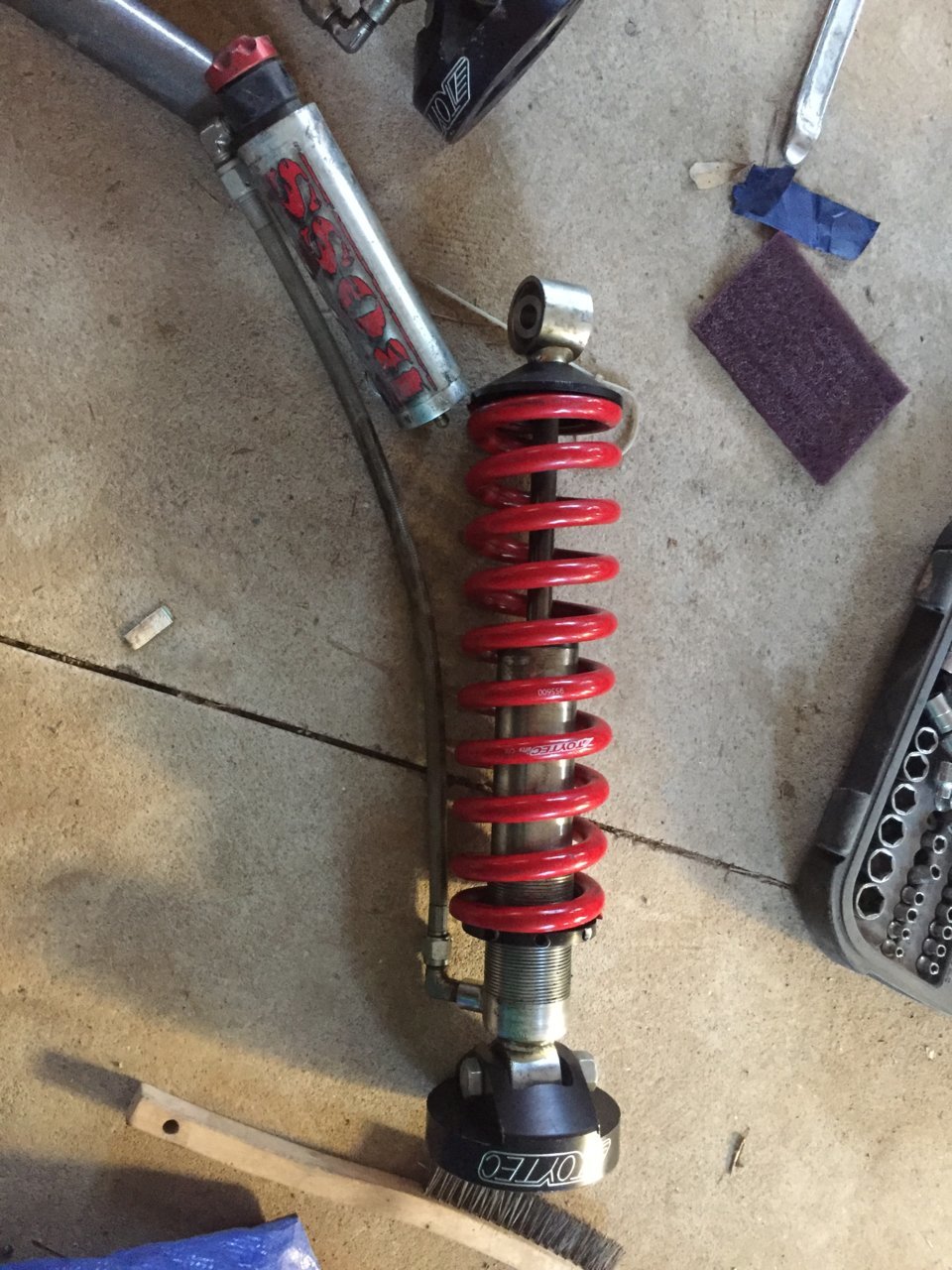

    So, I attempted to adjust my coils after putting my bumper on. I applied penetrating oil to the adjusting nut two days before attempting and I didn’t get a budge out of it. And yes, i did compress the spring to take the stress off the nut first but it was still seized up. Toytec wants 300$ for the new shock with a reservoir BUT I think it’s time for some Kings or Icons instead of these POS.

    Yeah that ain't right.
    Also don't over fill that part. You just need a bit to keep the slip yoke lubbed.

    I've never had been able to get a very good lube job onto the splines without separating the halves and lubing the splines as so. It's been this way for the cruisers drive shafts so it's not a surprise taco driveshaft follows suit

    Heat the ring.

    Thought about it but seems risky since it holds the coil pressure

    I used a heat gun on my buddies icons and it worked. It's not going to get hot enough for anything to fail.

    Ill give it a shot. Were they seized up pretty bad?

    They didn't appear to be. Bent the spanner wrench trying to move them before using heat. Once they started moving they became easier to turn. Eventually didn't even need a cheater pipe.
