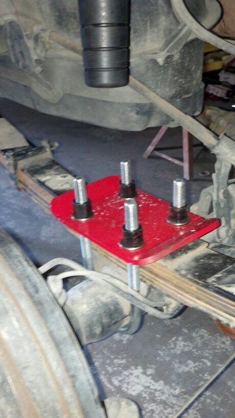

    Finally got these in the mail
    the rear set up should be in tomorrow!!!

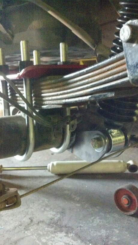

    yep, left them in pretty much stock locations. I'll be doing some different geometry on them in the future, but still working it out and needed the truck drivable quickly so thats why I stayed pretty much stock geometry. its gotta wait a little longer til I get crazy with it.... :spy:

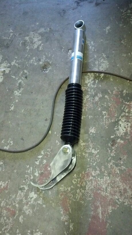

    Looks good :thumbsup: I did the same thing on my 4runner made my flip kit out of stock 73-87 Chevy ubolts and Plates. Utilized the stock upper shock locations but burned in the lower shock mounts.

    what is the advantage of doing the U-bolt flip?

    I like the shock mounts :thumbsup:

    tiny bit of ground clearance gain next to the wheel. Best part is relocating the shocks to any way you want.
    wish i was doing this now..

    I've been thinking about making my own u-bolt flip here pretty soon when I re-do my rear suspension.... Did you go 1/4" plate? 3/8"? And I see those little angle ups at the ends on almost every kit I see... is there a reason for doing that rather than just cutting it off at the bend?

    I think it has to do with when the leaf curls up

    hmmm... probably. But then shouldn't the bends be more rounded? :confused:

    :eek: Pics? lol
