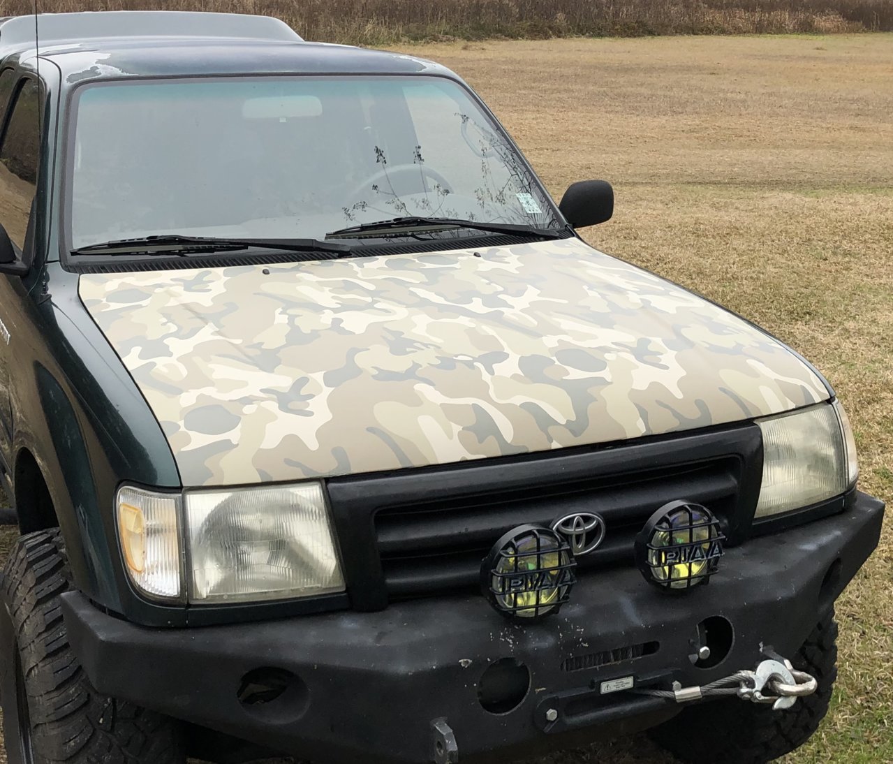

    The clearcoat on my hood has flaked away so I black Plasti Dipped it. That has dried up and flaked away after half a summer in the WTX heat. So for $22, less than the rattle can PDip, I’ve tried my hand at a vinyl wrap. It was too cold to do it outside so I did it in my kitchen. Overall it went well until I got down to the front of the hood. I wasn’t able to pull and stretch enough to get the wrinkles out on my countertop. Lesson learned there and I’ll do better if there’s a next time.
