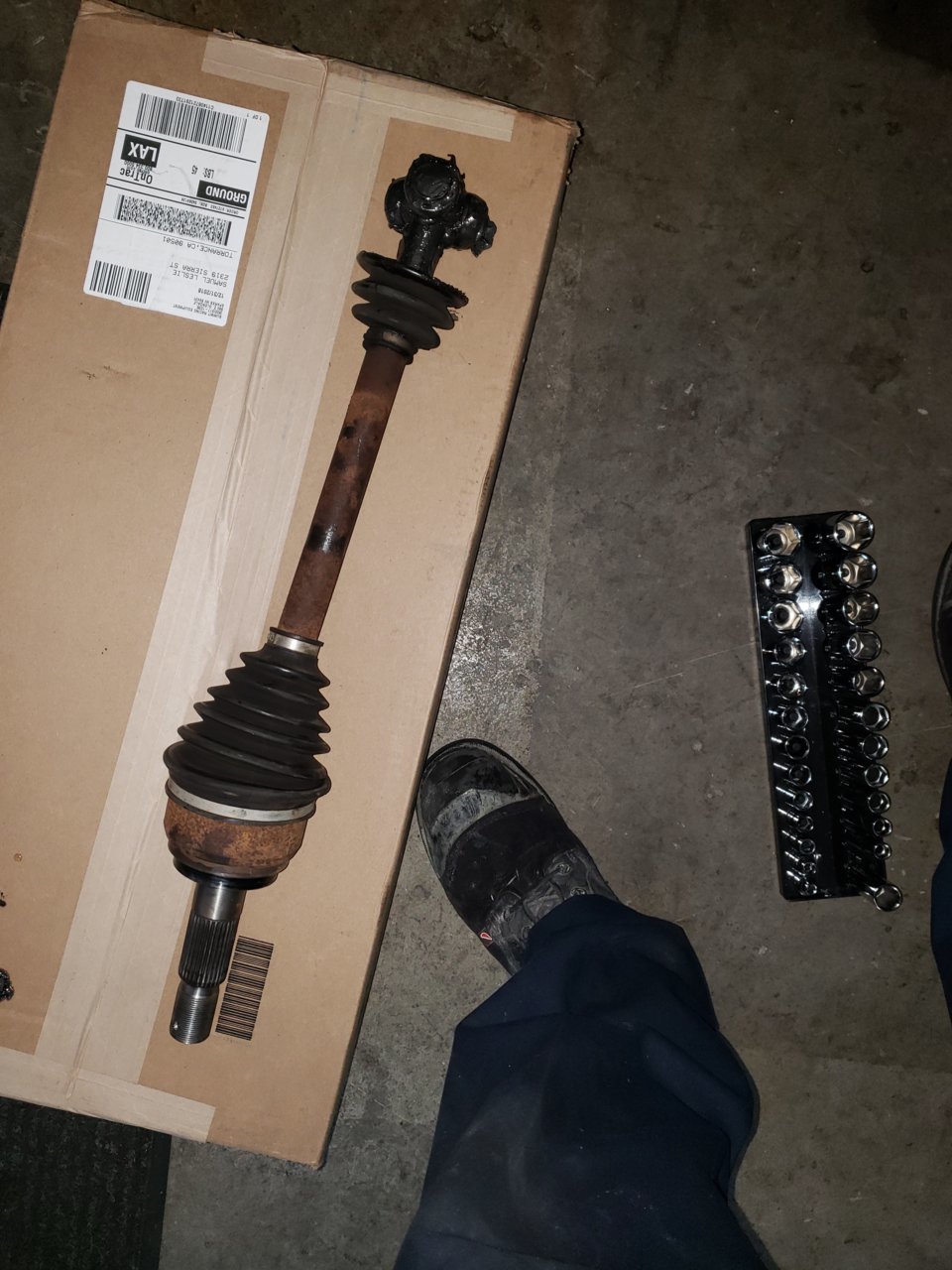

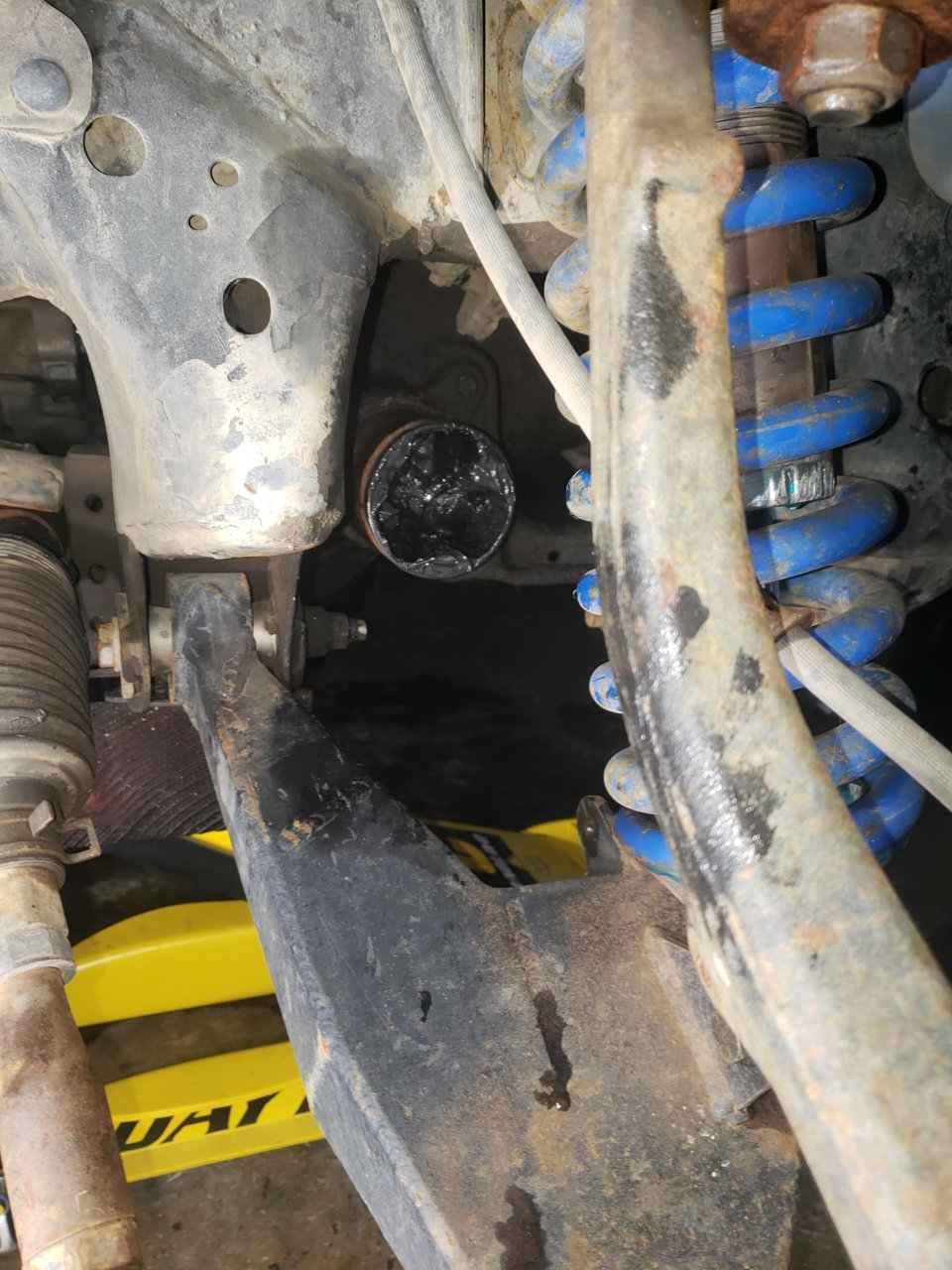

    Is that the CV Axle?
    Gotta yank it hard enough. There’s a snap ring in the differential holding it in.
    Can you pry the back of the CV away from the differential? That’s how I would do it.

    Ya it's the cv the damn thing doesnt want to yank out and I can get good leverage with my pry bar it's to long I think

    Theres room just cant get it to pop free

    If you keep yanking on the tube it’ll break the tube out of the “coupler” part of the CV.
    Ask me how I know. Haha.
    I found that the best way is to grab the shaft and the front splined part of the CV and pull forcefully, or just pry the back of the CV out to free the snap ring.
    I’d get a flat head screw driver and try and use that as a prybar.

    Looks like time to get a slide hammer on the job with that CV.

    The front half of the CV with the splines yanked out when I tried that15491393692257414806355100059126.jpg

    Yep that’s what happened when I removed CV’s from a junkyard 4Runner. Needed the differential thankfully, not the CV’s.
    Either use a slide hammer, or get something small enough to wedge in between the intermediate portion stuck in the differential to pop it out.
    I used a flat head screwdriver to do this.

    Does anyone have a line on the adapter needed to pull the iner CV cage with a slide hammer? I want to make sure I have it on hand
