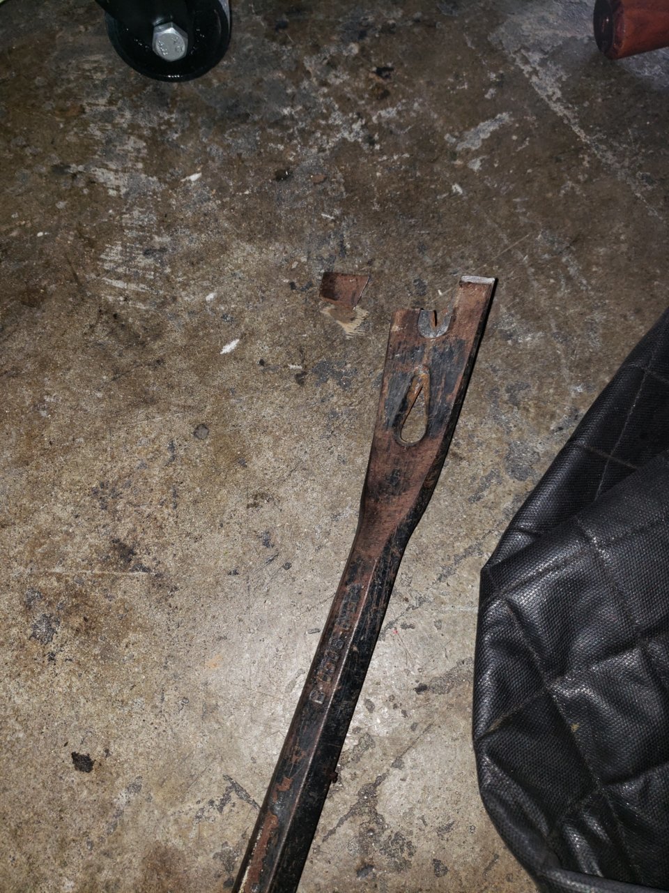

    I don't see how people struggle with that.
    Get a small pry bar. Like 1 foot or 18". Take the skid off. Get underneath it and you can clearly see where to out the pry bar. One good sharp pry and it'll pop out easily.

    15491434587828377160808881473268.jpg Ya that fucker doesnt want to budge. Buddies bringing a slide hammer over

    It helps if the opening of the snap ring on the end of the cv is down, turn the cv about a quarter turn and try prying again, keep doing that till you find the magic spot. Same goes for reassembly.

    I think sharp is the key word. Just prying puts it in a bind. I use a 12" breaker bar and give it a kick. 60% of the time works everytime.

    Yeah. Fast and hard and it'll pop out.
