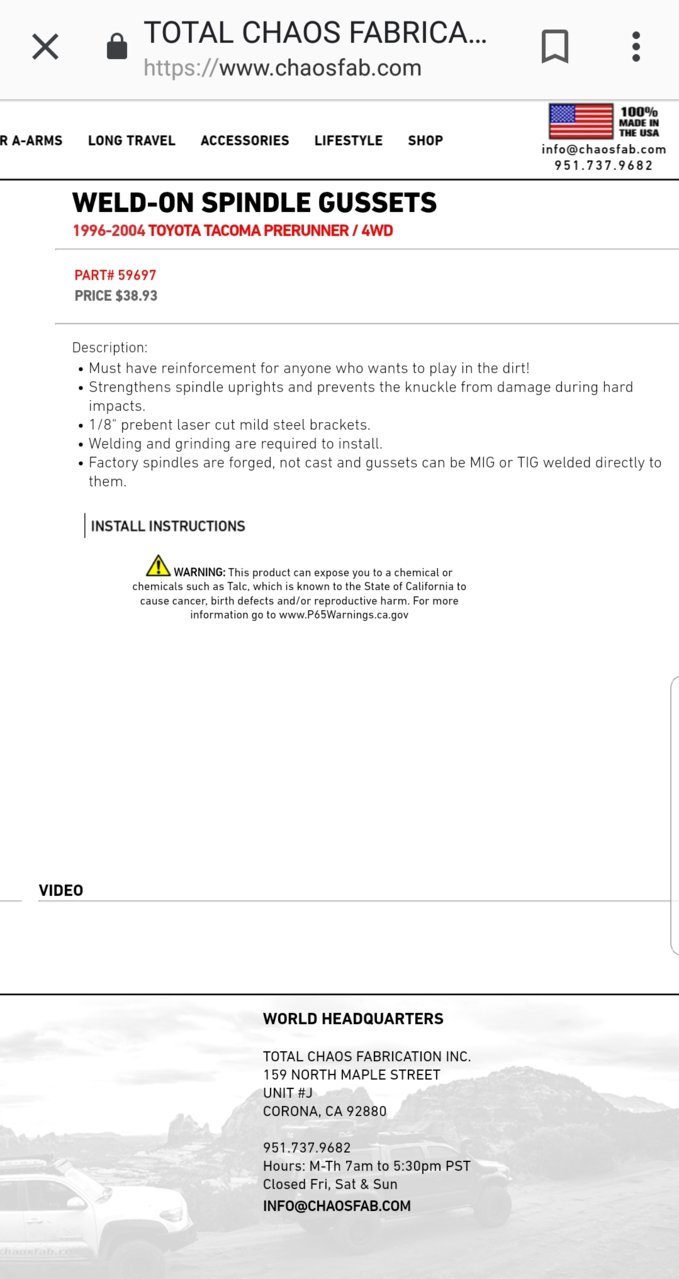

    Total Chaos says they are forged.

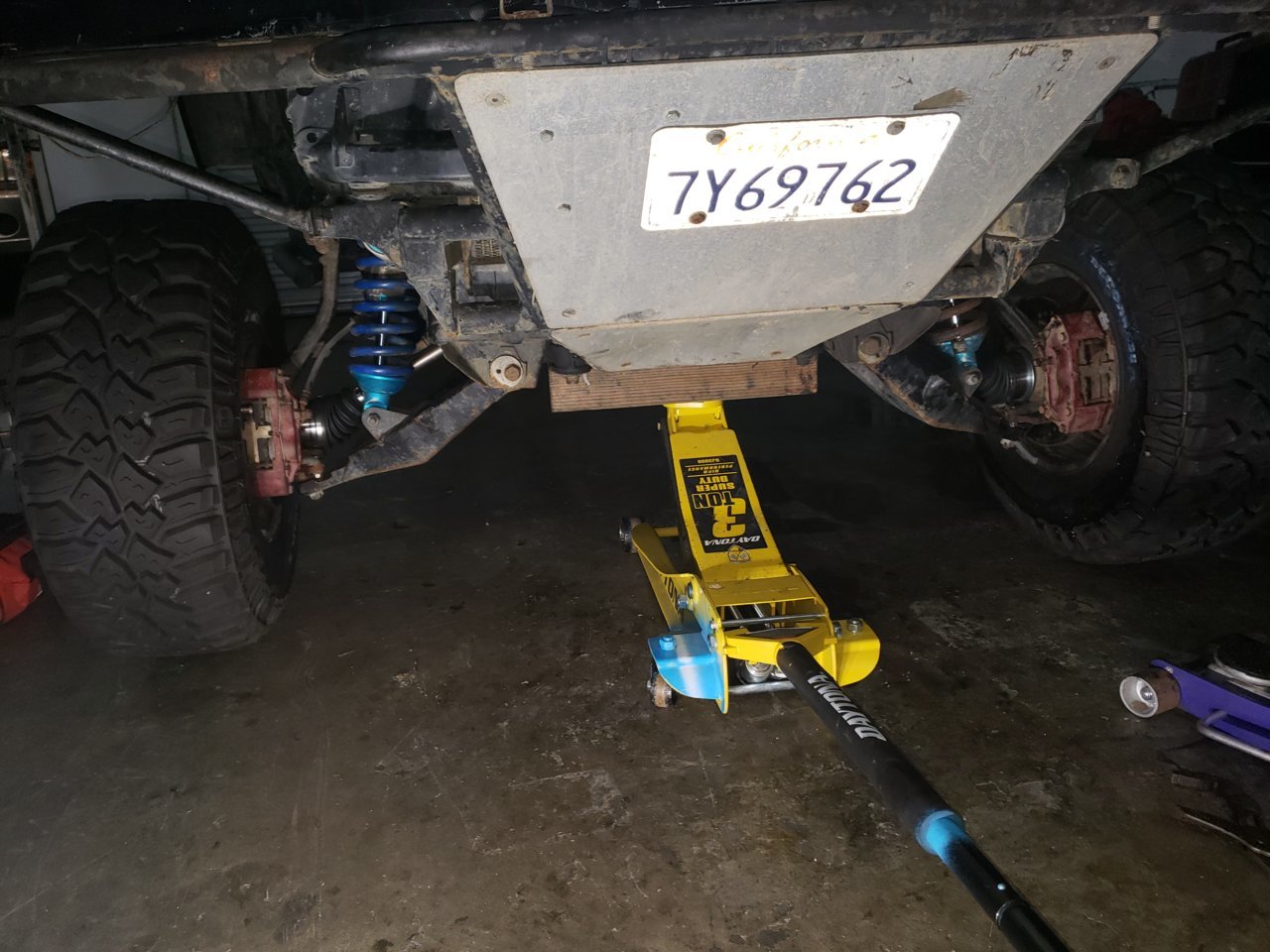

    20190202_213554.jpg 20190202_212213.jpg Back on her own feet. Also changed the preload from 2in of threads showing to 1in time to definatly strap and bump the truck

    Put the long travel kit on it have wheeled 5 or 6 trips and havent gotten around to it. But after looking at my cvs I see I need to
