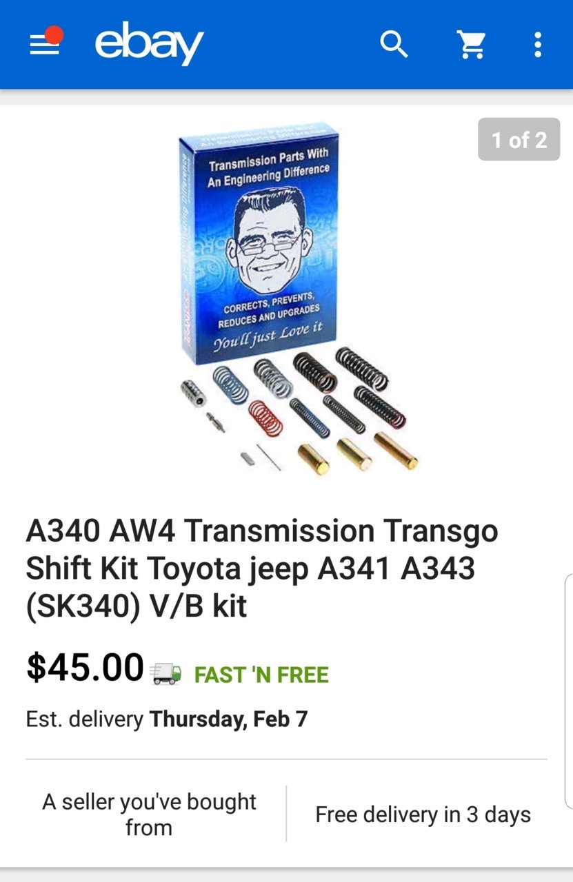

    Great price.
    I saw that "experienced technician" remark. Probably just trying to head off too many calls to them asking questions when less knowledgeable people try to install their stuff. I am sure you can handle it.

    Don't lose track of the position of the check balls! Get a diagram, make a diagram, take pictures, use dabs of grease. Whatever you have to do to get it right, sucks big time if you misplace any of them

    Good advice... I already almost lost one of the little ball detents when I was working on the manual hub dials. Fortunately I found it.

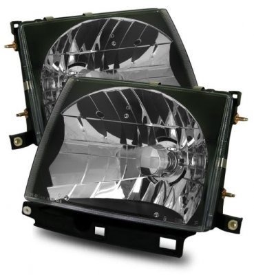

    Anyone have an black anzo headlight lights laying around?

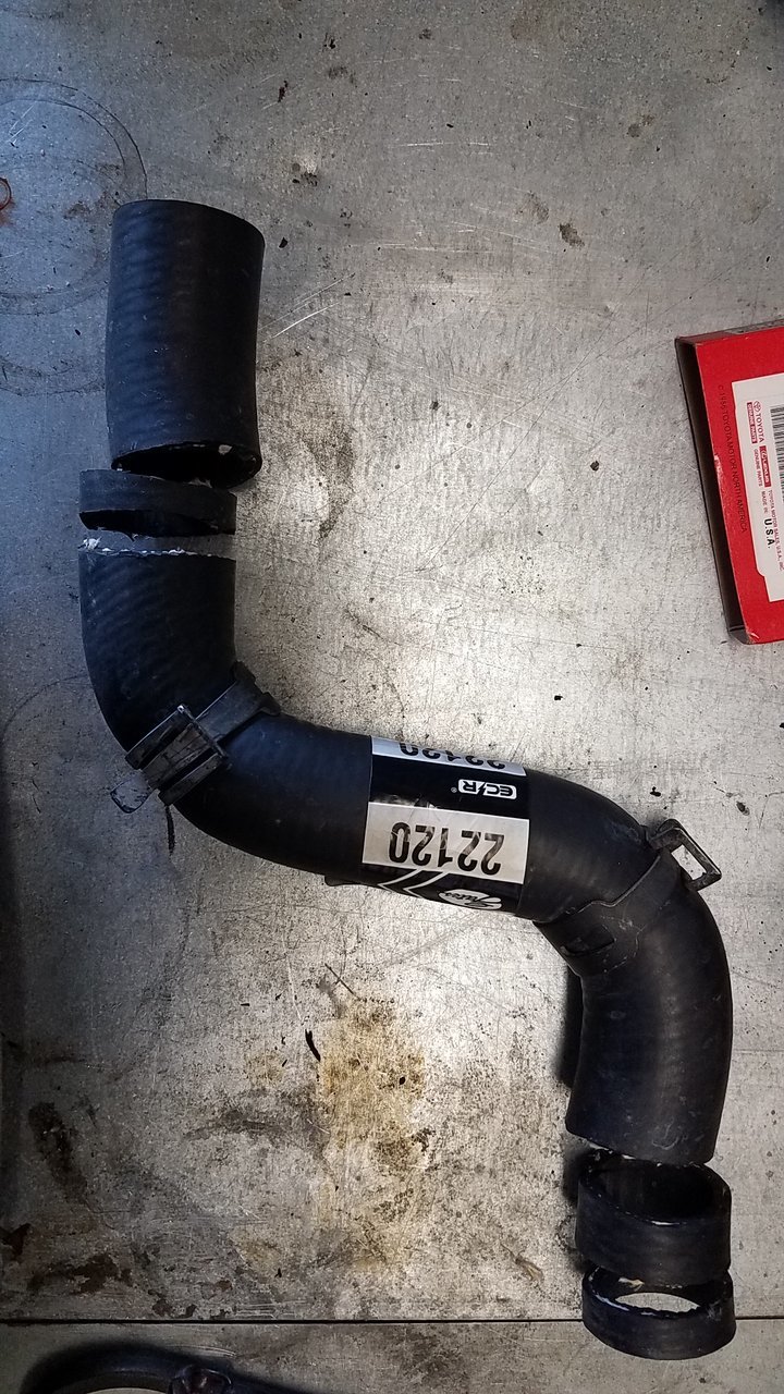

    You also need to use a different lower radiator hose and trim it.
    Here's part number and an idea of what you have to cut. You can get the hose at O'Reilly's. I think the hose is for a Dodge Neon.
