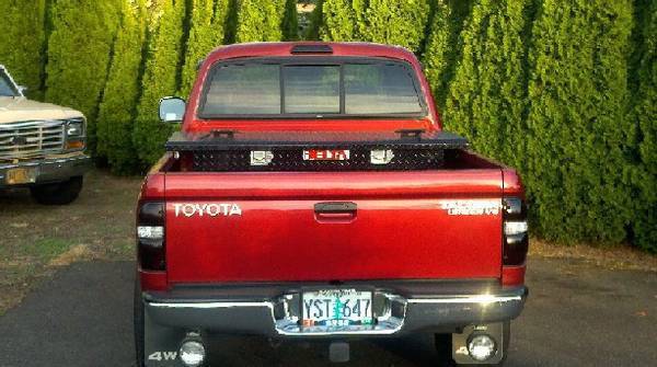

    Nice, dood! Looks awesome and super clean! Nice work! And I really need to do the rear back-up lights, too, as I'm so high up that my reverse lights barely do squat!!! ha ha

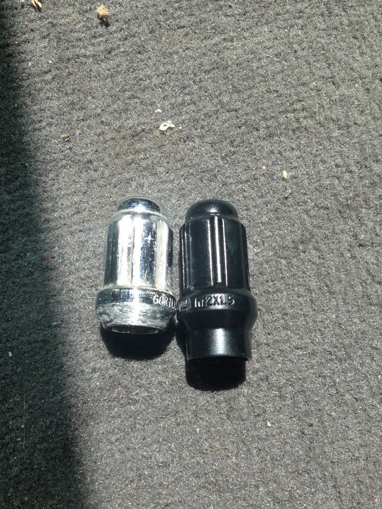

    Tired of my lug nuts only grabbing 2-3 threads fully and being a safety concern I looked into longer wheel studs as a solution.
    After finding a few options for longer wheel studs, The amount of work required to swap them was a little more then I wanted to bother with so...
    I found a new easier and just as effective solution.
    Longer lug nuts, They are the same spline pattern and just add a little extra lip for screwing onto more of the available wheel stud.
    They come in chrome or black chrome, Clearly I chose the black.
    Ordered 24 total for a full set. as well as another spline drive adapter just in case I leave one at Speed Freaks again..HAHAHA
    Highly Recommended for anyone running aftermarket aluminum rims with a thicker lip are where the lug nuts go.
    Took about 3-4 days from order to delivered.
    I ordered these from Wheelersoffroad.com photo1-52_1b23959378f8be01ae4a5ea611ff6853dedc420c.jpg

    X2!!!!
    Even wheel spacers, I'm running allpros extended thread lug nuts. Well worth it.

    While on the wheel subject. You said aluminum wheels have a thicker lip.
    Would American Racing Baja wheels need those special lugs? I wouldn't think so but the guys at discount tire mounted them with there own spline lugs, so I don't know how much thread they are holding on to.
