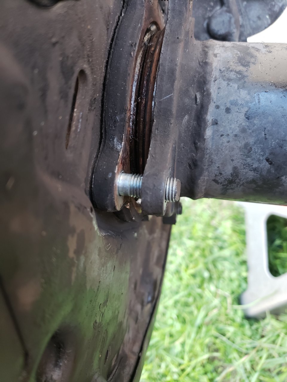

    Tried again today strapped it to a tree so I can get more tug out of it. And its stuck at this point I'm guessing the used rear I bought is bent. Its definatly something on the inside I got the backing plate to separate from the axle.

    Looks pretty corroded. Was it always sealed with oil in it?

    Yes it was sealed with oil in it the oil looked brand new when I drained it. It's been sitting on the side of my house for a year

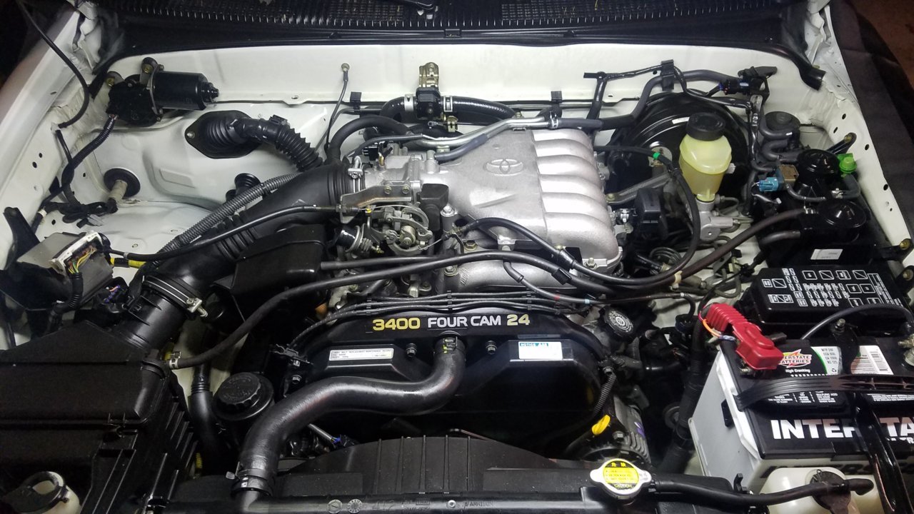

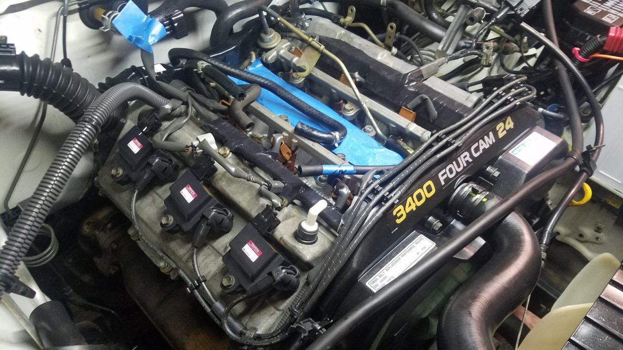

    Got the half moons and cam plugs sealed. Valve covers installed. Coils cleaned. New plugs/wires. New PCV.
    Everything is buttoned up...
    Also got a Budbuilt skid set ordered up today as well. Timing belt and water pump are on the docket for next weekend.

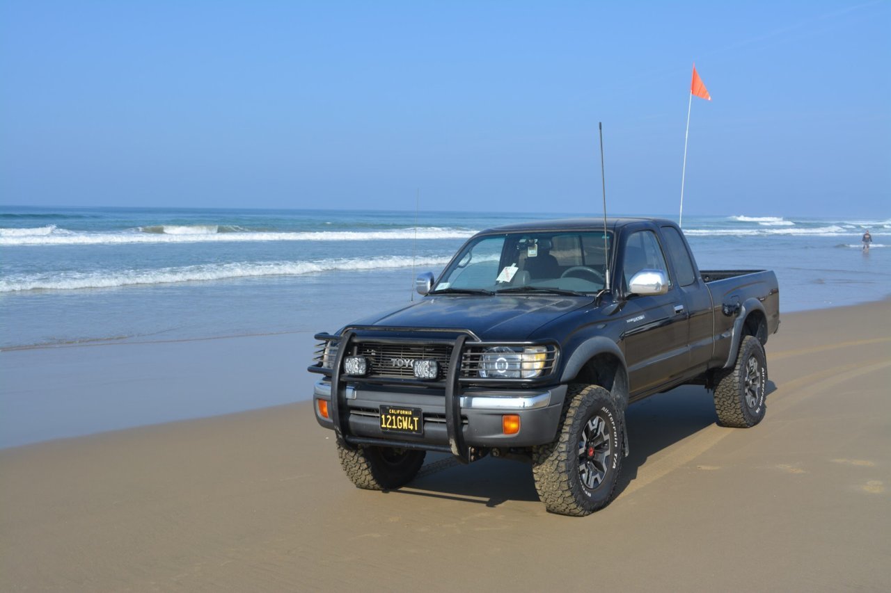

    I have about a 2.25" inch lift in the front, about as high as I can go without tearing CV boots (learned the hard way a few times). But a lift only does so much, to clear bigger tires properly you need the right wheels and a hammer/angle grinder for trimming and bending.
