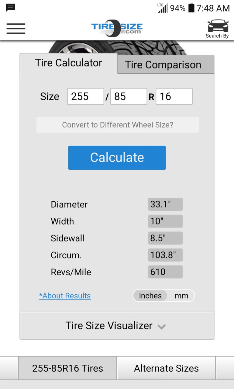

    That's wierd, it gave me different results. I must have fatfingered it

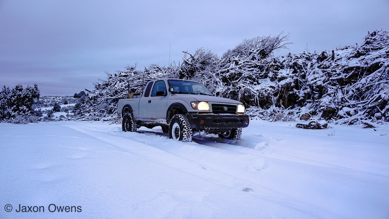

    Some people think the tall skinny’s look weird but I also think most people that end up with them, like them.
    I think a temp spacer would be way easier than a body lift, even more so if you plan on ditching whatever you go with after you sas

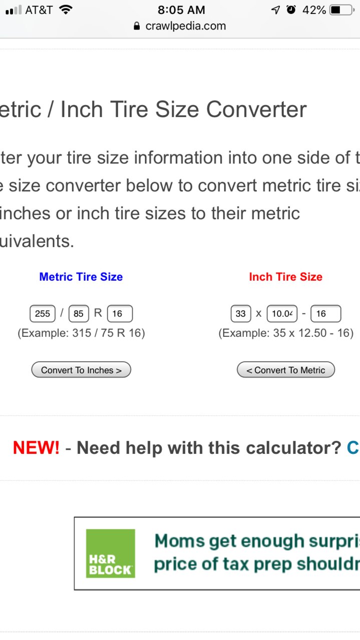

    255/85r16 is a true 33 in tire
    285/75r16 is a popular "33" but is really a 32.8" tire, but close enough to 33
