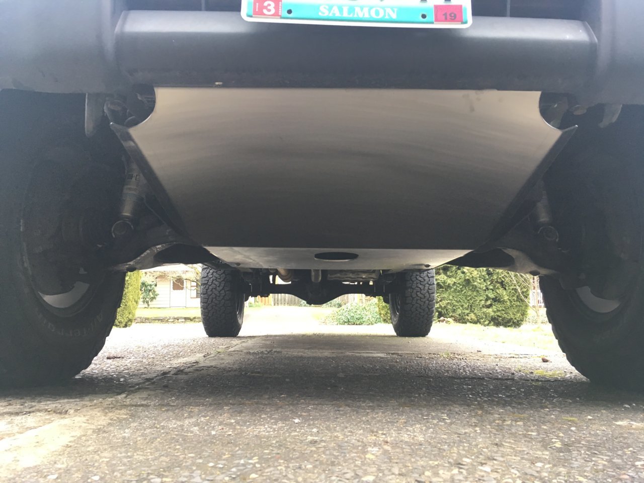

    Finally got my skid plate put on! It took tracking down a new front cross member, removing a forgotten broken bolt, and some other little tweaks. :bananadance:

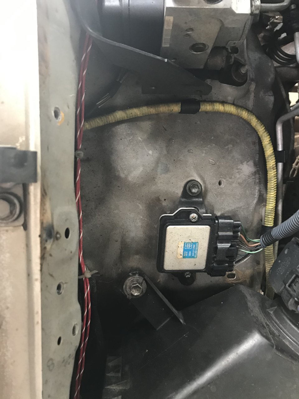

    Finished the install of my winch/bumper. Found a good location in the engine bay for the controller, but this necessitated lengthening all of the cables.

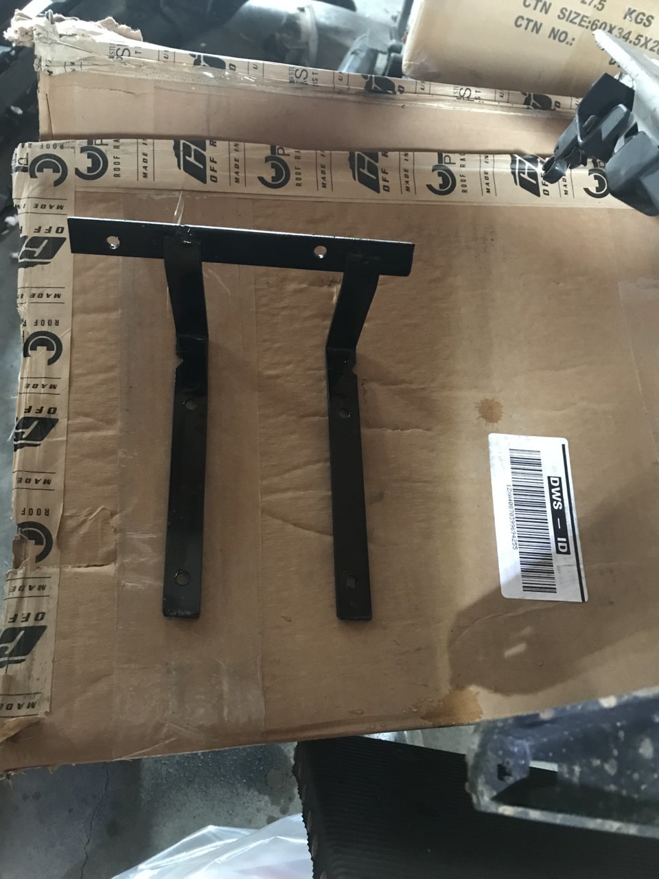

    Made up this little bracket that bolted to a couple of existing nuts.IMG_0366.jpg

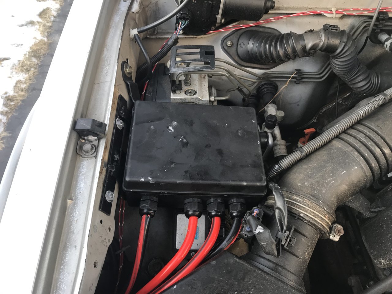

    and voila
    I used a set of heavy duty jumper cables to get the
    #2 gauge
    wire.

    Welding cable is my go-to for mobile heavy-current systems.
